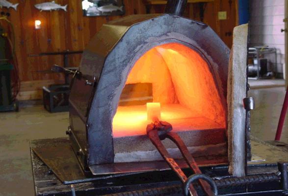

I'm in the planning stages of my next gas forge and have decided to go with the doghouse style because I have the material on hand.  I found a design that i like, but there seems to be a disconnect in my brain and the arithmetic isn't working.  Seems like there's some fancy trigonometry or such going on, or maybe I'm just not seeing what I should be seeing.
I really like the ridge lines on the shell and would like to duplicate that look, but for the life of me I can't figure out how to lay it out.  Assume that the inside chamber measures 9x11.  You then have what appears to be 2" of insulation.  That puts the outside walls at 13" apart at the base and 15" tall.
But, how does that translate into a the length needed to form a faceted parabola like in the picture?  Thoughts?

Simple way is to just draw what you want full scale on paper, then measure the facets and add them up. The small loss due to bending won't make enough of a difference to matter much, but if you feel it's critical, add some extra to the total and cut once you have all the bends done.
measurements don't have to be exact   treat it like two concentric half circles and calculate the thickness and length of the arc.    If you really want to be picky break each segment into trapezoids  draw out on graph paper and measure with scale ruler or draw full size on paper and measure.
Just get a piece of string and lay the shape out and measure the string.
The actual math to calculate the exact circumference of an ellipse is fairly complicated, there are simpler equation that will be within 5%. Just do a google search for the formulas if you need it that precise. It works out to be 37.24 using the simpler equation.
Or take a strip of cardboard and using a blunt edge tool (we used to use a washer welded to a piece of pipe for a handle), score the facets and bend the cardboard as you want the steel to be bent. then flatten it out and measure. Sometimes getting fancy isn't worth the effort...(I used to build very odd custom boxes when I worked in a small custom wood shop...)
Does it have to be a parabola? A straight sided box with a semicircular vault is EASY to calculate. Seriously, box LxWxH + 1/2 pi.r.sq x L. Or if you have an example of the thing trace it on graph paper and add the little squares and triangles.

Make a full size drawing on paper. You actually only need to make 1/2 of the drawing on a folded piece of paper, then unfold the paper.
Transfer the drawing to cardboard strips, and use the cardboard strips as ribs like found on a ship. This will allow you to have a full size model to see if you like the design, ir has room, etc etc

you are half an ellipse (basically). long axis is 30" (your 15" height) You short axis is 13" (your width.). Thanks calcs to 72.63" for an ellipse. Take half and you get  36.31".
8 segmants of 4.5"
http://www.mathopenref.com/constellipse1.html
Half of this should get you to outline to fits the facets into.
