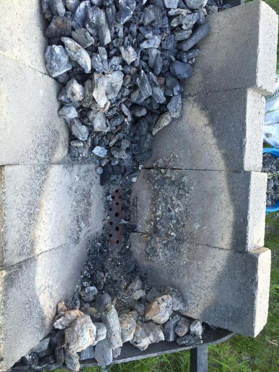

Bayshore Forge Posted June 2, 2017 Share Posted June 2, 2017 Update: I have been using TSC nut coal for basically two years now. The only other coal I've ever used is sourced from my local marina, randomly found along the rocks - no clue what type it is, but it smells different when burnt and behaves different from the anthracite from TSC. I have gone through over 20 bags of the nut coal, two different brands. One is pictured earlier in the thread, and the other is in a sealed plastic bag and called something like "miner's choice" or "Miner's Nut" (can't remember). I have found that using my forge set up the coal likes a kindling fire and the hair dryer on high to start, and then the hair dryer on low to sustain for hours. In a pinch of low coal I have been successful with turning the hairdryer off right before I pull the bar out, then back on right after I put it back in for another heart. I believe this uses a bit less coal, but I'll admit I usually leave the blower on low constantly. With a mature fire and the dryer on low, I have been forge welding up to half inch mild stock. I have never tried to forge weld anything thicker than 1/2, but I believe I probably could. My brother successfully melted/burnt a rail road spike by failing to pay attention. Coal is not easily available in my experience in Northern Michigan, so TSC anthracite has been my go to. Brent Link to comment Share on other sites More sharing options...
WNC Goater Posted June 2, 2017 Share Posted June 2, 2017 That looks a whole lot like what I've rigged together for charcoal using firebrick and 1/2 an old air tank. Link to comment Share on other sites More sharing options...
