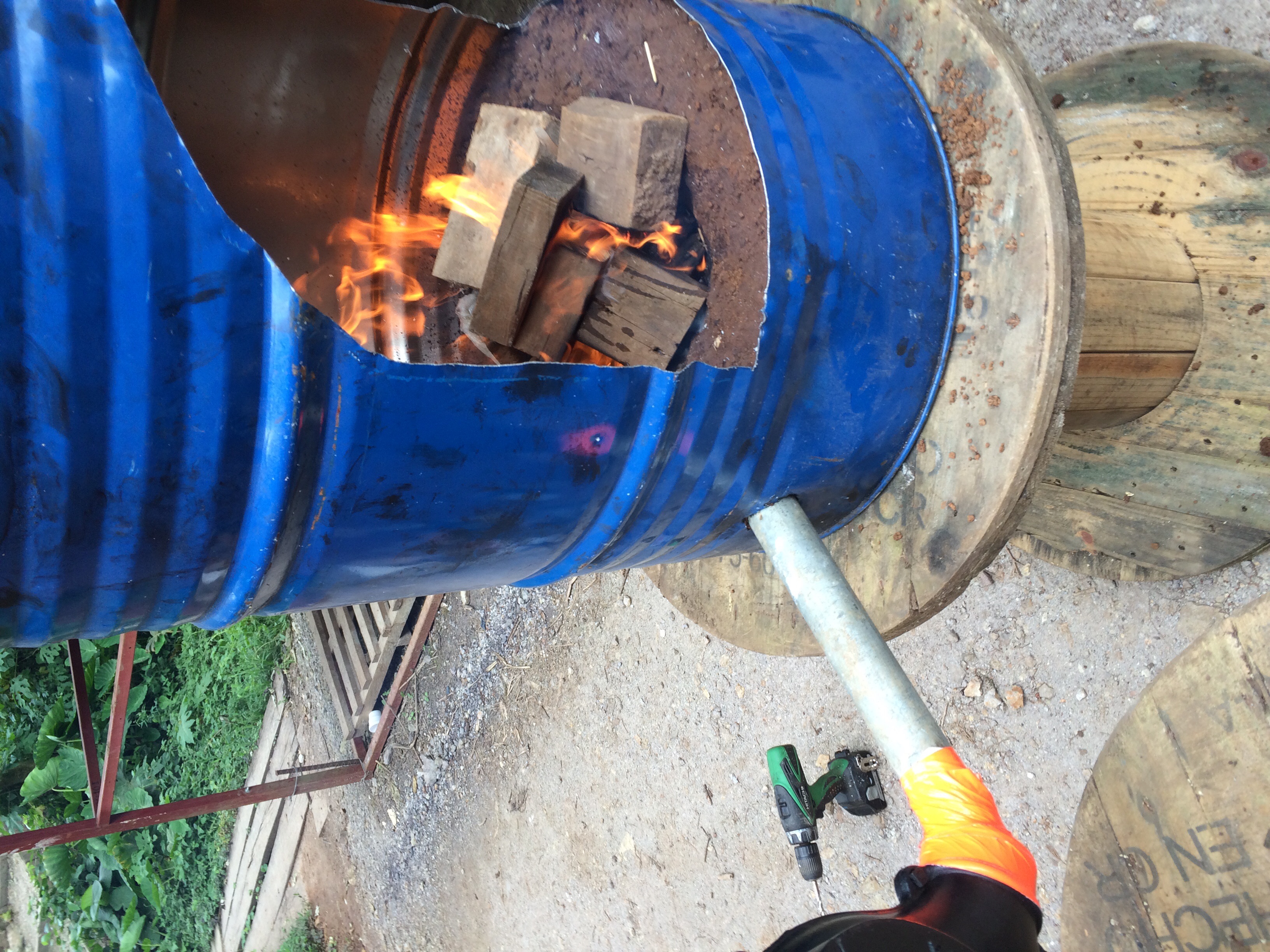

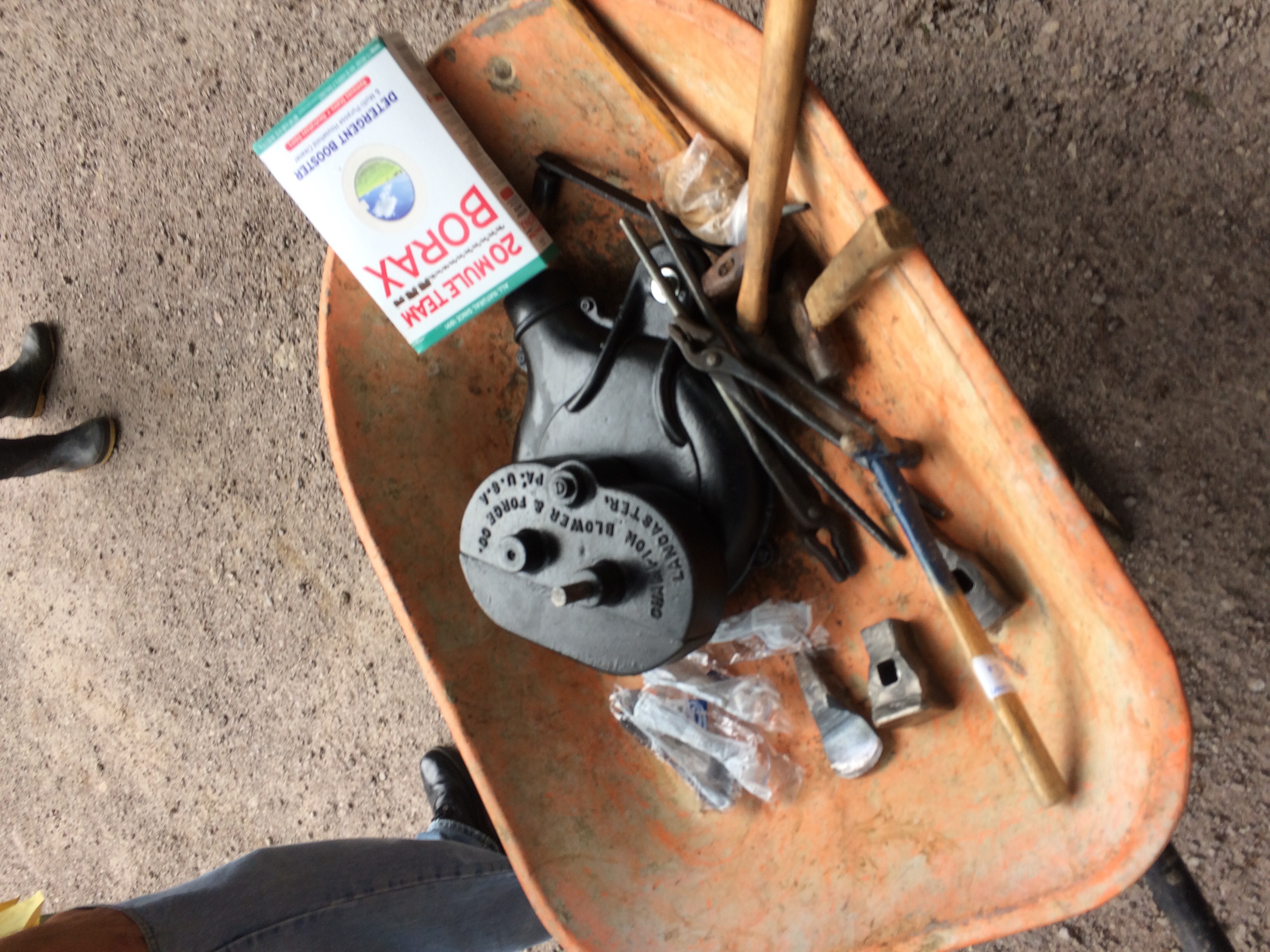

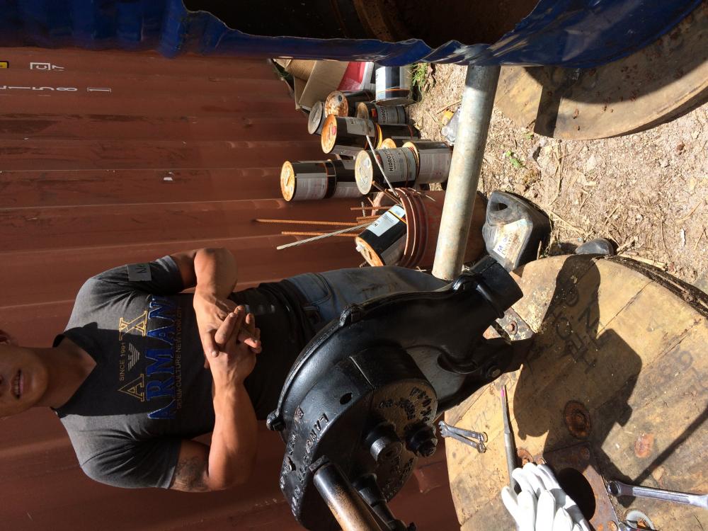

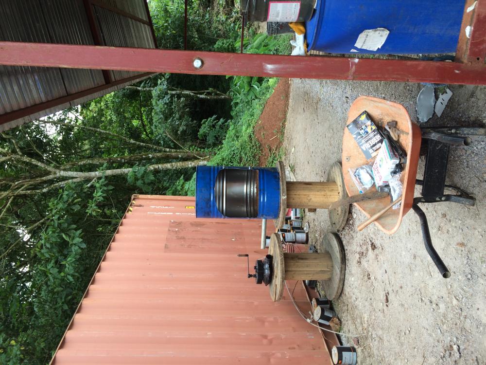

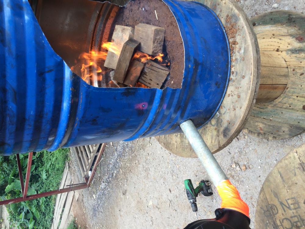

image.thumb.jpg.e121837e3606cd0093915d78image.thumb.jpg.50468002c4b3db1c255aae48image.thumb.jpg.699707eec6155dcb851aca1dI Made it down and things are going good!
shop is real close to set up and we have our first job in the morning. image.thumb.jpg.40abf86e22d6c0e20f67f2f8Noe I have a heat treat question to throw at yall.
