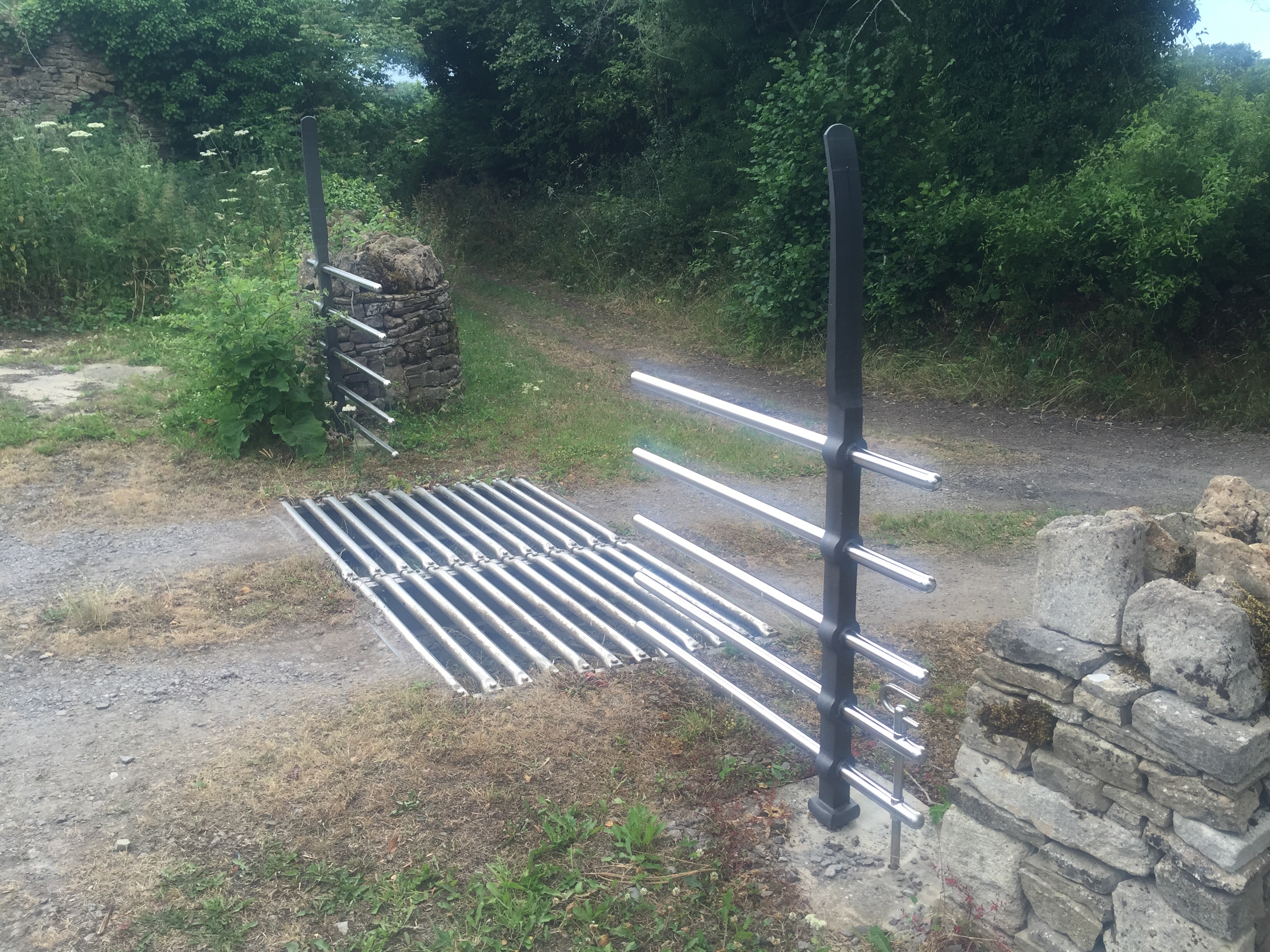

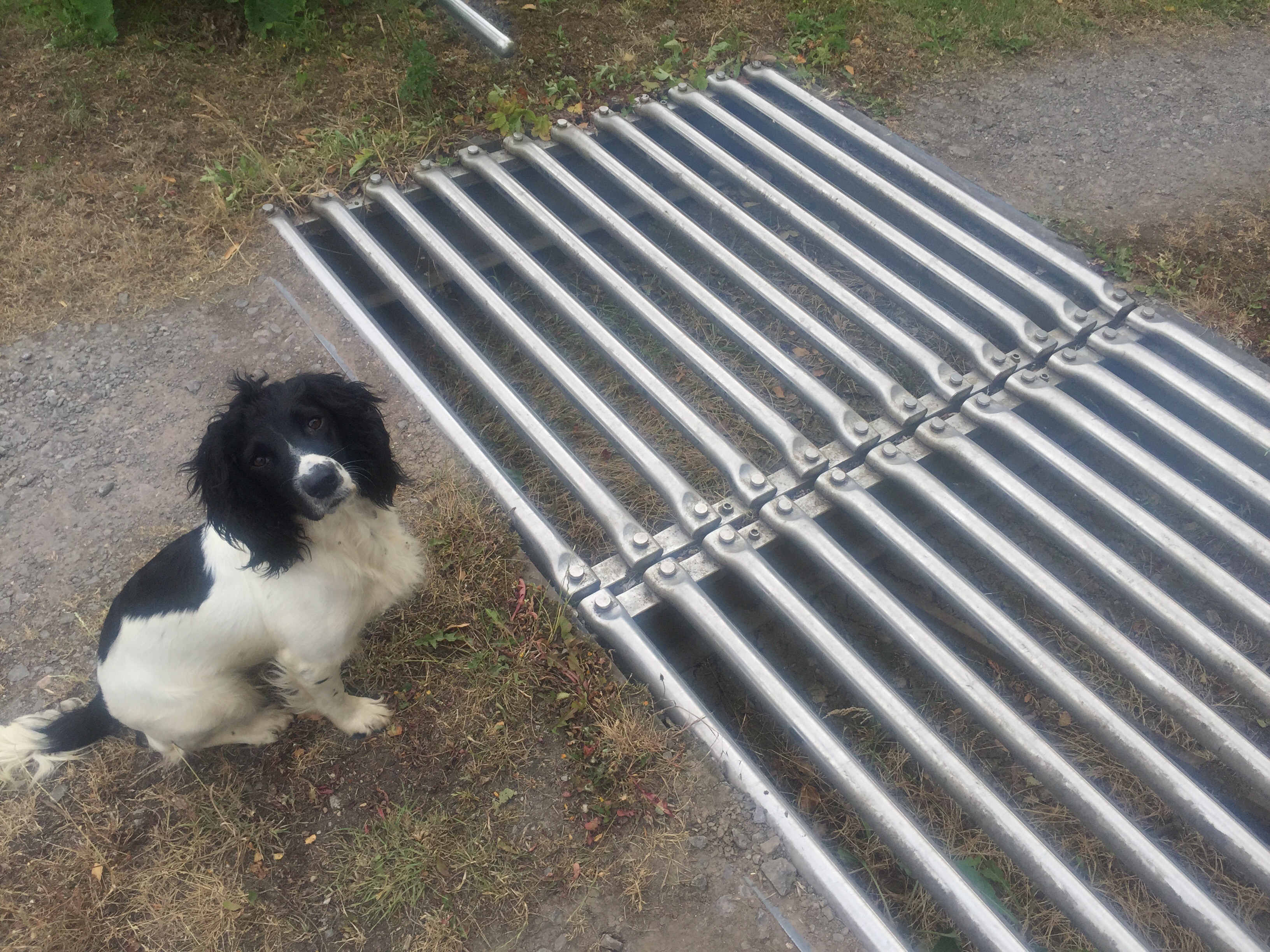

Alan Evans Posted July 10, 2015 Share Posted July 10, 2015 Of course you could always do what I did with the off-cuts from a 316ss project. Entrance gates and cattle grid at home. When my farmer neighbour saw it first, he said it ought to be on the front cover of Cattle Grid Monthly!Alan Quote Link to comment Share on other sites More sharing options...
odblacksmith Posted July 10, 2015 Author Share Posted July 10, 2015 Needs to be on the cover of something that's for sure,very nice work. Quote Link to comment Share on other sites More sharing options...
Frosty Posted July 10, 2015 Share Posted July 10, 2015 Oh yeah, that's a cover art cattle crossing and gate. Beautiful use of excess material far better destiny than the scrapper.I like the dog's expression like s/he's asking you if you think that's going to slow him/er down. Silly human. Frosty The Lucky. Quote Link to comment Share on other sites More sharing options...
Alan Evans Posted July 10, 2015 Share Posted July 10, 2015 One step across for her.The old smart one used to walk across with no problem until one day in the snow she lost one leg down the gap…would never go across again, there is a belly rubbed hollow under the bottom gate rail now!Alan Quote Link to comment Share on other sites More sharing options...
Frosty Posted July 11, 2015 Share Posted July 11, 2015 One step across for her.The old smart one used to walk across with no problem until one day in the snow she lost one leg down the gap…would never go across again, there is a belly rubbed hollow under the bottom gate rail now!AlanAyup, that's how they work. Frosty The Lucky. Quote Link to comment Share on other sites More sharing options...
teenylittlemetalguy Posted July 11, 2015 Share Posted July 11, 2015 Alan, best cattle guard ever! Quote Link to comment Share on other sites More sharing options...
Charles R. Stevens Posted July 11, 2015 Share Posted July 11, 2015 Leave it to a smith to make a cattle guard beutiful! Quote Link to comment Share on other sites More sharing options...
Alan Evans Posted July 11, 2015 Share Posted July 11, 2015 Well considering it replaced a bit of baler twine we strung across the opening every time the cattle were being brought by, it was a slight over reaction!Alan Quote Link to comment Share on other sites More sharing options...
Frosty Posted July 12, 2015 Share Posted July 12, 2015 Over reaction? What, the cattle don't come by anymore? Wasn't that idea or am I missing something?Frosty The Lucky. Quote Link to comment Share on other sites More sharing options...
Alan Evans Posted July 12, 2015 Share Posted July 12, 2015 (edited) 20K worth of work to replace 20 pennies worth of string! Alan Edited July 12, 2015 by Alan Evans Quote Link to comment Share on other sites More sharing options...
ianinsa Posted July 12, 2015 Share Posted July 12, 2015 20K worth of work to replace 20 pennies worth of string! AlanBut the string wasn't as pretty as this(and it looks better than in the picture) besides this will last longer! Luckily you are a bit off the beaten track otherwise I recon someone would have tried to nick it by now. Quote Link to comment Share on other sites More sharing options...
BIGGUNDOCTOR Posted July 12, 2015 Share Posted July 12, 2015 But string won't make the cover of Cattle Guard Monthly. Ya'know , there are probably some wealthy ranchers who would take a fancy to fancy cattle guards for their bovine sanctuaries. Quote Link to comment Share on other sites More sharing options...
Frosty Posted July 13, 2015 Share Posted July 13, 2015 (edited) 20k worth of work? I thought it was salvages stock on your own place. That makes it free doesn't it? Frosty The Lucky. Edited July 13, 2015 by Frosty Quote Link to comment Share on other sites More sharing options...
ThomasPowers Posted July 13, 2015 Share Posted July 13, 2015 (edited) It's missing the little box of your business cards! I'd expect to see a "by appointment" notice in the future!I was once given part of a cattle guard by a smith it was 6' long pieces of railroad rail Edited July 13, 2015 by ThomasPowers Quote Link to comment Share on other sites More sharing options...

Alan Evans Posted July 13, 2015 Share Posted July 13, 2015 20k worth of work? I thought it was salvages stock on your own place. That makes it free doesn't it? Frosty The Lucky.Materials yes free-ish….if you ignore what I could have got for them for scrap...The other little details:- design, groundwork survey, drainage design, excavating, multi block shuttering, truckload of concrete, cutting RSJ base frame, welding RSJ base frame, shipping RSJ base frame, galvanising of RSJ base frame, painting of RSJ base frame, M24 Stainless resin anchors for base frame, propane and electricity for forging stainless end rail flats from Ø50mm (Ø2") to 50x30mm (2"x1 1/4"), propane and electricity for forging end squashes, propane and electricity for forging rivets from Ø20mm (3/4") stainless, electricity for drilling rivet holes, propane and electricity to forge flags on 65mm (2 1/2") square, propane and electricity to punch holes in 65mm (2 1/2") square, propane and electricity to forge rain caps, electricity to machine bearing spindles, journals and rain caps, tools to form gate rail end caps, forming and welding gate rail end caps, shipping gate rails and grids, electro-polishing of gate rails and grids, welding gate rails, masking gate rails with rubber strip, shipping gates, shot blast and zinc spray gate posts, painting gate posts, installation, backfill with filter, manufacture and installation of hedgehog and toad ramps….I paid for.And on top of the metalworking costs my assistant insisted I give him some money to feed and house his family…I ask you! Any normal person would think the privilege of working on such a project would be sufficient reward!True, there may also have been a slight exaggeration of a fiscal nature in the interests of alliteration, 20 pence of string to 20k gates jumped to mind a few years later when I watched (with only mild trepidation) a 20 tonne truck driving over it delivering a load of scalpings.Alan Quote Link to comment Share on other sites More sharing options...
Alan Evans Posted July 13, 2015 Share Posted July 13, 2015 It's missing the little box of your business cards! I'd expect to see a "by appointment" notice in the future!I was once given part of a cattle guard by a smith it was 6' long pieces of railroad railThomas, I always thought of the project in terms of business cards/ advertising/ exhibition. Just to show potential clients what type of work I do/ can do in context when they visited. Even your railroad rail is going to be worth more the 20 pence worth of string…around £30 per metre over here for the lighter sections...Alan Quote Link to comment Share on other sites More sharing options...
