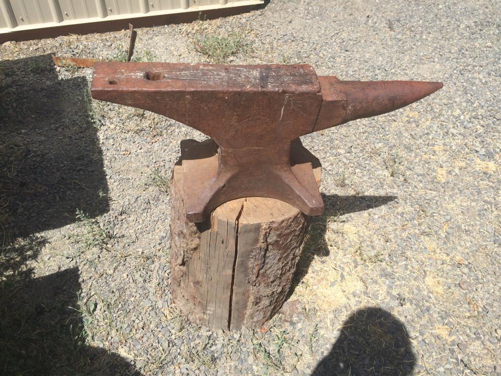

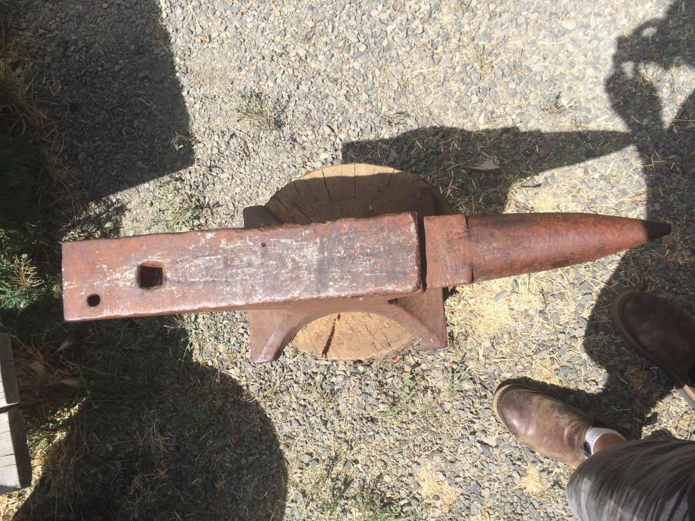

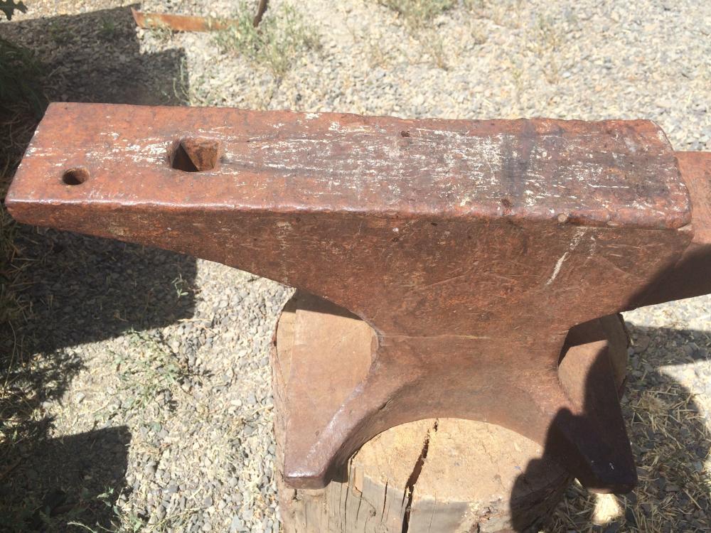

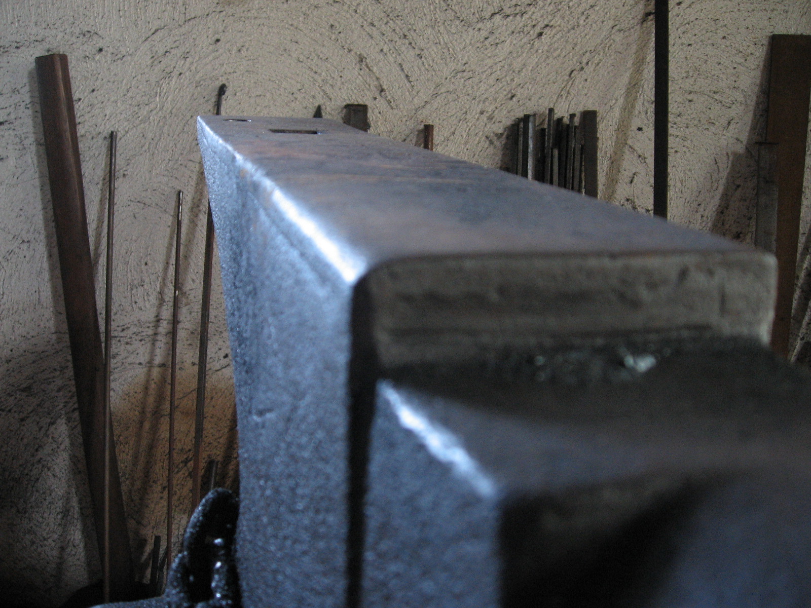

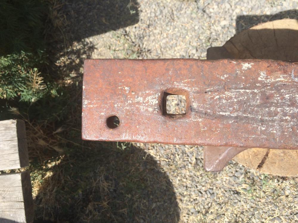

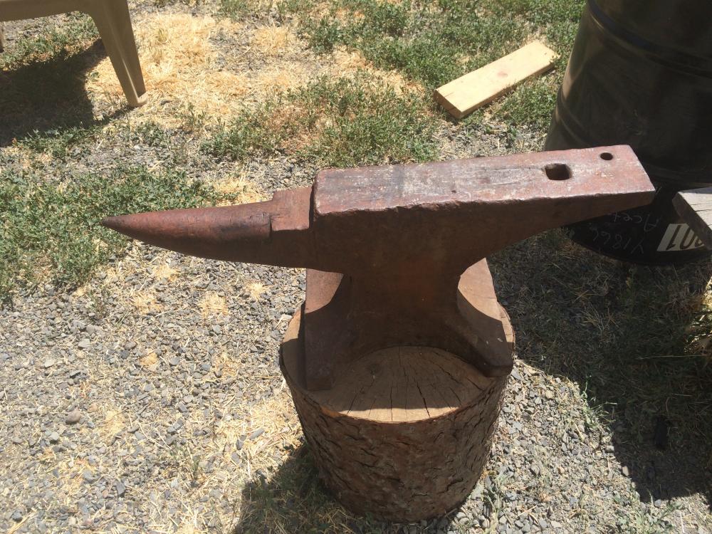

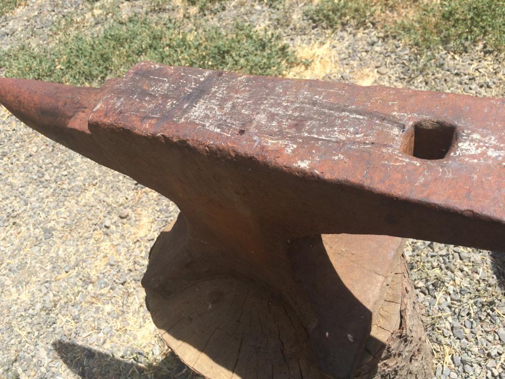

I just started and found an old anvil at my grandpa's house. The only problem is that it isn't in the best shape. How would I fix the corners? Also do you guys have any recommendations on a reasonably priced propane forge? I don't really want to make one even though I can weld.
So this is the advice i've seen on almost every other similar topic. Use the anvil like it is. You could take a wire brush to it and remove some of the rust but working hot steel on it will do exactly the same thing. The edges are fine, leave them alone until you've had some good use out of the anvil, If you need sharp edges then it shouldn't be too hard to make a hardie tool with good edges.

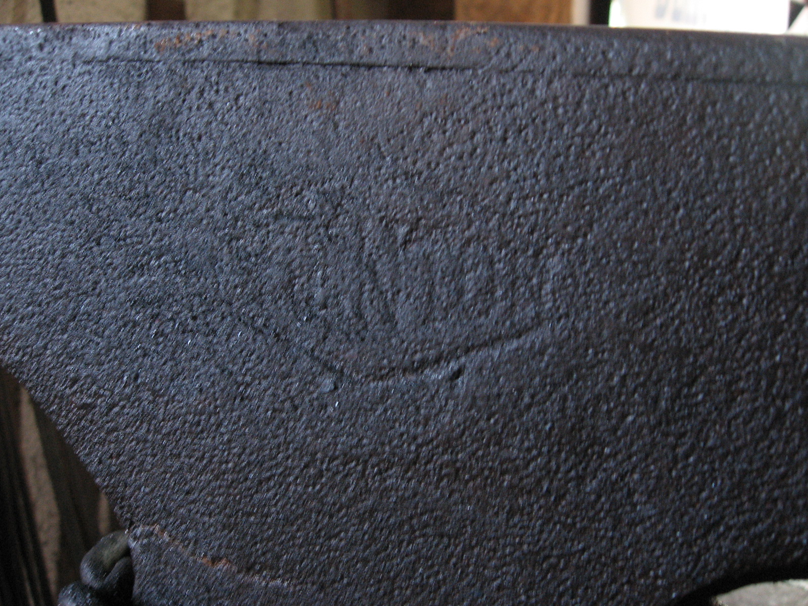

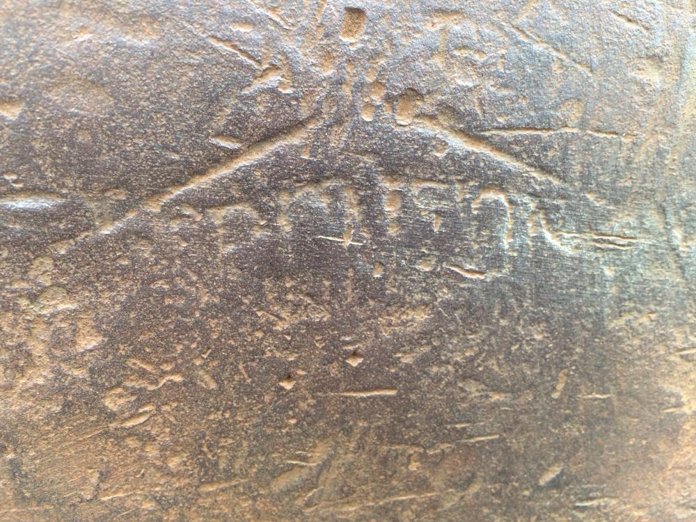

Also keep an eye out for any markings on the sides of the anvil, under the horn, under the heel and on the feet. They might give you some more info on the anvil.
Its looks to be a great anvil, all it needs is some work to do :)
My $0.02
Tom
That anvil is a Trenton and from the pics it looks to be a good size. Please don't try to fix it. The advise that Tom gave you is what you will hear from most of the experienced smiths. I personally would just remove the rust with a wire brush and put a light coat of oil or wax and start pounding hot steel on it. If you "fix" it wrong it will be very hard to un "fix" it. Also, test the rebound with a small ball pein hammer or ball bearing over the entire face and expect there to be less rebound and a different ring over the heel.
That anvil has seen a lot of use, but there is a lot of use left in it. You could destroy it completely by 'fixing' it. Brush it up a bit and leave it alone!! Best thing you could do is use it!
I wouldn't run anything more than a wire brush across the face. That rust will start coming off the face just as soon as you start using it. It'll shine up real nice where you work your hot steel. If you do a search on here there are many topics much like this one with answer to all the questions you've asked and some you haven't gotten around to yet. Don't intend to sound rude, just making a suggestion.
NO sandpaper or grinding on it. A little wire brushing on the body if you want it steel colored and maybe oil or my favorite paste wax but don't do anything to the face but work hot steel/iron on it. The edges could maybe use a little work but wait till you've used that grand old lady a few years and have a skills set to judge with. As she stands you have plenty of good edges to isolate sections and shoulder with so there's no practical need to alter the rest.
Good iron work isn't about pristine tools, it's about the skill of the smith, trying to  make tools perfect before you know how to achieve good is a disaster in the making. We've all been there at one time or another and not just blacksmithing. All crafts have this basic reaction from new comers so don't sweat it. Please just don't mess with that old beauty till you're an old hand. Hmmmm?
I've seen anvils where the corners were a lot worse than what you have and they still haven't needed to be "fixed". Yours is just fine the way it is.

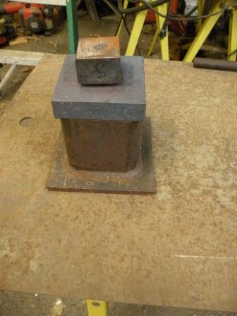

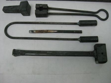

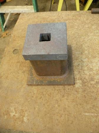

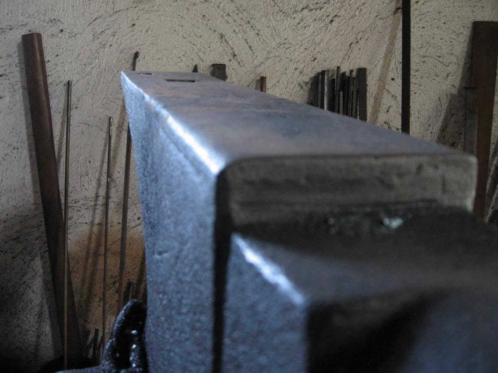

As others have mentioned if you NEED a sharp edge you can always make a block that goes in the hardy hole. Here's an example of one I made, It's a very simple project and a good one for a beginner to learn on and you won't hurt your nice anvil.  The same basic principals are used to make all sorts of swages and bottom tools for the hardy. You can see my block in my small hardy holder. This one has all the edges still sharp, but it's easy enough to make one with a different radius if need be. The plan is to eventually finish forging it as a small swage block for a special project. Plenty of ways of doing this. In this case my stock was a bit small, so I forged down the shank until it fit in the hardy hole, then upset the top material to widen my block. If I'd had wider stock to start with, I could have simply forged down the shank. You can get a better idea of the block in the top left of the last pict.

Practical Blacksmithing, Richardson, book 1 1889, page 111:
"For my own part, I am satisfied not only that the sharp edges are useless, but that they are also destructive of good work.  I cannot account for their existence except as a relic of a time when the principles of forging were but little understood. I want both edges of my anvil rounded, not simply for a part of their length, but for their whole length."  By X

You can use a wire brush on an angle grinder to clean the rust off. If you look at the anvils on ebay that Matchless antiques sells that is how Steve cleans his up.
A rotary wire brush won't hurt anything. Other than that your anvil looks perfect as is. The old saying "if it ain't broke fix it till it is" applies here.

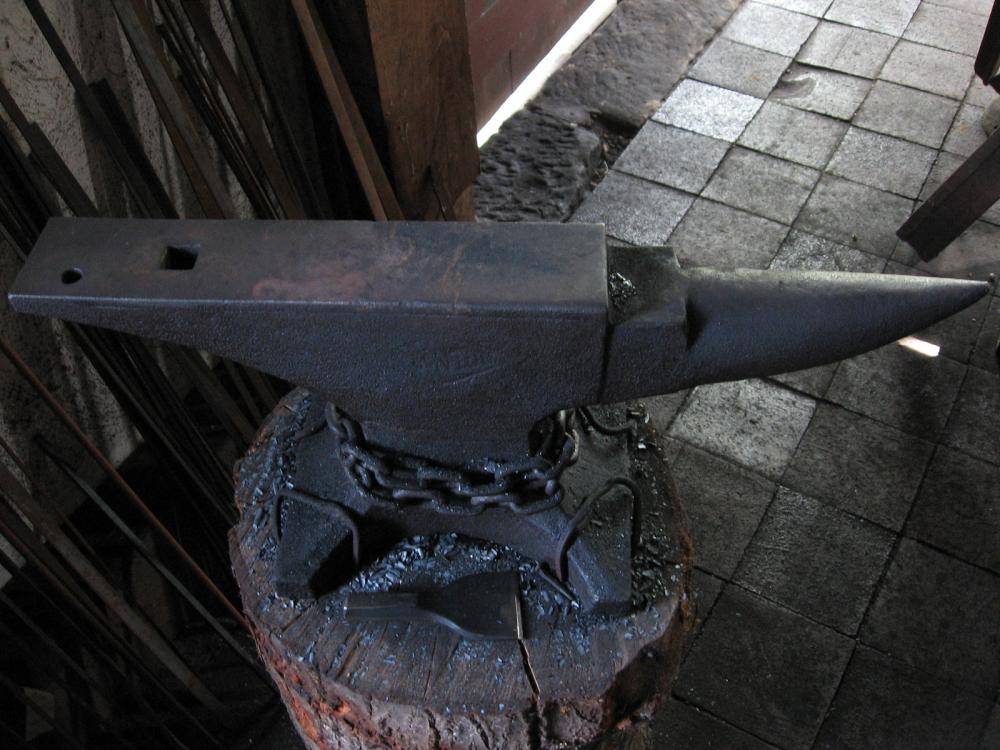

Pretty sweet anvil there. I use this one backwards. The manufacture stamp faces me. I do realize this is against all blacksmithing laws, but I play electric guitar so we are allowed to do things others find unacceptable.
Whadyamean 'backwards'? Is there really a right and a wrong way to face your anvil? I often work with the heal facing me. I reckon whatever is comfortable is right.:)
