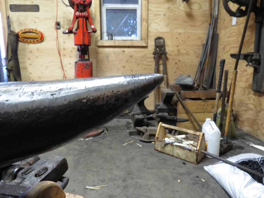

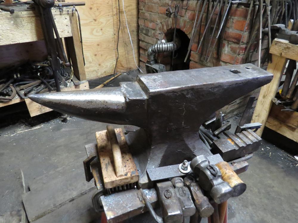

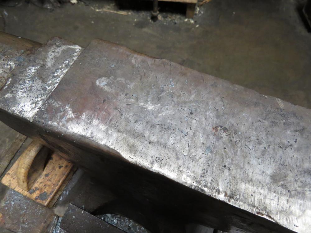

update: I Know that if I were to show you all this in front of your eye, you would probably strangle me so take caution before reading the rest........
my anvil has been welded on. no, I did not use 7018 rod, I use some expensive rod that I got at a welding shop. in fact it was hard enough that I burnt up a grinding disk grinding it down, I also did a file test. the whole side is good and sharp excepted for the 3''s of rounded edge. I also welded up the end of the horn because the tip was 3/4'' when I got it.

Just remember that hardness is only *one* factor in being a good anvil face---glass is harder than many anvil faces but I wouldn't suggest it as a forging surface!  Also being hard to grind is not totally correlated with being hard.
Ethan: There is a LOT more to hard facing than just burning rod and that anvil didn't need repairing in the first place. Did you preheat the anvil? What temperature? What kind of hard facing rod did you use? Steel on steel or steel on stone? Those are basic descriptive terms the guys at the welding supply would understand. It really makes a difference.
Fortunately I don't think you did it any harm with as little chipping as there was.
Still, don't do it again! At least let us know what you have planned there are ways to weld repair an anvil that  minimize the probability of damaging it further.

thanks frosty for the tips.
when I went to the welding shop they said they had a good rod for welding anvils because the did it before,(not that, that means very much)
it works great for me so far, and as you said I don't think I damaged it that much.:)
to answer you question about preheating, I did not, because I thing it would have taken out the hardness(is this bad?)
I wanted to weld up 2 more anvils(Vulcan) with very bad edges(I will upload pics) and so any tips or recommendation are appreciated!
