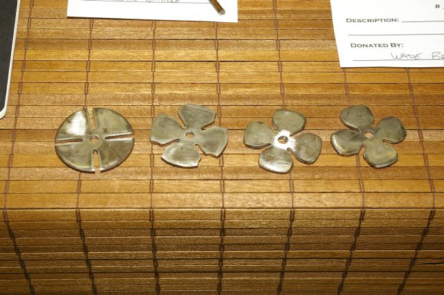

May 18, 201511 yr Perhaps something along the lines of this dogwood flower progression, then add a stem:

May 19, 201511 yr if you can find some 1-1/2" weld on pipe caps, split them and give them a try like John McPherson did above. because of their uniform thickness and dome shape the flatten out to a different shape that a flat disk. Might work,,might not Russell
