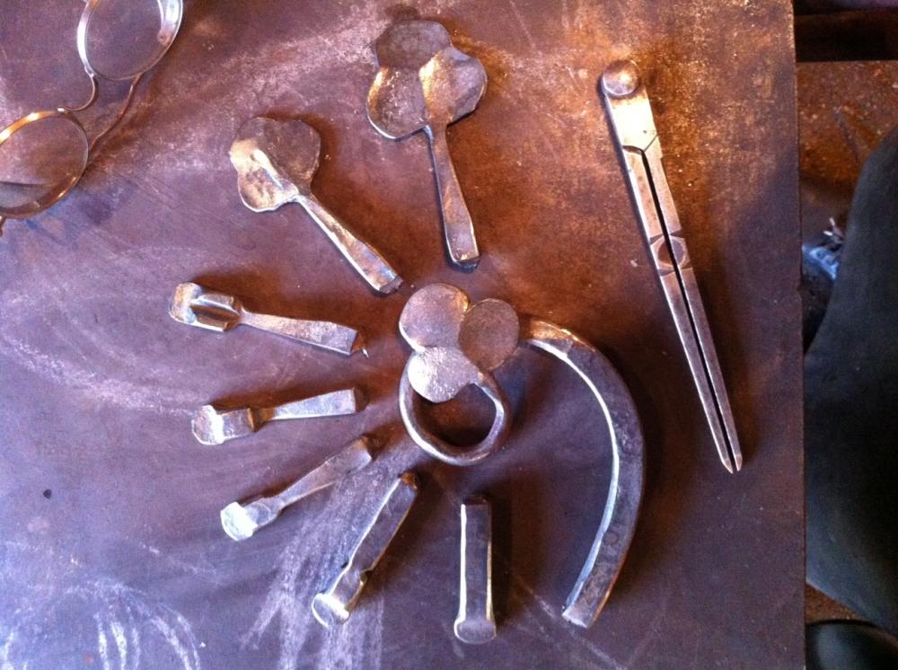

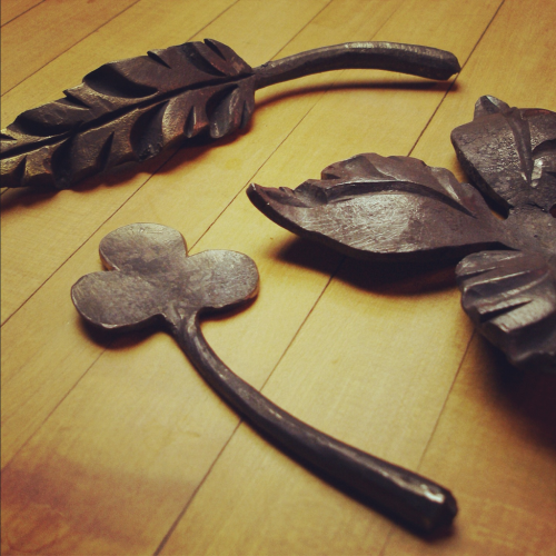

  5. Glad you guys appreciate it. I grew up in a small community named Cloverdale... so, its always been a shape that folks have asked me to make. I have been thinking on this a bit since I did the forge progression, and think that if it was done on the diamond, we could for get rid of the gate fuller and isolate the mass along the center line of the bar with half face blows only, (like a regular leaf). I don't think it really matters how the mass is isolated... but half face blows are pretty accurate and easy to do. ​I did make those dividers... but they are from a long time ago. I have improved my filing skills a lot since then. I keep them around to remind me, where I was and how far I have come... I also have one of my first tongs in the shop, but I'll never tell which ones they are.... Matt
  6. Had some time so I did a quick forging progress, that my sketch described. Don't know if it helps any more or less to see it in real life. Matt
  7. I haven't done any that have four leaves.... but I have done many of the 3 leaf variety. ( I am not lucky enough to accomplish 4.... they are so rare) The sketch shows the steps that I used and the picture is the result. Its pretty simple in its set up but when the estimating distance required for the the first half face blow... I always make the top lobe too long and have to cut some of it off before spreading in the last step.... if I get a chance, I'll do a photo step by step. Matt full disclosure: there is some clean up with a file after the last step, but it is minimal.

  16. I had some time in the shop to take a swing at the oak leaf idea... I based it on some Bavarian style iron work that I have seen. Punched lobes then add an acorn and Bob's your uncle... of course its a "stylized" oak leaf... but most folk when asked came up with "oak leaf" on their own... I took a pic after every heat or two, so I just let the pics mostly speak for themselves. 1-stem 2-tip 3-fuller 4-shape lobes 5-punch right side 6-punch left side and trim tip 7-punch tip 8-chisel center vien 9-hot file / twist / curve Matt
