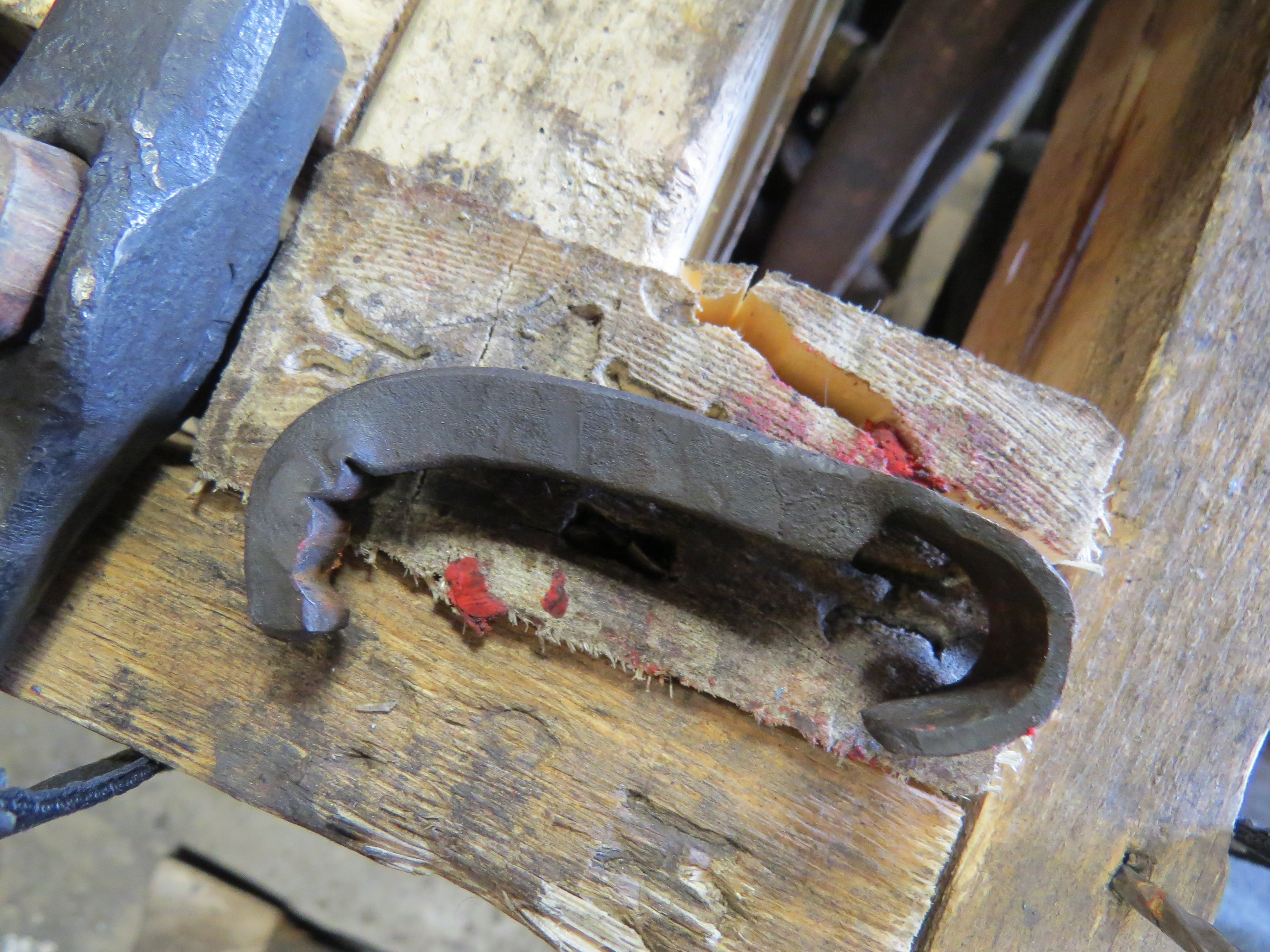

 I also have a couple of the "C" clips to use on tongs that need a greater range of clipping.  If I had to build a C clip with minimal tooling I would probably drill the indents and then saw the basic shape.

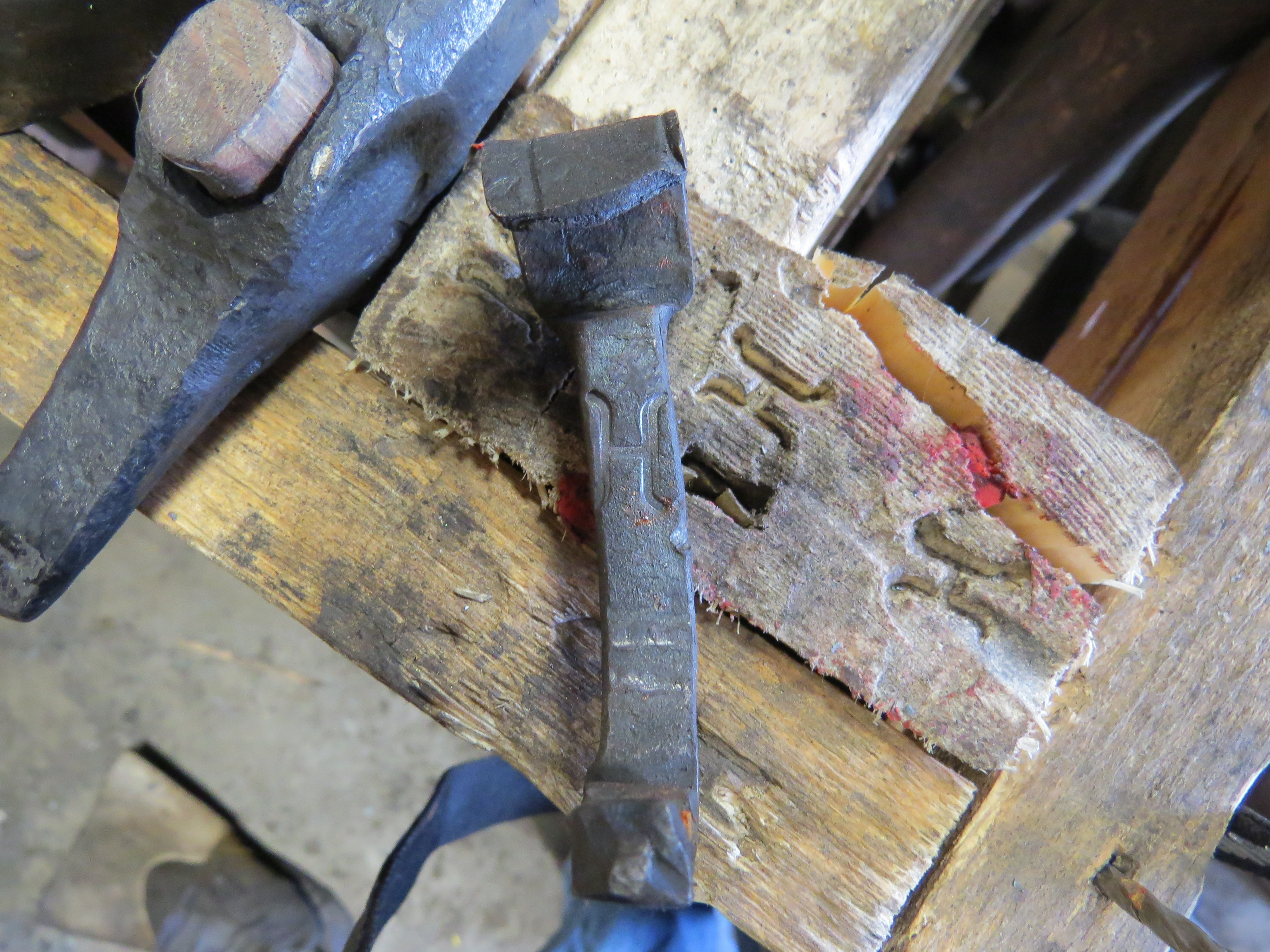

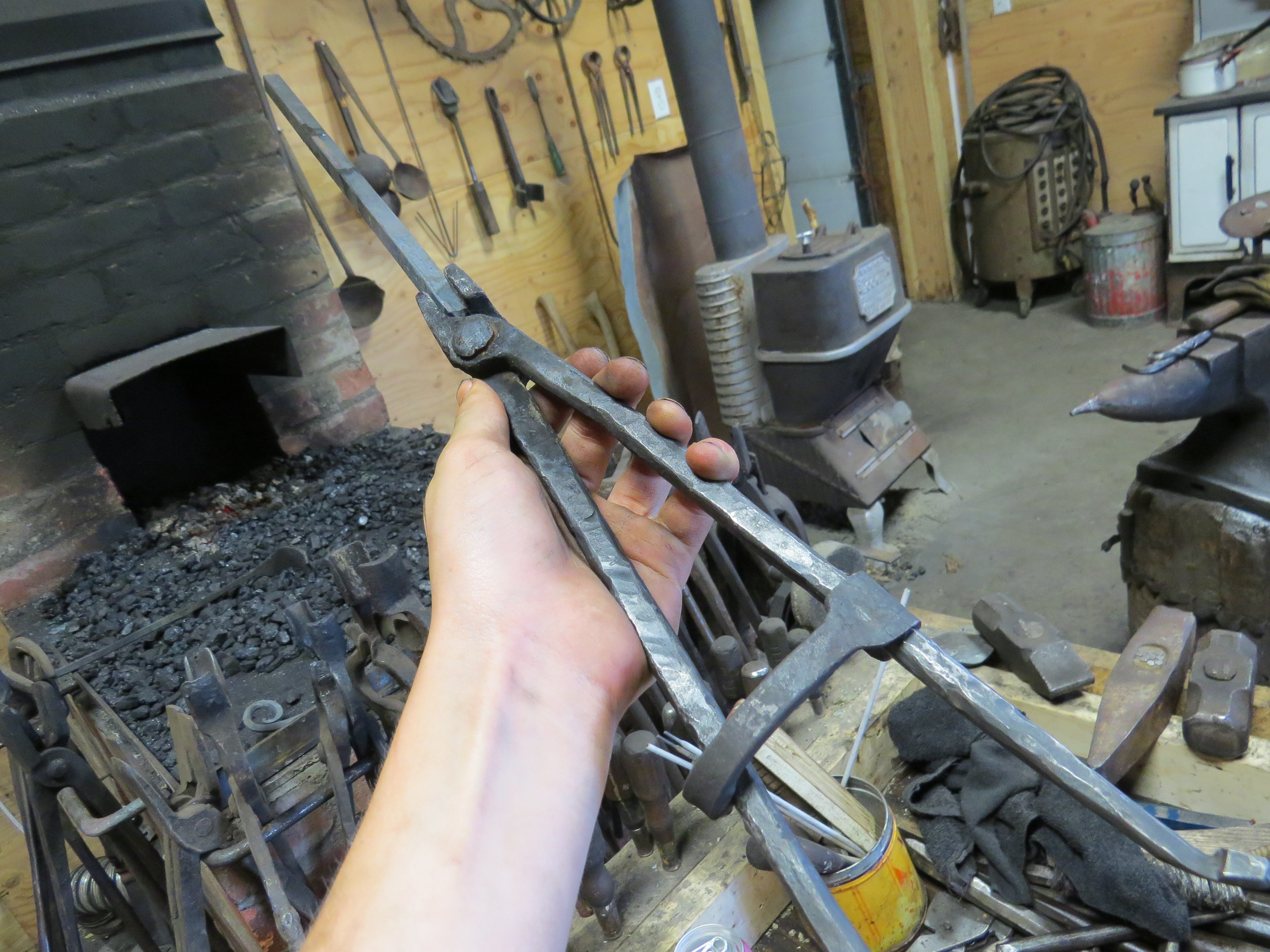

​I use the type of tong clip as the second from the bottom in the photo. Very easy and quick to adjust for any tongs I wish to use.
Yah that is the style of tong clip that Tom Clark used to teach how to make. He would often do one or two as a warm up before a demo.  He also recommended that as a general practice, if every time you were out in the shop you made a clip or two you would have enough fairly quickly.  He also was an advocate of forging a nail or two as a warm up.  It is nice to have a warm up exercise project, something that you can work on in a relaxed manner, and still focus on improving your skill.  Often times people who are just starting out bounce around doing all kinds of different projects, and don't end up being very deliberate about improving specific skills.  Choosing a simple project that you repeat over and over again, allows you to focus on improving that project, and all of the processes involved in that project.  You can do S-hooks, or J hooks, or leaves, or bottle openers but the goal is to get better.  You can sharpen your skills, and improve your finished product.  As you practice you get faster at doing it and the project gets more consistent.  As you repeat the process over and over it becomes programed in your brain and your muscles, and soon you don't even need to really think about it much.  I used to have a lot more of those clips, but between my kids coming into the shop and hiding things in the slacktub, and them flying off of the end of the tongs into the grass at demos, or getting left at some conference where I was contesting... ;-)  I only have one or two left...  I need to make some more, I do like that style I just don't keep a lot of small stock in the shop, and I will have to get some 1/4" round just to make tong clips from...

Half way  to an animal head on the thick end.
I generally just smush a ring of pipe or use a piece of chain if one of my C clips won't work
It's a little over thought Ethan simple is usually best for working tools. It Is however pretty darned cool, if you take Thomas's suggestion and carve an animal head on the thick end it'll be REALLY COOL. ;)
