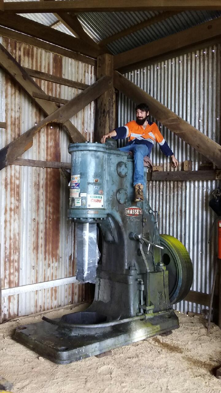

iron woodrow Posted May 30, 2018 Share Posted May 30, 2018 I found a gnome in my shop, riding my massey. Closer look revealed he is 6'7"! Quote Link to comment Share on other sites More sharing options...

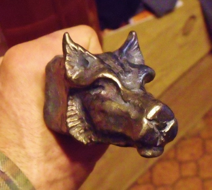

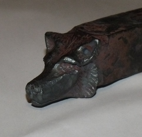

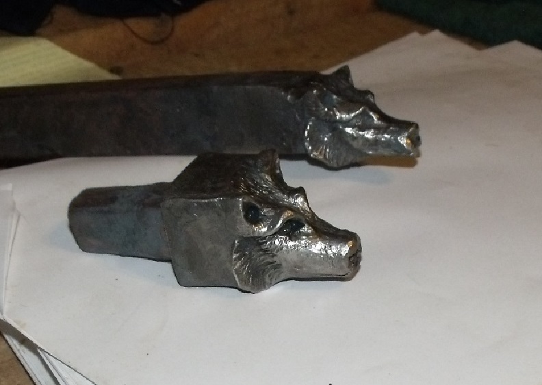

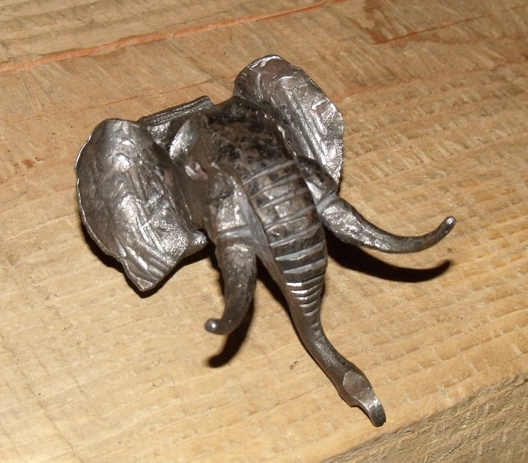

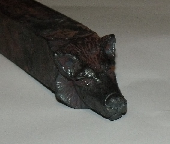

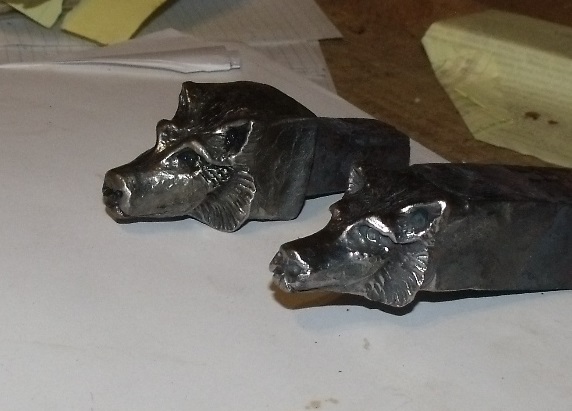

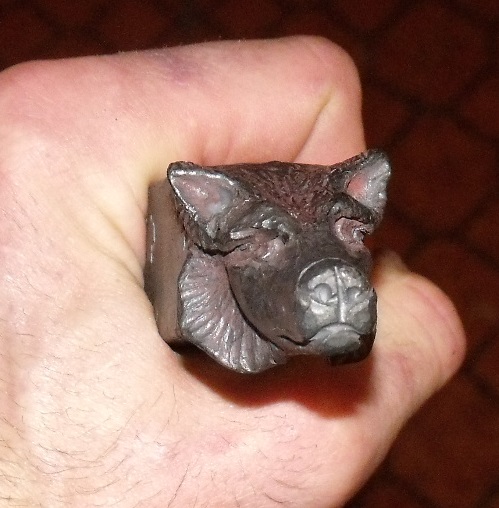

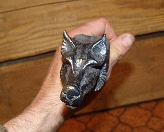

billyO Posted June 8, 2018 Share Posted June 8, 2018 It's been a weird couple of weeks in my shop for animals. A bear cub, a couple of wolves, and an elephant (REALLY rare here in the Western foothills of Mt Rainier). Fortunately I got pictures of them all in case none of you believe me. Here's the bear cub: Here're the wolves: And here's the elephant (thanks to Freddy Rodriguez): as always peace and love billyO Quote Link to comment Share on other sites More sharing options...
SLAG Posted June 8, 2018 Share Posted June 8, 2018 billyO, Nice work. SLAG. Quote Link to comment Share on other sites More sharing options...

ausfire Posted June 11, 2018 Share Posted June 11, 2018 On 6/8/2018 at 6:14 PM, billyO said: And here's the elephant (thanks to Freddy Rodriguez): That's a great piece, billyO. I can see how you can split the metal to form the trunk and two tusks, but where did the ears come from?? I'm assuming the head is one piece. Well done, anyway. Quote Link to comment Share on other sites More sharing options...

billyO Posted June 12, 2018 Share Posted June 12, 2018 16 hours ago, ausfire said: I can see how you can split the metal to form the trunk and two tusks, but where did the ears come from?? Thanks for the compliments. I'm not sure I can explain in words how to do this, but I'll try. There's actually a couple of ways to do this, depending on the approach you take to the head. One way is to take a hot cut to peel a chunk of material off the parent stock from the back, then draw out the ear with a cross peen (you can see the hammer marks). Another way to get the mass needed is when you forge the pre-shape of the head, using a spring-fuller or guillotine tool to isolate the head from the parent stock, then use a fullering tool in a "scooping" motion with your blows to pull out the material, then use the cross-peen as above. The first way is much easier. For a better explanation, I'd suggest trying to get a hold of one of Darryl Nelson's animal Head DVDs. Either the bear's head or lynx head would show the basics for this. as always peace and love billyO Quote Link to comment Share on other sites More sharing options...
ausfire Posted June 12, 2018 Share Posted June 12, 2018 21 hours ago, iron woodrow said: Gonna give it a try darryl? Why not? Makes a change from rams and bulls, Woody! 6 hours ago, billyO said: I'm not sure I can explain in words how to do this, but I'll try. There's actually a couple of ways to do this, depending on the approach you take to the head. One way is to take a hot cut to peel a chunk of material off the parent stock from the back, then draw out the ear with a cross peen (you can see the hammer marks). Thanks. That seems like the way to go. Sounds easy (shouldn't say that!) so I might give ol' Jumbo a shot. Not during demo time though - I'll wait till the visitors are gone. What was the starting stock? Quote Link to comment Share on other sites More sharing options...

billyO Posted June 12, 2018 Share Posted June 12, 2018 That one was 1 1/4" square stock. In my experience, animal heads up to 1 1/2" square aren't too tough. I'm almost finished with a husky out of 2" square, and not sure I'll do that again. It took 2 days of hammering just to get the pre-shape formed. But I guess I'm getting some good definition in my hammer forearm muscles.... 15 hours ago, iron woodrow said: Post results! Yes. Please do, I'd love to see it as well. Quote Link to comment Share on other sites More sharing options...
ausfire Posted June 17, 2018 Share Posted June 17, 2018 Well, I did have a go at the elephant today, but using smaller stock than 1 1/4 square. It needs more work and I'm not posting the result yet. It looks a bit like a walrus at the moment. Quote Link to comment Share on other sites More sharing options...

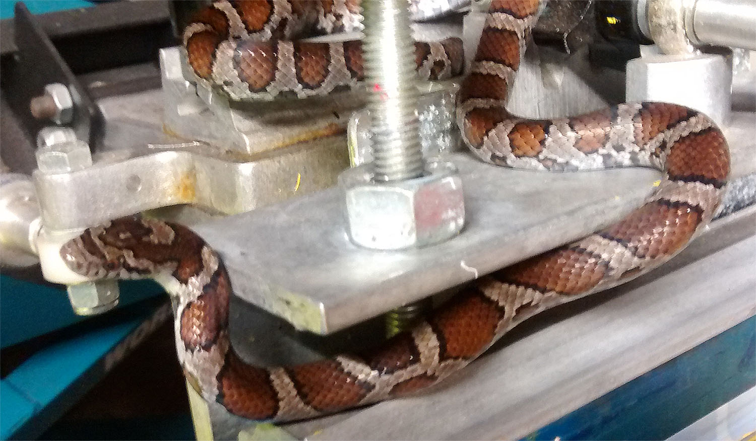

Glenn Posted June 21, 2018 Author Share Posted June 21, 2018 You have to be careful when you make adjustments to shop machinery. This is a non-poisonous Corn Snake, a bit larger than a penny in diameter and 20-24 inches long. It was a nice snake that did not try to strike, bite, or even try to escape. Can you tell the difference between three three snakes and choose the poisonous one, and the two non-poisonous ones? Top: Make and female Copperhead Snakes which are poisonous. Middle: Northern Water Snake which is non-poisonous. Bottom: Corn Snake which is non-poisonous. The one in the shop. YOU have the advantage of see all three snakes together and are able to compare them one to another. The adult Corn Snake is 30 – 48 inches long and is orange, reddish brown, brown, or gray with 27-40 squarish black-outlined brown or reddish blotches. The belly is checkered with white and black markings, resembling a piano keyboard or Indian corn. Other distinguishing characteristics include a spear-shaped blotch on top of the head, pointing toward the nose, black stripes on either side of the bottom of the tail, smooth scales, and a stripe extending from the back of the eye past the corner of the jaw. Corn snakes are often mistaken for venomous copperheads. Copperheads, however, have hourglass-shaped (rather than square) blotches, and are generally browner than corn snakes. The way to tell the difference (this location) is the poisonous snake had two nose holes each side of the face (pits), and slit eye pupils (like a cat). The belly bands (scales) go clear across the body from nose to the tip of the tail. The non-poisonous snakes Northern Water Snake and Corn Snake have only one nose hole on each side of the face, and round eye pupils (like people). The belly bands (scales) go clear across the body to the anus, then there are two belly bands (scales) from there to the tip of the tail. This lesson in herpetology supposes that you are interested enough in the snake to identify the snake as poisonous or non-poisonous, and then to identify which snake it is. The snake is now part of the witness relocation program and was moved to the scrap pile for its safety. Quote Link to comment Share on other sites More sharing options...
