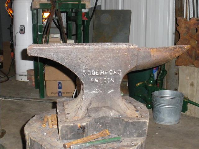

The Thomas Powers Applied Anvil Acquisition Technique (TPAAAT) does work. From a cold start, it took two contacts, and 6 days to get an 143 pound anvil using the TPAAAT method of sniffing the air.
The anvil is marked 1 - 1 - 3 or 143 pounds.
actual anvil weight on the bathroom scales 148#
It has an arm holding a hammer, SUNK IN logo, and a tool steel face, no other markings I can find.
Can you provide any additional information on this anvil?
The wife? I told her to thank Thomas as he provided me the Blueprint on how on how to find anvils, and now they just seem to show up in the trunks of cars. :)
Thomas - thank you !!

Glenn-What you have is an Arm and Hammer brand anvil manufactured in Ohio between 1900 and 1950. Mr. Postman devotes 25 pages of his book to this brand and considers them one of the finest wrought anvils ever made.
There should be a serial number on the front foot area and there is a list in the book that will date it.
You better pick it up again though..that 1 1 3 is just that...113 lbs.
My shop anvil is a 156 lb Arm and Hammer.
Cast iron Vulcan anvils used a similar logo of an arm and hammer so this sometimes causes confusion. Two different animals altogether. You got yourself a nice anvil.
Note, the anvils with the stamped or sunk in LOGO are iron, the anvils with the raised LOGO are cast iron.
Actual anvil weight = 148 pounds (wife's bathroom scales).
I tried forging on it tonight, and it works for me :) (pun intended). If I can get some time this weekend, maybe the two of us can get acquainted.
All of the pics of Arm and Hammer anvils in the book and my anvil are marked in actual pounds. I can't remember seeing any American made anvils marked by hundredweight. I think yours is a poorly marked 1 4 8. Congrats!

Arm & Hammers are often not struck too deep so the 113 might have been a 148 with partials for the last two stamps.
