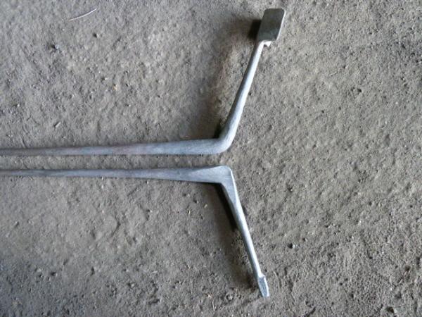

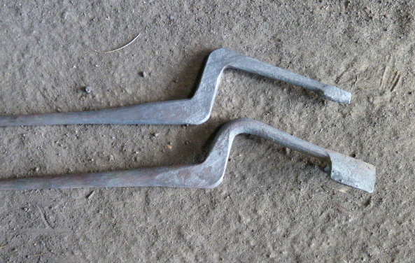

I found the pictures missing from this thread. WIP for Brian Brazeal's ultimate tongs.
post-4954-0-98110900-1387723301.jpg.482c031fe042ebb9296f39b0e1869a8e.jpgpost-4954-0-41015900-1387723328.jpg.261c93f3bea5ea8e81cf8b224ccd0ea6.jpg
Thanks, Gergley! What's your beginning stock?
It's not mine. It's Brian's photos and work. IIRC in the first page of this thread you can find Brian's comment about these tongs, I just re-loaded the missing pictures because I found them on my PC.

Oh, I see. I thought these were your own photos of a pair that you'd made yourself. Gotcha, and thanks for reposting these.
Well I found them because I try to make a pair like that. :) If I will succeed making it I'll post my picts. But it will be different even though I try to follow this guide. My skills are nowhere near Brian's and my tong stock is 1"x3/8" (25x10mm) steel.

Brian's comments on the material, compiled:
On 3/23/2010 at 1:22 PM, brianbrazealblacksmith said:
They were made from 3/4" hex tool steel.
On 3/28/2010 at 9:08 PM, brianbrazealblacksmith said:
I started with about 8 1/2" of 3/4" hex, and the small hex jaw is a little bit longer than 3/4". The V jaw is almost 1 1/2" long.
On 3/29/2010 at 8:08 AM, brianbrazealblacksmith said:
Yes, a crowbar would work, but you can also use coil spring or jackhammer bits. I wanted at least 3/4" for the V-jaw, so I used the hex I had. The 3 point contact is what makes the tongs work with such a wide range of stock, so I wouldn't change that. Also, I forgot to mention that the V- jaw is less than 90 degrees. I never make V-jaws with a 90 degree angle.
