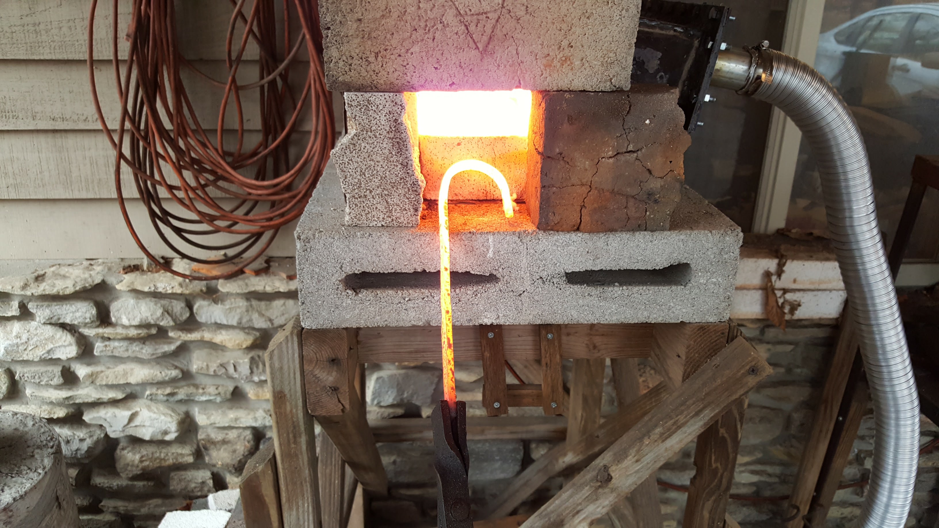

  5. I made a blown ribbon burner earlier this year. It has a single row of nine crayon size holes. They are 1" on center. I had in mind knife making and so was going for a longer flame area. So far it seems to work good. My next improvement is to rig up a solenoid controlled air gate valve so the PID temp controller does not turn my motor on and off constantly to maintain temp. I ended up overbuilding the blower not knowing quite what would be needed and ended up needing to choke it down a lot. For the blower I followed the directions from Iron Melting Cupola. https://www.amazon.com/Melting-Cupola-Furnaces-Small-Foundry/dp/0970220308/ref=sr_1_fkmr1_1?s=books&ie=UTF8&qid=1499878429&sr=1-1-fkmr1&keywords=iron+casting+cupola. His directions are for a metal blower but I made it from wood. By the way, I have plenty of space behind this so my house window and wall are not affected. I think that I can put my hand on the outside of this and not get burnt.
