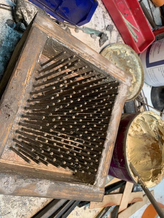

  12. OK...I took a video of casting the burner head, but when I try to download it I'm getting a -200 error immediately. I know I can't put a youtube address, but you can look on my website listed in my profile in the "Studio Tour and Video" section. The new burners work like a charm. The front one has a large baffle, the rear one doesn't. I think on this design a small baffle would have been appropriate - I went the two extremes. Either way, they both work. I haven't run it for more then 30 minutes or so, do I don't know about backfiring when it gets hot. The plenums get a little hotter then expected, almost too hot to touch in 30 minutes. Less of the "organ" sound on these. Only happens when cold in a narrow pressure range. They seem much more adjustable to lower temperatures then my smaller 1/8" ribbon. Check out the video! Pics The mold with metal 3/32 rods. _______________________________ The head after demolding. I've already pulled some of the rods out. _______________________________ The Frankenschtein forge set up for a test run. The two burners are different, the closer one is my best cast burner so far, the rear is an earlier iteration that doesn't work as well. _______________________________ First burn. Not tuned. the rear burner is much more rich, but it's a reject burner. _______________________________ Low pressure test. Works perfectly down to under 1lb. Gets really rich at low pressures since it's not pulling in much air anymore. No backfire! _______________________________ After running for awhile. At 3 lbs pressure. Looking really nice. _______________________________ Left the window open....when I went to work on my mill I found a nest in my tooling rack. This is after about 3-5 days after hatching. _______________________________

  14. Pics coming. Was working on the burner lines today. I used lithium grease first time, and A&D (a bottle of diaper ointment I found in the back of a cabinet...my son is 17yo now It’s basically Vaseline, wax, and lanolin). They pulled out easy like they were greased DanR

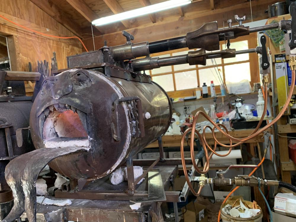

  21. First thing I see is no door. Maybe just open for the picture? If not, a couple of IFB (insulating fire bricks - the light soft kind, not the hard heavy ones). Huge amount of heat loss with open doors and ribbon burners, I even find that closing off the top half of the opening is very helpful (heat rises). What is the cubic inch (or metric) size of the interior of your forge? I assume from what you wrote and past posts you are using a blown system, not NA. If so you should be able to crank it up. A gas jet of 1mm (.039") is very small for a blown system, try drilling it out to 2mm or more and use a needle valve - if you are using propane it should still work at that size, you'll just have to crank the pressure up higher. Further, the 23 hole size is designed for a NA burner, and the original one by Wayne Coe is a 26 or 27 hole so it should work fine if you're forge isn't too big. Should do a 350 cubic inch (around 6000 cubic cm?) forge easily - and more if you can crank it up. The small jet might be limiting the amount you can turn up depending on your gas pressure. But it doesn't look excessively rich in the pic. If you're using propane, you should be able to crank that up to 20 lbs easy. If you're running on a gas line, I don't know the pressures there in Germany. 20mm refractory is about 3/4" - which is fine but may take 30 minutes or so to get up to heat depending on the type of refractory. I am a believer of very thin layer of refractory or eggshell layer, but that is not so common and needs more upkeep or care. First time may take a little longer as the last of that water is dried out. As I say, I don't use thick refractory layers, but others may chime in. You are going to get cold spots in your upper and lower left edges next to the burner. Is there any way to tilt the burner up or down about 20 degrees? Up and the ceiling will heat up and reflect onto the floor, and the flame will form a bit of vortex around the forge. Down and it will directly heat the floor and what you are forging. All the combustion with a ribbon burner takes place in the first few inches - in your pic you can see it's fully combusted about 1/3 of the way across the forge. One advantage of a ribbon burner. The burner right now is blowing exactly at the opposite wall, which then reflects back - another thing which might be adding to it burning out. Anyway, hope that helps. Try one thing at a time, and see if it helps or hurts. 1st start with a door (blocking the opening 3/4 closed). 2nd if the interior size is too big put some IFB in the right side and make it smaller and see if that helps. 3rd try playing with the jet size and see if that helps. Good luck, DanR
  22. Your build looks great! Some suggestions on your setup. The pressure between the jet and the needle valve may be unreadable on the gauge depending on the size of your jets. I would put the gauge before the needle valve (actually before the ball valve shutoff) so you can see/set the maximum line pressure, and then adjust with the needle valve and air to fine tune. You have a very rich flame, and the regulator is showing nearly 0. Given the type of blower you have (Ive got one like that too), you should have excessive air. I'm guessing it's gated down in the pics. If not, I noticed the pipe after the jet is a much smaller diameter and may restrict the air flow. An HVAC guy one told me about the importance of larger vents...I carried that onto my build. I used one the same size as the exit on the blower.... 2.5" I think. Either way, looking really good, it will work completely differently in the forge anyway, and all this might be moot! And thanks for your service! DanR
