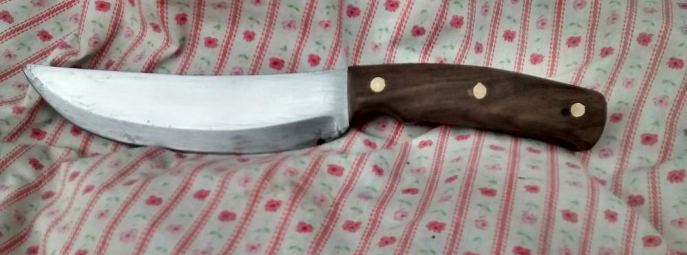

My own skinning knife
Bearded Guy Thank you. I appreciate the kind words. But yeah, I would like to see dimensions of yours. As the fellow members have said before, it would be truly difficult to come up with a genuinely new design for just about anything, tongs, hammers, knives, etc. but I still felt it was necessary to say that I did not intend to just copy your design. Your skinner turned out really nice btw, I loved the antler handle. JHCC That's interesting. Must have taken quite a few salmon skins to make a whole parka!
Smoggy Thank you. This knife probably wouldn't be used unsighted (for gutting I assume you mean) I agree with you, I prefer a MUCH smaller blade for that. You nick a bladder *one* time, and it makes you reconsider your knife size haha. It would be mostly for skinning and fleshing. I've never tried using trout skin though. Seems kind of fishy...
Michael Cochran I have skinned a few critters in my time, and I tan the hides as well, for leather mostly, not furs. That being said, any hole in the hide really impacts the product, as you have to work around it. I liked this design because the tip is plenty far back, reducing the chance of accidentally poking a hole. Drop points have the tip a little too close for comfort, in my opinion. As for the size... Yes, I agree, it should be smaller. I wanted it to be a little more wide and less long than it ended up. Hence why it became a little thinner than planned too, i tried to pull too much out of it i think. Yet another sign that I have a lot to learn.

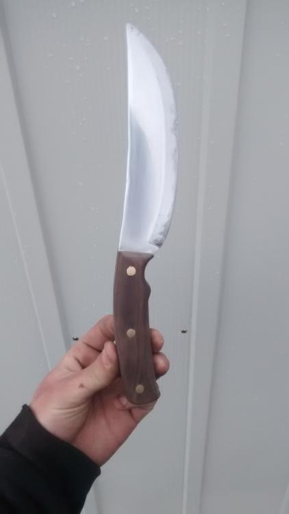

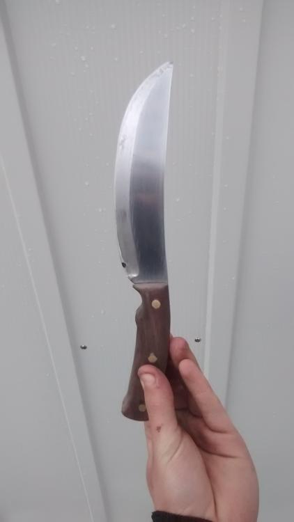

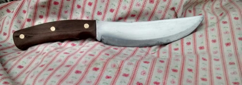

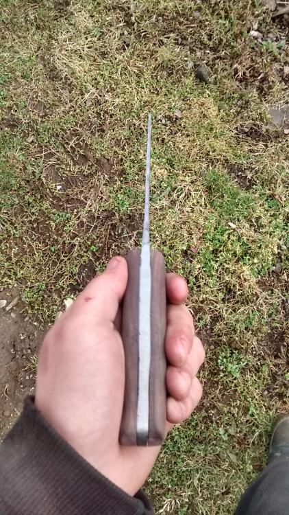

Hello all. Firstly, the design of this blade was inspired by Bearded Guy's cable welded damscus knife. This is, in no way, supposed to be a copy. I really liked the design, and wanted to give it a go, though I believe his turned out far better than my own. Now then, the knife is 10-1/2" overall with a 6" blade, 1075 steel. The scales are black walnut, with no stain (I absolutely love the look of the stuff!) 3/16" brass pins. The blade itself turned out thinner than I would have wanted, but I was cautious with the heat treat, and tempered it appropriately (I think) at two cycles of 425° for an hour per cycle. It retained hardness quite well, and is moderately flexible. I must thank Thomas Powers for introducing me to the technique of draw filing. I believe it has allowed me to be far more accurate, and achieve more crisp lines for the plunge line and ricasso. I still have a LOT to learn though. Any thoughts, comments, or critiques would be appreciated. Thanks for looking!
