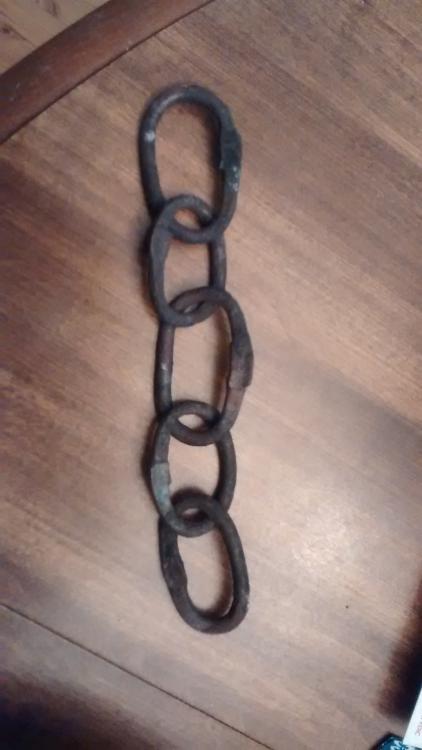

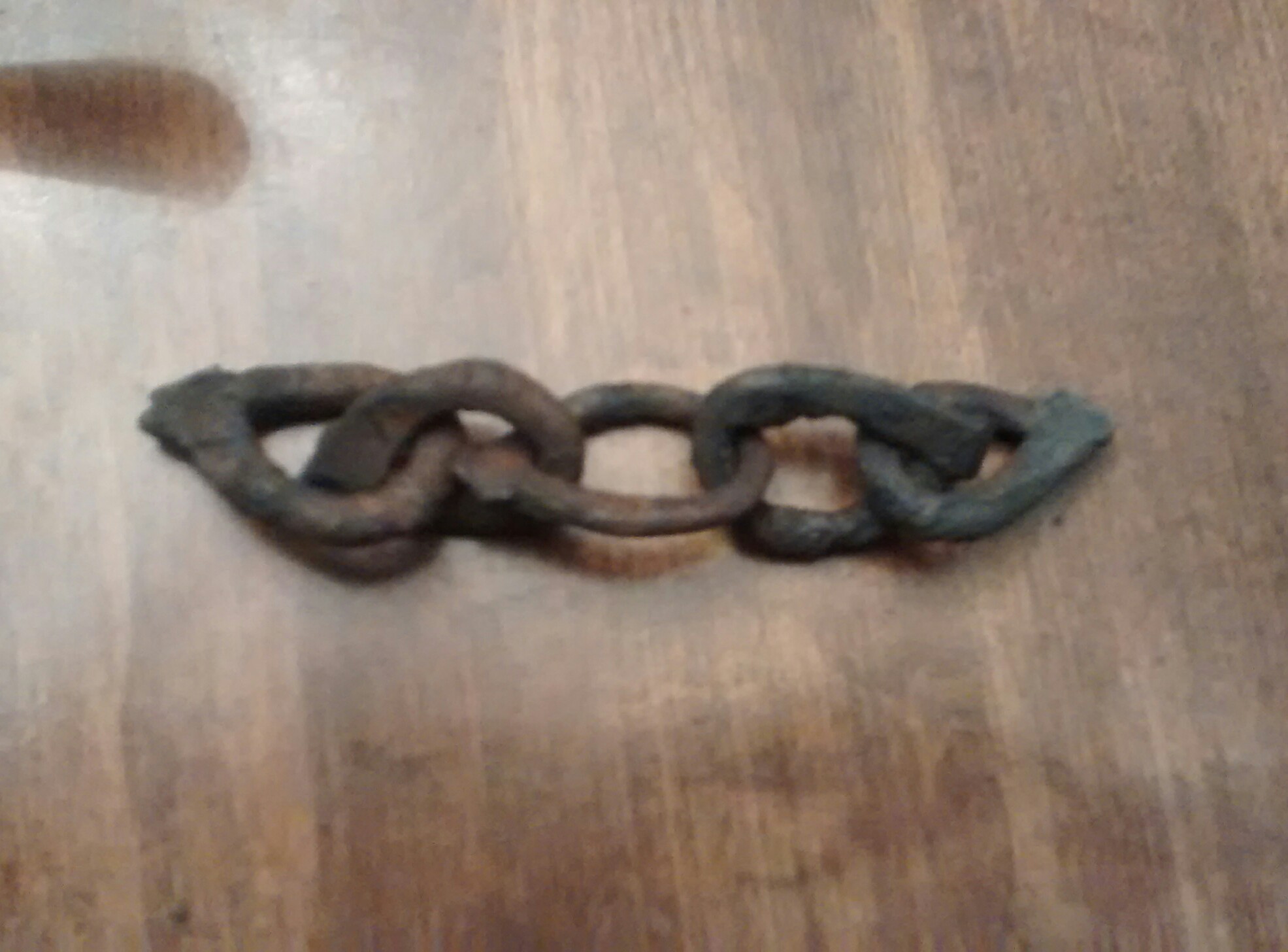

Attempt #2! I need to work on my scarfs and consistency, among other things. I plan on making this a longer chain, so it shall be interesting seeing the quality (hopefully) progress from link to link. JHCC The link (no pun intended) didn't work for me for some reason. No clue why. Those are good looking chains, both Michael and arkie. Nice work guys.
Thomas Now that I want to see! From a safe distance, of course (in case a link pops.) Glenn I think I'm on the same page as Michael Cochran. I would think you would want it normalized to releive stress and provide decent ductility. I wouldn't imagine you would want it hardened and tempered. I definitely don't know for certain though.

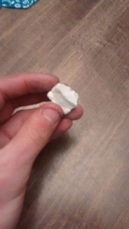

Late reply, just checked in. All I can get my hands on locally is anthracite. Seems to do the job pretty well, and I don't use a lot anyways. I burn mostly charcoal. -

Good day. I forged this out a little while ago. I wasn't even planning on making chain, it just happened haha. I burned a few of the links a little bit, but all in all, I learned SO MUCH about forge welding through this little project. The links are kind of odd shaped too, but this is my first go. Show me your chain! I would like to see what others have made. Shoddy picture, sorry.

This is the first time I've noticed any trash. I have never looked for it before though. I'm definitely going to keep a closer eye on the stuff now. If it turns out there's a lot of junk in there, I may have to switch brands (or just forsake anthracite completely.) That makes sense about the coal dust though, the fact that it was definitely black when it went in the forge is what puzzled me. Thanks for the reply. -
Good day. Let me explain my setup briefly. I burn primarily charcoal, but I throw a few pieces of anthracite in on my grate above the tuyere before adding charcoal to keep the small pieces of charcoal from falling through (I designed my grate back when I knew nothing and as such, the openings are too big.) When I was cleaning it out the next day, there was an interesting looking piece of (presumably) coal left over, so I took it out and played around with it. It was white, like charred coal, but it just looked strange. I broke it apart and it was white all the way through. Usually the leftover coal is still black in the center, ALL the other ones from the same fire were, and they were similar size (nut coal). I asked a friend who knows far more about geology than myself, and he said he is confident that it is sandstone. Its very soft, like sandstone, but i cant break it with my hands like burnt coal. I know that all the pieces were black when I threw them in, so what gives? This makes me question the quality of the rest of the coal that I have. The brand is Franklin Anthracite if that helps. Poor quality pic, sorry, but it's one of the chunks left from when I broke it.
