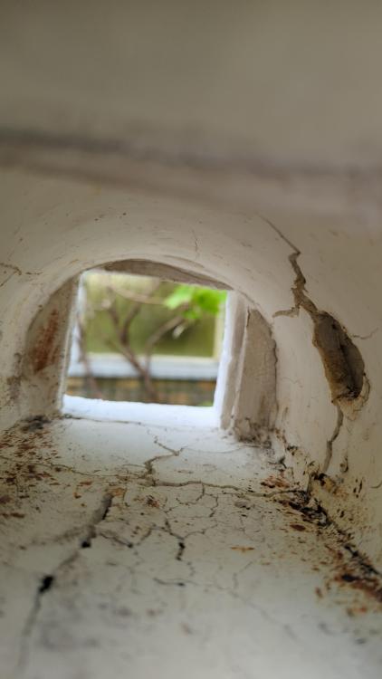

  2. Just to reiterate, I don't think I am breaking any new ground. I would like to have a homemade high zircon mix that holds up to lots of fire, I am not there yet. MR Hansen himself states he has mixed results in thermal shock resistance (see https://digitalfire.com/picture/1517) And I do think that this is one of the variables in play, looking at my results. For any new forge builders that are not me; get a known refractory concrete, build around that. That being said, and as stated before, I am pretty confident in the application as a refractory coating, as stated in an earlier post in this thread. I have yet to test it out on plain rigidised blanket but we can tackle that in this thread.

  5. Thanks Mikey. Randy thanks for the tip. I accounted for the shrinkage part, what you describe is more or less what I did. I built the floor and the roof, had the fired in a kiln so all the firing shrinkage was accounted for. I then took an old pressure vessel, cut it in half lengthwise and put a hinge in. Built the forge around the ceramic parts and closed the lid. My mistake here I think, again not confirmed, is cementing the floor and roof together as well as cementing some parts made out of kiln-shelf to the rest. I could at least have left some gaps/seams to account for the parts expanding and contracting during heating cycles. (in a lot of ceramics kilns the bricks are held in a frame rather then cemented together for exactly this reason) Drying shrinkage, firing shrinkage and thermal expansion/contraction are 3 different things that should be accounted for at different stages. The coating recipe does not seem to suffer from excessive shrinking, at least not when applied in thin layers and as long as water content is not too much higher or lower than mentioned.

  15. Always happy to share. All percentages are by weight. I mixed the components dry before adding the water. After the water is mixed in the material feels and molds like clay but it is very sticky, so be aware of that. I used a mould to make two tiles, one I left flat to become the floor, the other one I draped over a tube to get the half cylinder. Photo if the mould below. (Can't find a picture of the tube unfortunately) I had everything fired with their porcelain. So in the ballpark of 1300/1350 degrees C. Building the forge from the outside in had its own challenges, mainly because I did not have a shell. Found one that was close enough , found a use for refractory mortar and built an extension out if kiln shelf.
