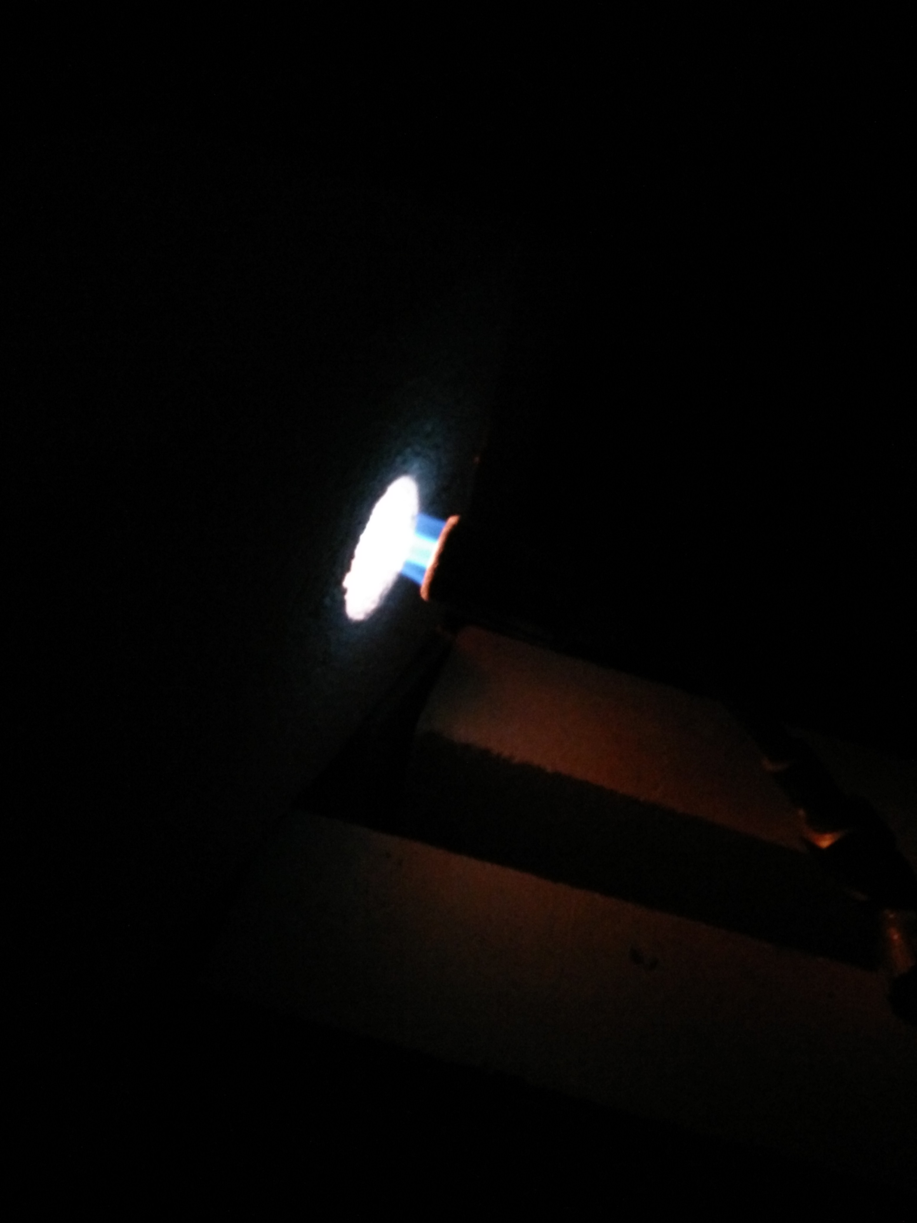

I got myself an adjustable regulator, this helps. A lot I just gave it a quick test run and I have to figure out how to get some nice pictures of the flame. Also I need to find the right pressure. I do get flame from the front and back, not as much as at 1.5 bar so that's an improvement. I get a pretty even heat across the chamber but I need to experiment with the burner angle. straight in from the side will give me more of a hot spot than the propane torch did so I'll see if I can reintroduce the upward/forward angle. Some pictures below. I will keep you posted. -

Buzzkill, I remember reading about burners not working outside of the forge without a flare, just never tried it out since this is the first one I built. Thanks for confirming. Sorry for the bad picture, but this is how it burns now. As you say, a lot of heat coming out of the front and back if I remove the brick.I need to find a better way to mount the burner in the forge, it kind of wobbly now. -

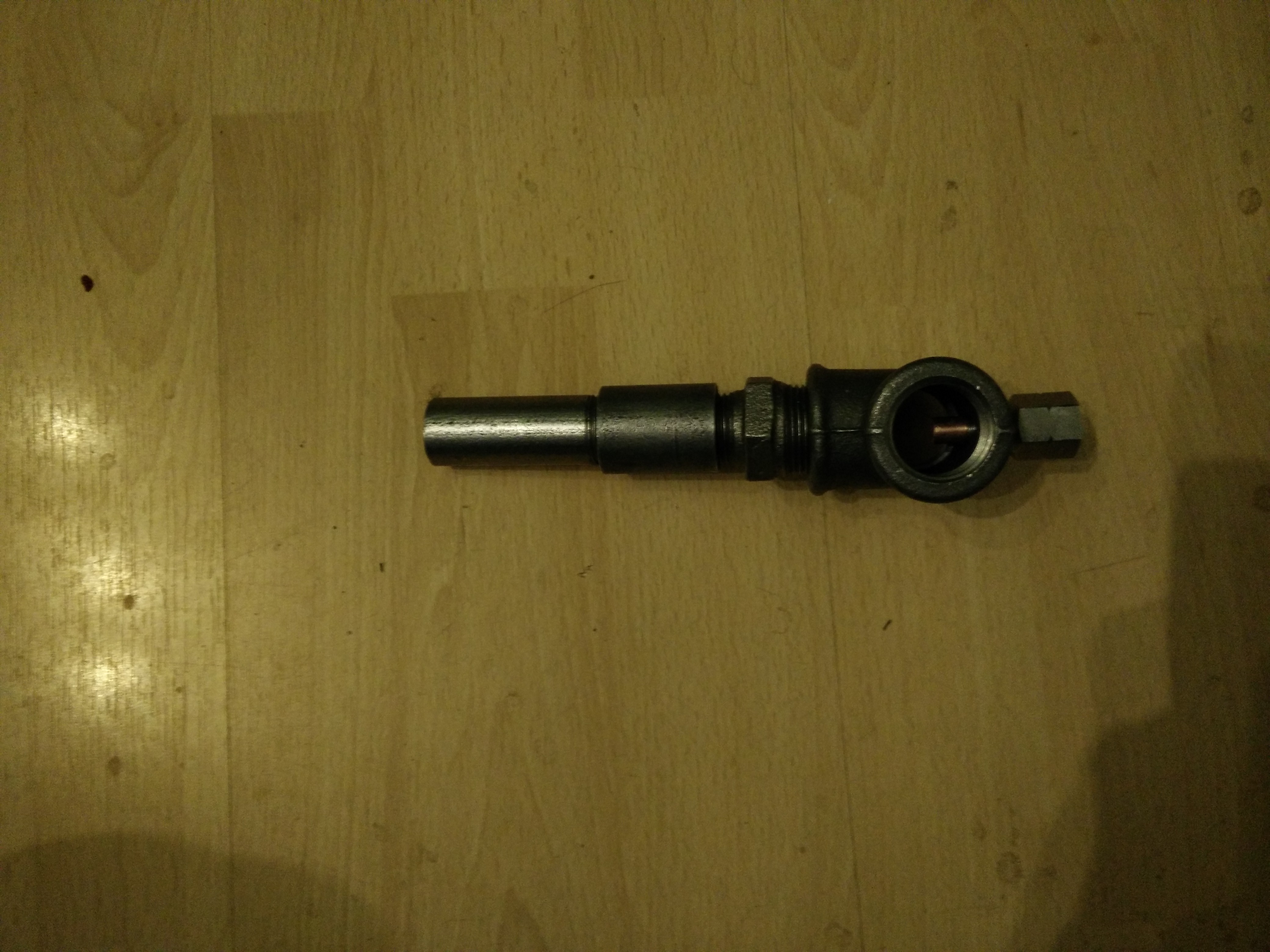

Progress, the little burner will burn, just not outside the forge. When I light it outside of the forge it blows out as soon as I take away the ignition flame. The regulator I have is set at 1.5 Barr which is around 21 psi which might be to much? Or will it simply not burn outside without a flare? It heats up the forge quickly, at the moment it is a bit bright outside to get a good picture. Burner now looks like this: -

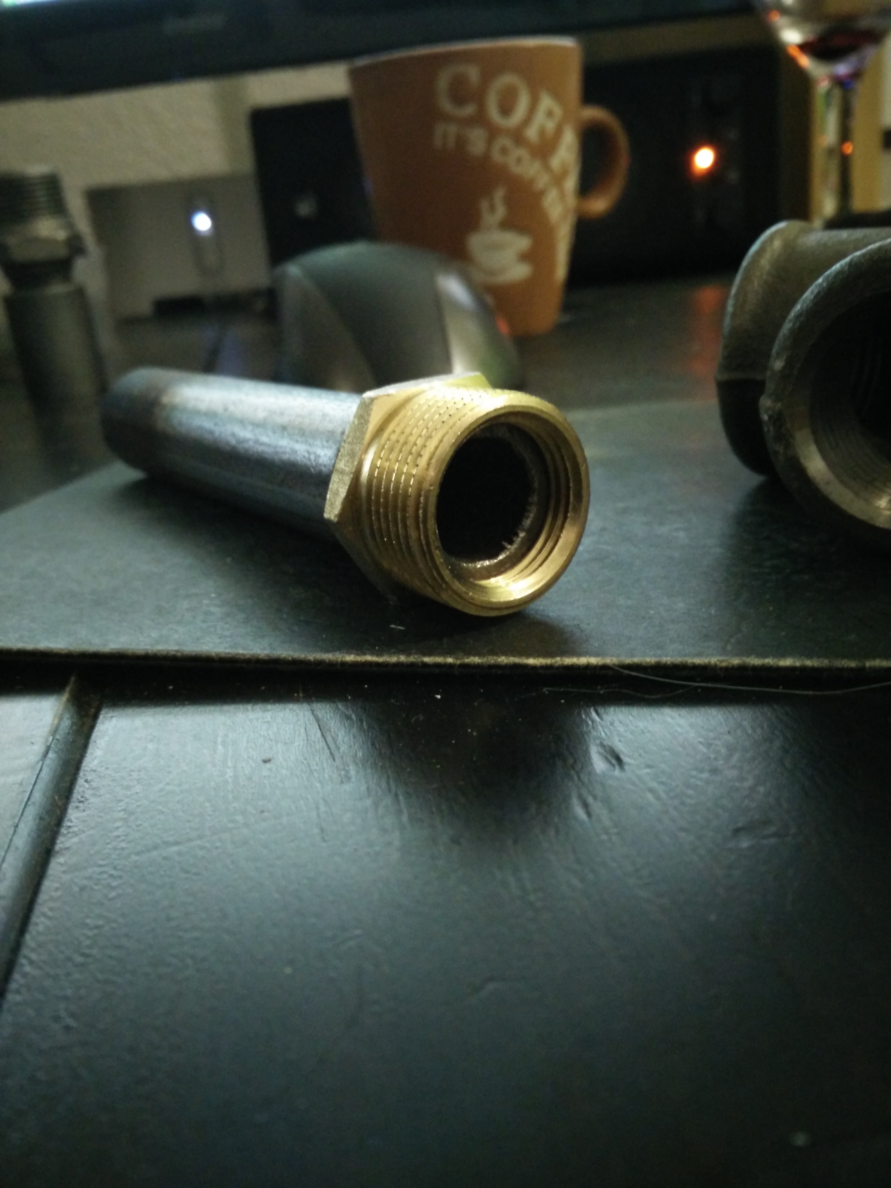

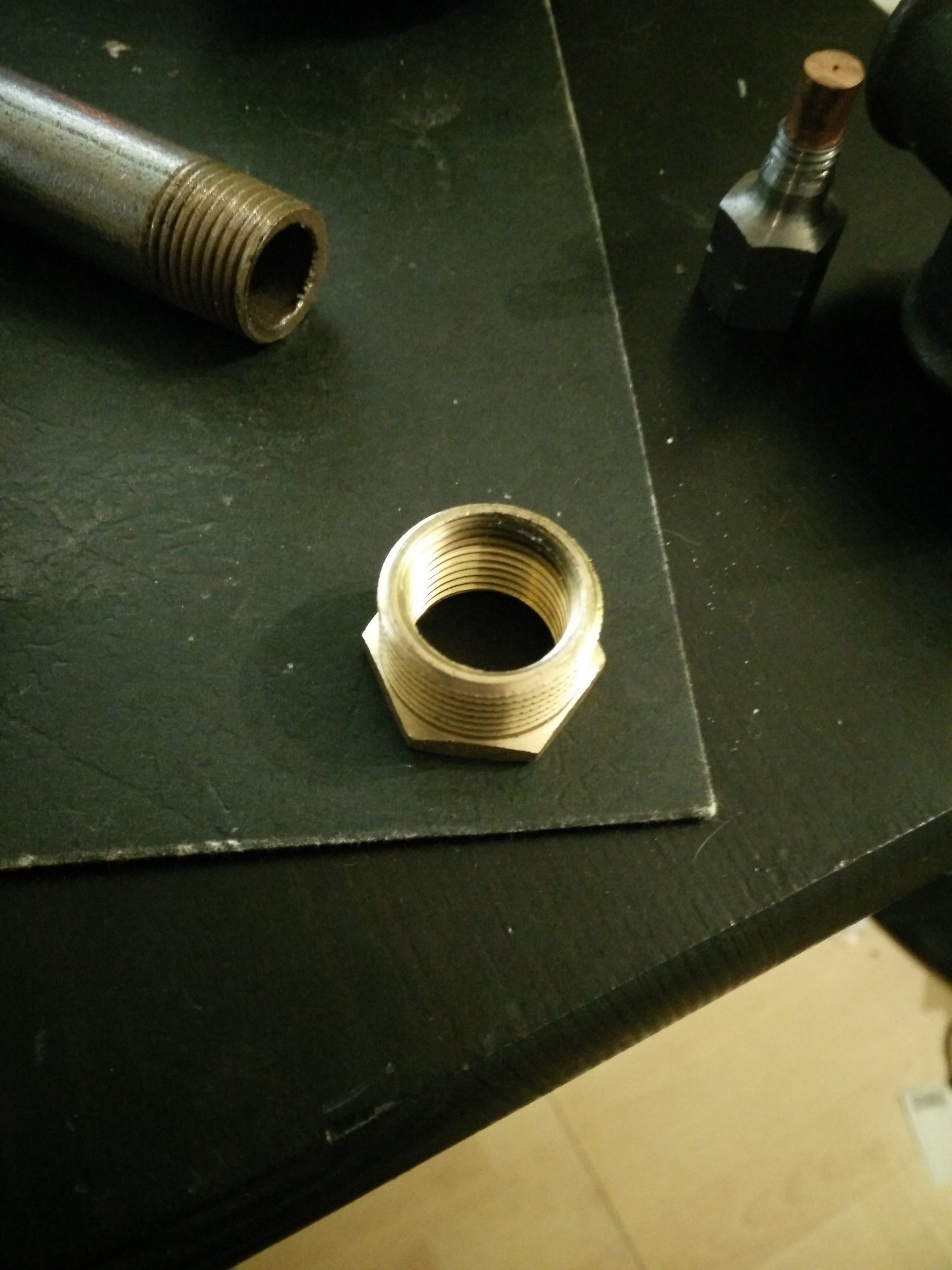

Mike, Timgunn, thanks for pointing that out. I will probably be able to get a a 3/4 to 1/2 to 3/4 inch T when I pick up my propane hose and some other stuff tomorrow. I still have a length of 1/2 nipple left over because I got a long one and cut it off to get the right total length just in case. This means I can test both set-ups I'll show you the results. If I am unable to get the other T I will work with this one and figure something out with what you posted above. In my day job we have a pitfall we call "premature optimisation"(do or do not google it). I am avoiding it now as well more or less. I gather info while I anticipate a potential problem, or am unsure about what potential problems I run into. I build a prototype that works, (with what I know already) figure out what can/should/could be better. (with your help so far ) and fix it. The end goal is always to have something working as good as it can, as good as I can make it. Any comments on above are welcome. I am, for now still waiting for sleep to set in and for the hardware store tomorrow. -

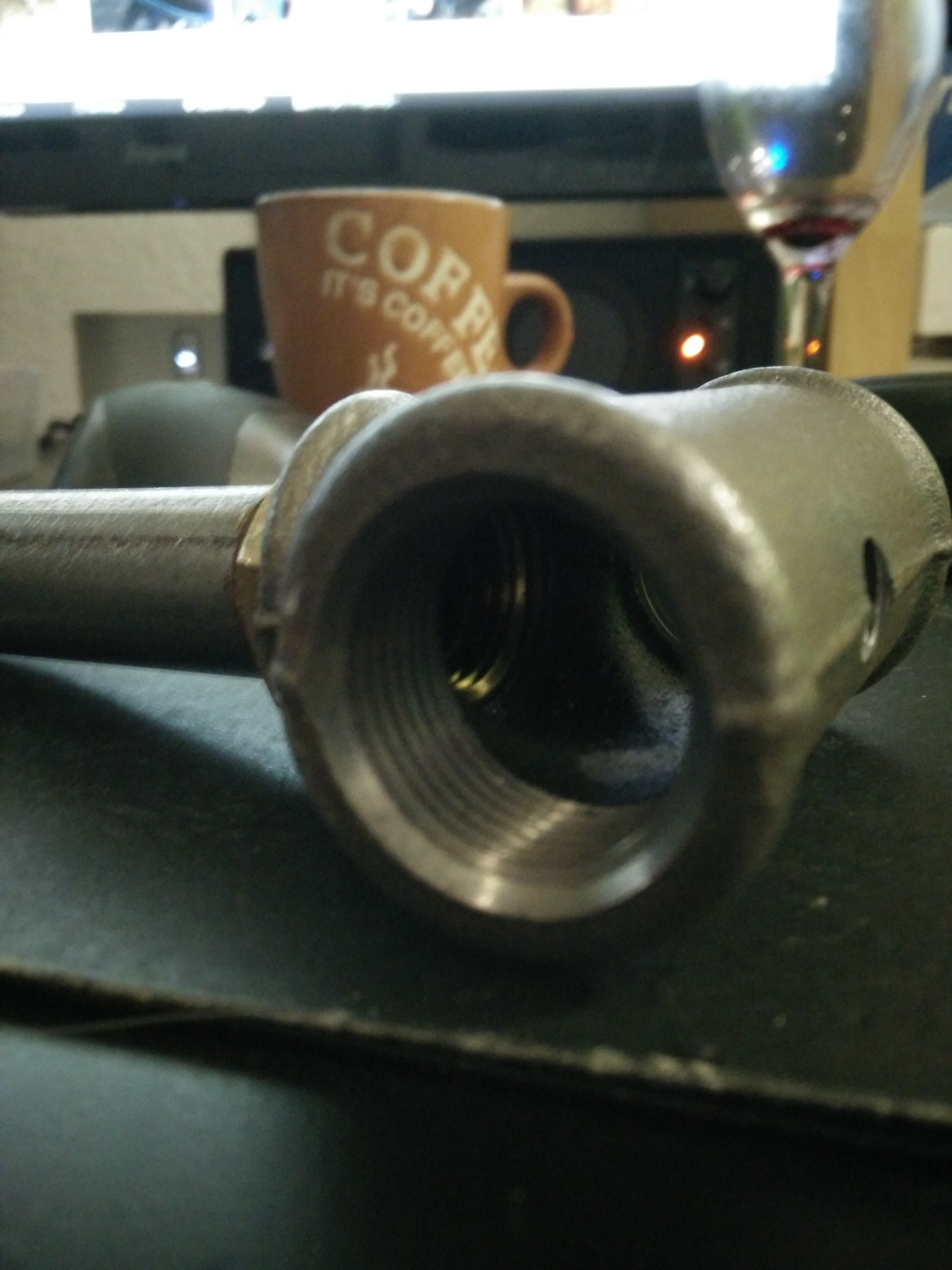

Thanks Mikey, I proceeded and started building a burner. I am going to get the right T next time So I don need the adapters. I'll update this thread when I light it. I am a little worried about the seal on the additional fittings, they seem tight though.The T is 3/4 all round the burner tube is 1/2. I am using a .6 mm MIG tip. For now I need to wait for my day off and get a new propane hose. (The one I got with the tank is old and I don't trust it) -

Mikey and Timgunn; most roofing and welding set ups will be propane, the torch I had was readily available and, to be honest, I did not research enough when I got it. By the time I fired it into the bricks for the first time I already knew it was likely not to be enough. I followed recommendations in this thread and left the orifice on both burners alone. What I did modify is this: It was a bit tricky because I have the opening angled up toward the ceiling of the forge but the circumference of the inside opening is still about the size of the torch end. How it looks in the dark: With flash: And with some blue flame at the front that cleared after moving the brick blocking the back to create some draft: And after 10 minutes: So with the propane it gets hotter and it gets hot faster. I also got my mig contact tips today so I can start shopping for plumbing. @the iron dwarf Thanks. I also found this link seems accurate. I Found the we do have the black (cast) iron pipes here, all measured in inches. Most of them are galvanised but the plain black ones are available as well. Shows that just walking into the store ore phoning them can be more fruitful than searching the web.... Again, thank you all. -
