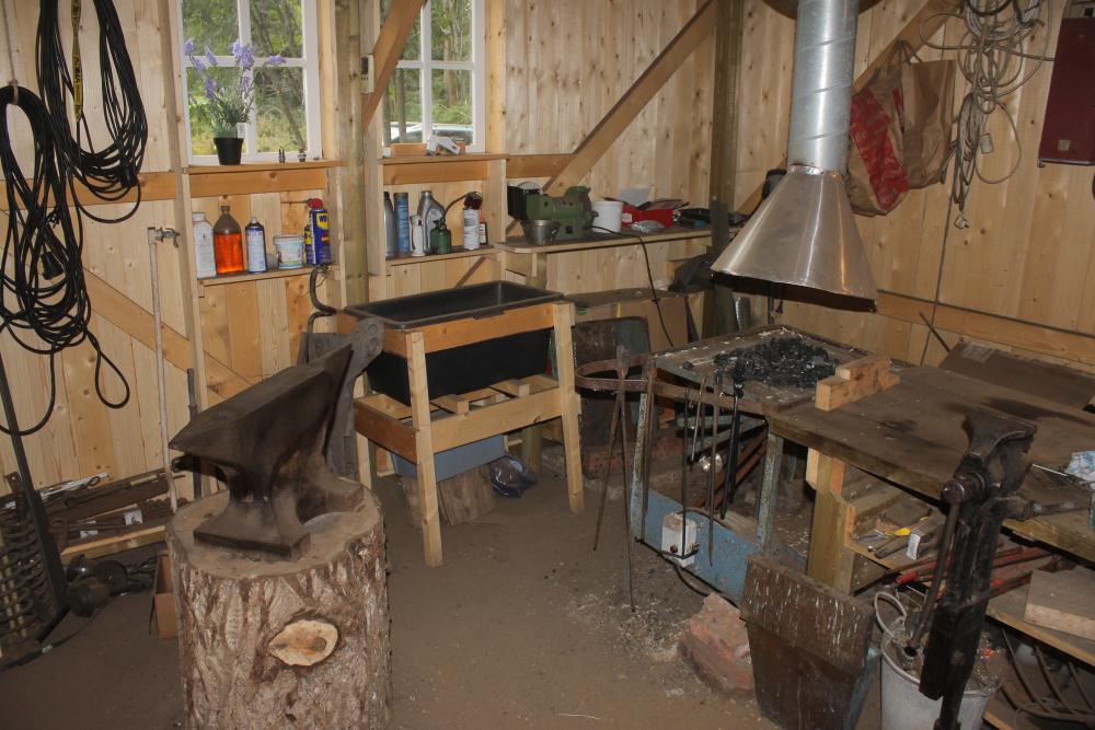

  19. The springs are "stock" that hold "tools" i.e. pieces of pipe I use as levers when bending or tightening. They just happened to be there when I took the picture.
  20. I use the innards of a fire works box to hold stock. The box itself now stores my chain saw chain sharpener so I made a primitve frame from 3/4" board to hold all those cardboard tubes.

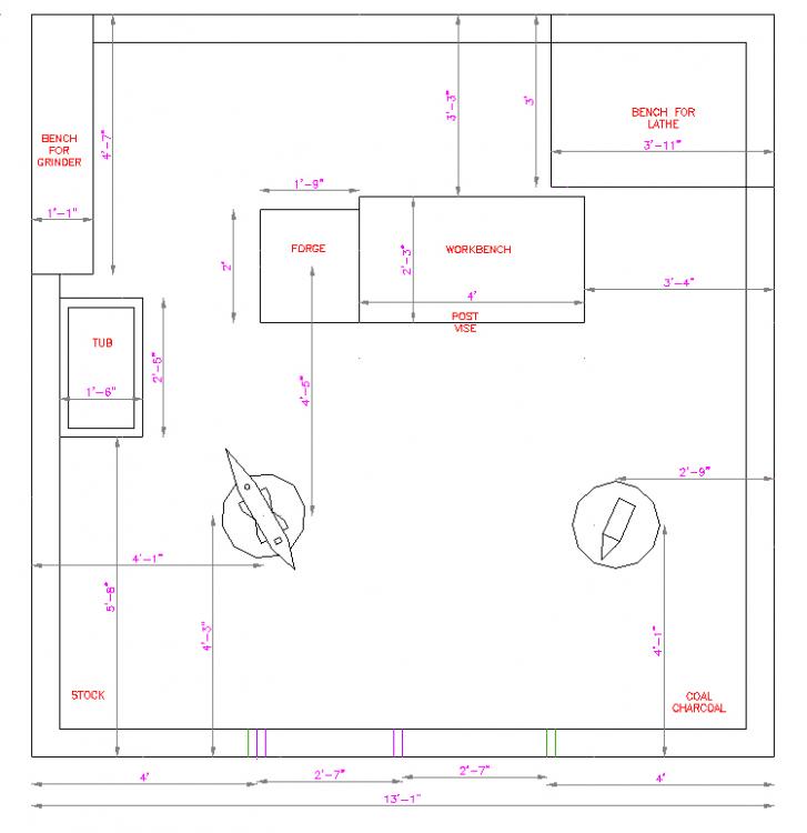

  22. I was perhaps not quite clear, I first tested out the floor plan then I built a shell around. The drawing is just documentation of the result. By the way, I usually put a rim of clay brick around the sides and back of the forge to allow a deeper fire. A coupleof them can be seen below the forge. Dong it that way it is easy to remove one to get a "window" for a longer piece. I think the flowers are a cute touch - especially when they sit in a rather expensive champagne bottle trying to make believe that this is the normal drink on the premises.
  23. Frosty, I appreciate your good intentions in giving friendly advice but this floorplan is the result of my trying out various positions and ending up with a layout that suits me but perhaps not you. A shop layout is never final. The day there is not need to change, it has turned into a museum. The same for a home by the way. Said that, I have used this for soon two years and I have not felt any need to change the central triangle of forge anvil vise. The lathe came in later and forced some moves and I have moved the tub up but that is all. I always work as much as possible with long stock that I can hold in my hand and prefer to have the bench close to the forge since that allows me to use the bench as support for the stock that is in the fire. To me it is an absolute requirement to have the bench adjacent to the forge. There is sufficient space to work the lathe. The only awkwardness is that I have to walk around the benchplusforge to get to the gears but I seldom cut threads so I can live with that. A previous owner messed it up but the post vise is designed to be able to rotate around a vertical axis and one day I will make it do that. For the case you envisage of bending a large piece, I would today bend it in the horizontal plane instead. Re distance to tools, I put the tools I intend to use on the bench so they are close eough. The hotcut lies on a shelf in he wall close to the anvil. Since my stock rests on (a support on) the bench I am free during the heat to move any gadget as required. I always start with an empty bench so anything I need can be put within reach. I am gradually cluttering the walls up but I do not have that assortment of tongs and hammers so many seem to acquire. I post two more pics: #1 from the door towards the left corner showing anvil forge, tub, grinder vise etc (I am looking for a better grinder) Note the piece of wood on the bench that gives support in 1" increments to the cold end of the stock #2 from the anvil towards the lathe showing that and the second vise. You may note that this is not a pole barn design but a cross brace one. This is the normal way to build a country place shed/outhouse here. The colour is very traditional. Cottages for pople have white corners. workshops etc have black.
