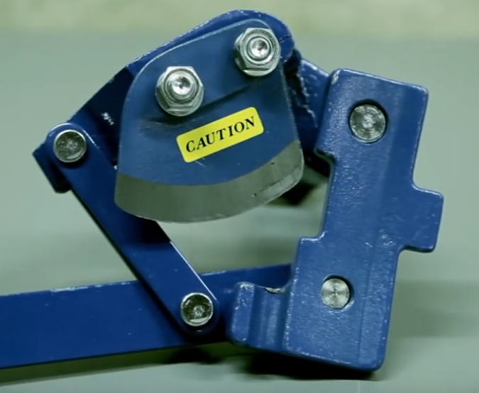

Mystery tongs
The way it works is by holding onto the rolled edge of the drum with the mobil finger and then you push the sharp flat into the top by pushing the handles forward. The other flat is for guide on the outside. Then again it could be to extract Rinoceront molars

Mystery tongs
i think your first guess was right ... a giant tin opener for drums, called a drum deheader. www.youtube.com/watch?v=kichc9RzHew

Mystery tongs
Something about tensioning fencing wire? It's hovering around my memory chamber but does not want to come out ...

Mystery tongs
I remember seeing that contraption before, a long time ago. Looks really familiar but can't remember what it is for. It may come back ... or not. Not tongs that's for sure, so it's in the wrong section. Should be in the mystery contraption section. Whiskey ... don't mind the locals, just do your thing.
