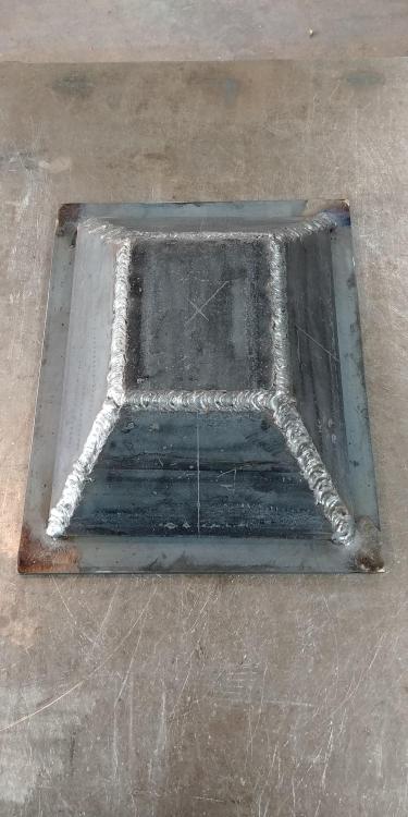

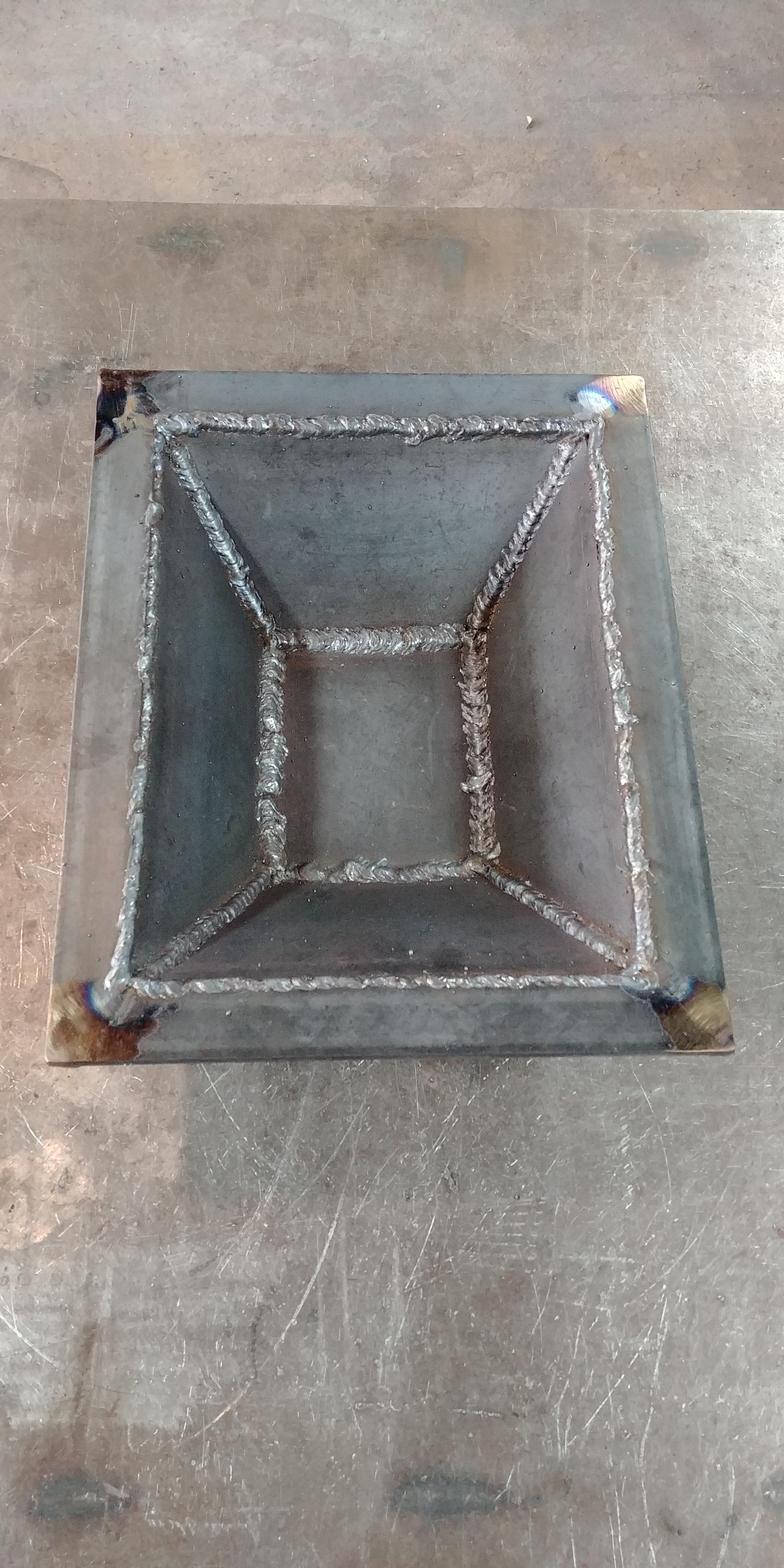

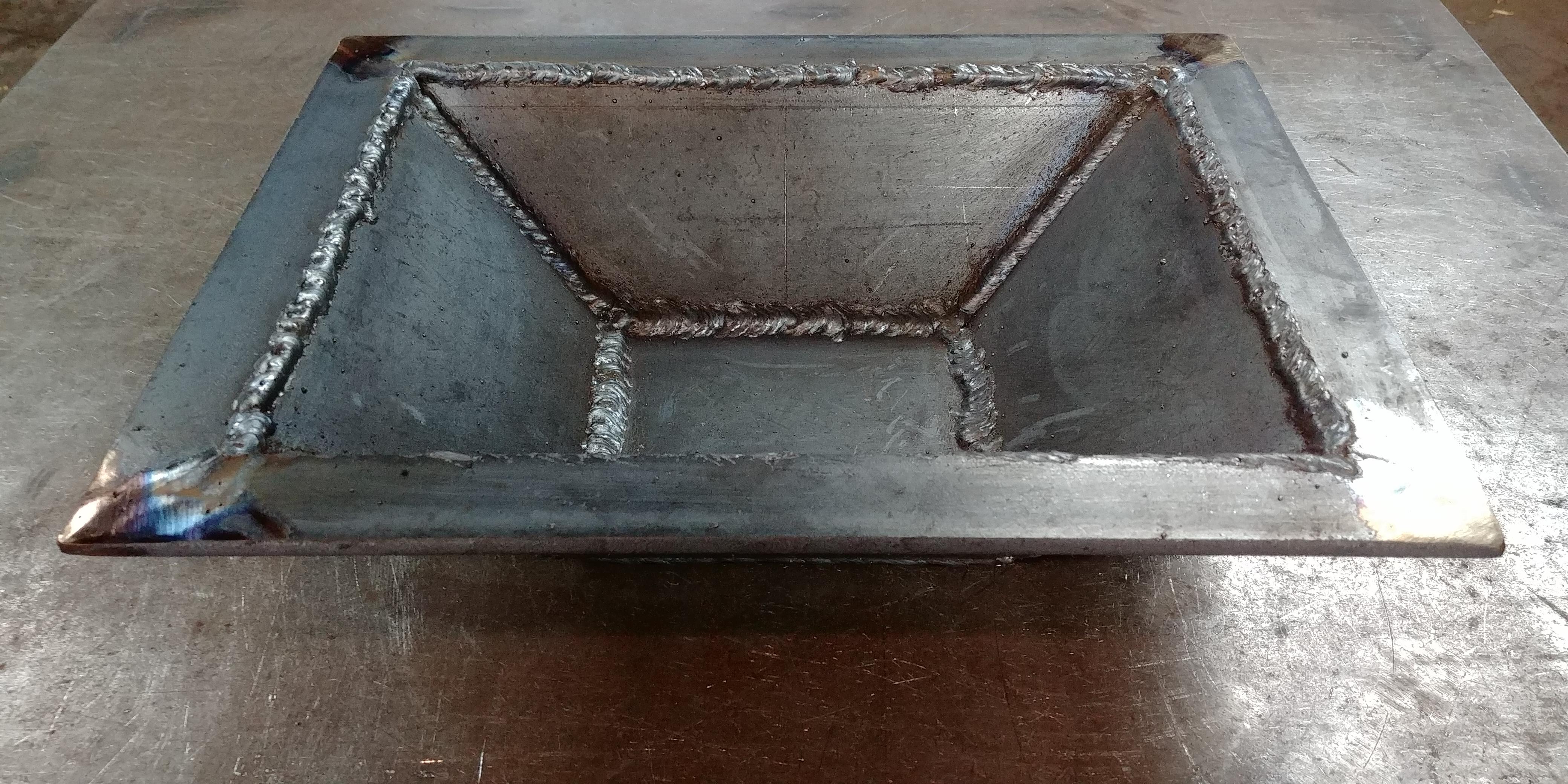

cere19 Posted October 27, 2018 Share Posted October 27, 2018 Just started making my forge today, I'll be taking my time while building it. Today I made my fire pot which is 11.5" x 8.5" and 3" deep. I always like looking at others builds so I will try to update this as I build it. Need to keep my eye open for a hand crank blower, otherwise I'll be making everything else myself. Going to be using coal from the local guild that I took my beginner Blacksmith class at. Link to comment Share on other sites More sharing options...
Marc1 Posted October 27, 2018 Share Posted October 27, 2018 How thick is the plate you used? Link to comment Share on other sites More sharing options...
cere19 Posted October 27, 2018 Author Share Posted October 27, 2018 Plate is 1/2" thick while the top lip is 1/4" thick. Link to comment Share on other sites More sharing options...
Marc1 Posted October 28, 2018 Share Posted October 28, 2018 That should be OK. Make sure you devise a clinker breaker. Makes life easier. Don't go for slots. You can cut a round hole in the base and have the clinker breaker shaft between the fire pot and the tuyere Link to comment Share on other sites More sharing options...
JHCC Posted October 28, 2018 Share Posted October 28, 2018 What Marc1 said. Link to comment Share on other sites More sharing options...
cere19 Posted October 28, 2018 Author Share Posted October 28, 2018 Thanks for the suggestions for the clinker breaker. I was leaning towards one but that just solidified it. I was thinking along the same lines by cutting a round hole and then putting the handle right at the top of the tuyere. Just need to figure out what size to make the tuyere now. Also need to figure what type of material to make the clinker breaker out of and how big to make it. Link to comment Share on other sites More sharing options...
