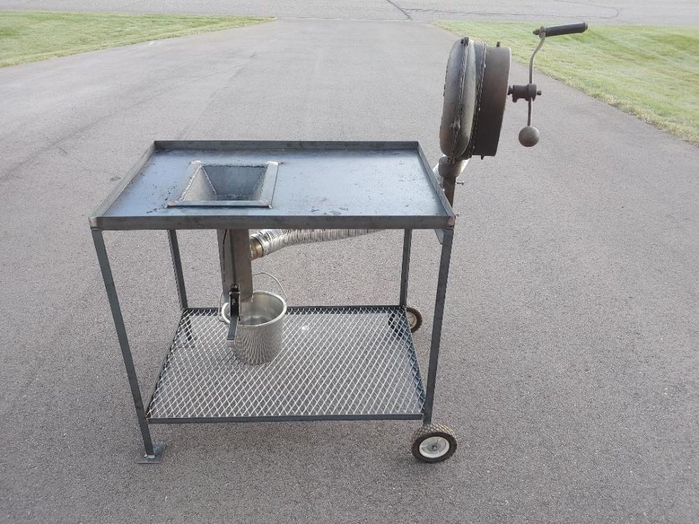

  1. I actually fired it up yesterday for the first time, it worked pretty good and I was able to bend a straight piece of rod for the handle on my forge. I still need to weld it onto the forge, I made this so that I can wheel it outside when I want to use it there's no way I'm running it in the attached garage. I don't have a great anvil yet, I have a section of railroad track that I got from one of the intro to Blacksmith instructors but I haven't made a stand or anything for it yet.
  2. I never realized that it would crank the other way, I'll just have to move the piece that the blower sits in to the middle of the end or cheated a little bit to the other side and it will be good. Thanks Frosty
  3. That's good advice from the both of you, after reading the responses I went out and tested it out. Troubles is I'm left handed so I use my left hand and setup the blower to crank with my right hand. Thing is though the blower itself I feel is designed for right handed people and feels goofy to crank with my left hand.

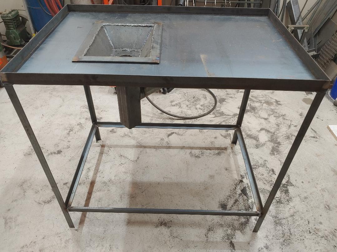

  4. Worked on it today and believe it's ready for it's first fire. The blower puts a good amount of air up into the pot thru the tuyere. You can't see it well but the 1/4" round rod coming down just above the ash dump handle is the clinker breaker handle.
  5. Wow this project got put on the side burner while building a house and now getting back to it. Hopefully I have it up and running shortly and not another year and a half break. Got the basic shape of the forge stand built and bolted the tuyere on. I need to finish the clinker breaker which will be attached to a rod that goes thru the channel I ground out in the tuyere's top lip.

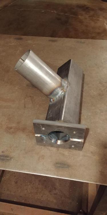

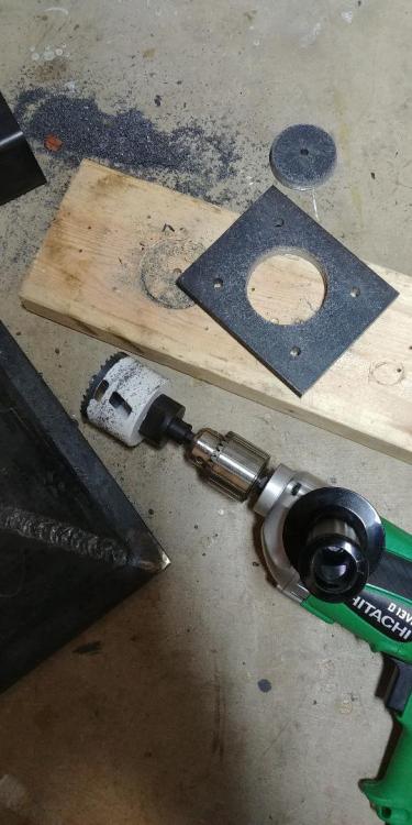

  8. I've made some progress on my forge in the past couple of months, here's some pictures of the updated progress. I was able to drill a 2-1/2" Diameter hole in the bottom of my firepot as well as the piece of plate of my tuyere that will bolt to the bottom of the firepot. I also drilled and tapped 4 holes in the bottom of my firepot for the tuyere to be bolted up from the bottom. There's also a picture of my tuyere welded up, you will see there's a slot I ground in the tuyere mounting plate. I'm going to run a piece of 1/4" round through there for my clinker breaker handle. My clinker breaker will be one of the hole slugs that I drilled out and ground down for approximately 1/4" gap around the outside of the clinker breaker to the edge of the hole in the bottom of my firepot. I need to make brackets and fab the ash dump at the bottom of the tuyere next time I work on it.

  14. Thanks for the suggestions for the clinker breaker. I was leaning towards one but that just solidified it. I was thinking along the same lines by cutting a round hole and then putting the handle right at the top of the tuyere. Just need to figure out what size to make the tuyere now. Also need to figure what type of material to make the clinker breaker out of and how big to make it.
