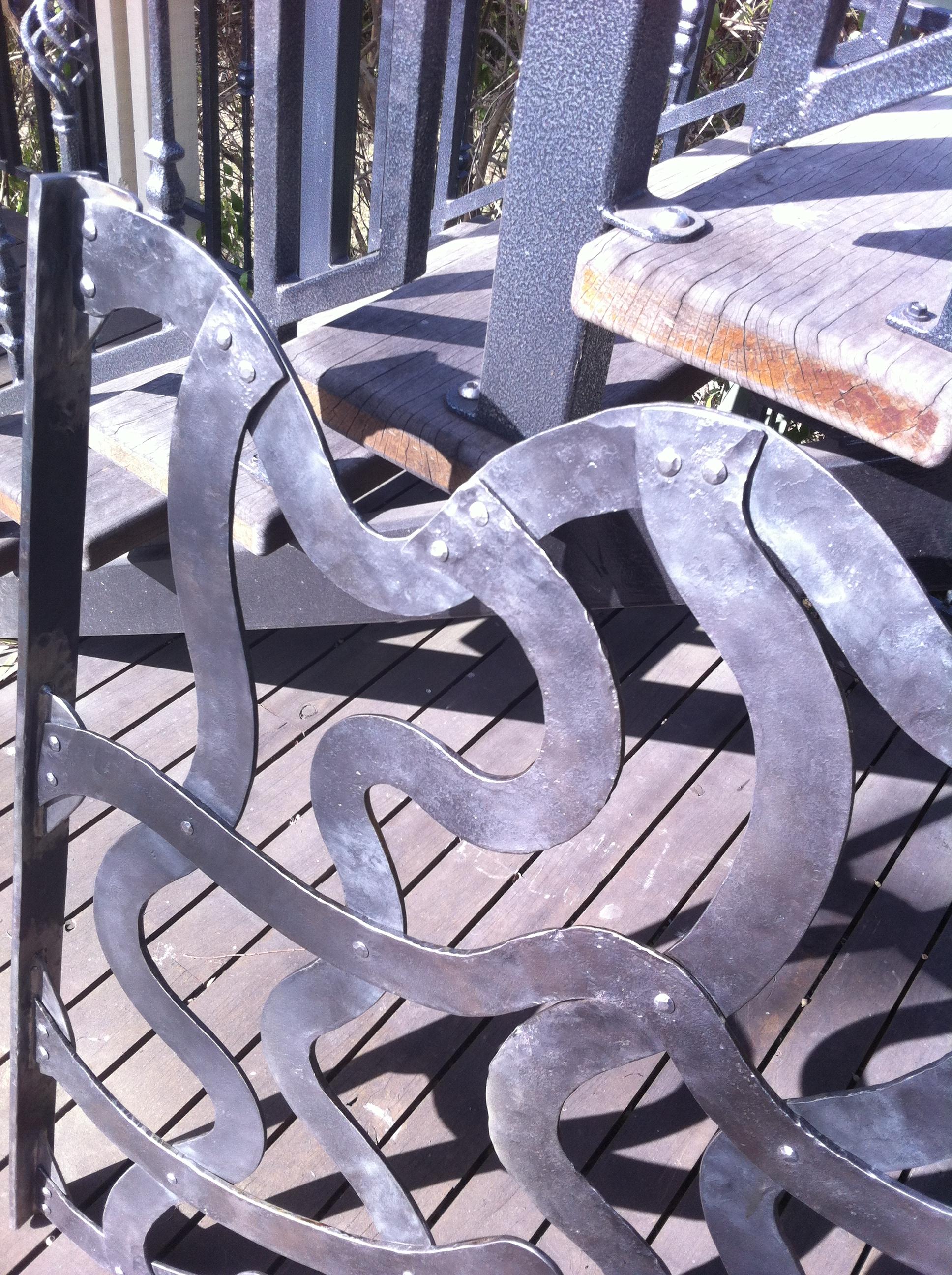

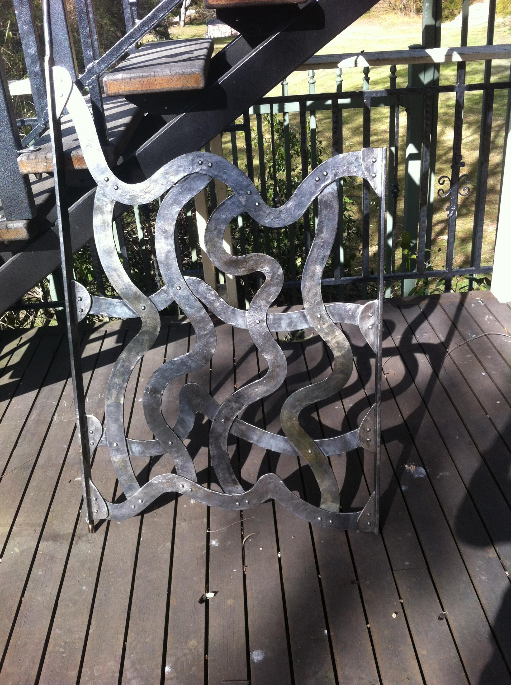

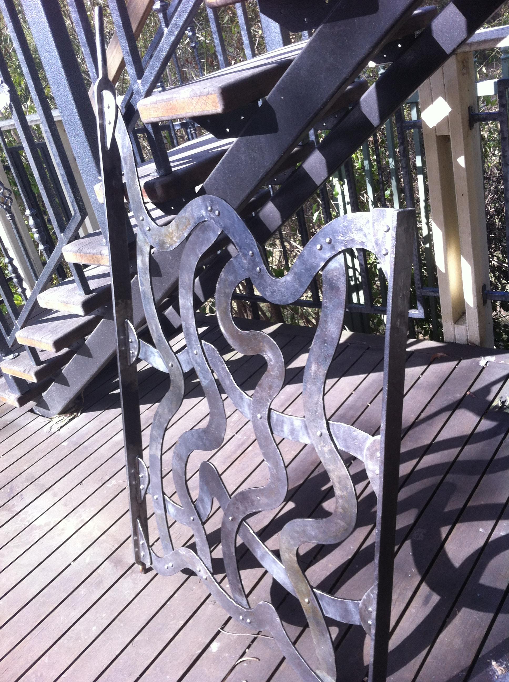

  9. MIG. Next time I'll twist the side bar 90 degree at each point of attachment. Only thought about it when it was too late
  10. Inspired by a gate in Ukraine. Making this for the top of the stairs you can see in the background.
  11. Something different from the usual straight bars. Next is the hinges and lock. Stock is 2"x 1/4" and the sides are 2"x1/2". The hinge side bar is forged down to 3/4" round and the bottom pin goes in a socket and the top will hopefully be a hand holding the top pin. The latch need to be kid safe. I'll figure it out as I go. Another hand would be nice but only if I can actually make one that does not take me too much time. Rivets are round head 1/4 x 1" mild enough to rivet cold.
