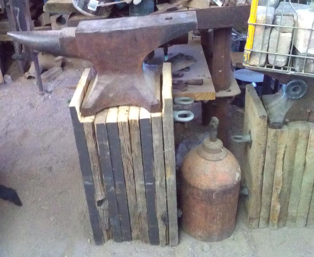

  4. My anvil stands were found or constructed from scrapped dimensional lumber; save for one I got in Iron in the Hat. Have you contacted local tree services about getting a stump? You will need to know the correct height for your use first though.
