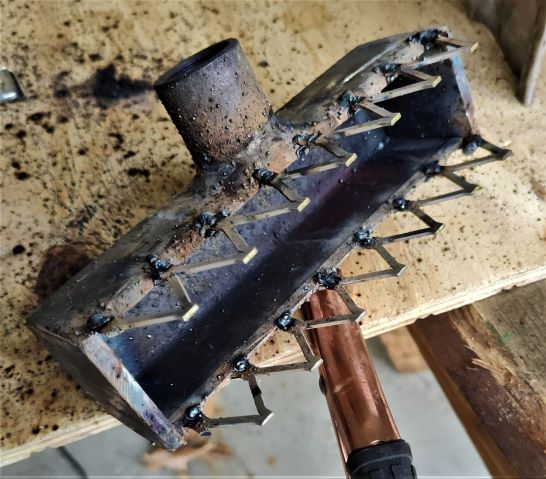

  8. Alright a little progress has been made. I have my plenum welded up. I still need to clean it up a bit. Pay no attention the the exceptionally bad welds. I'm using a $100 harbor freight flux core and I'm not very good with it yet (if that's even possible...) I also spent some time doing some steel barrel cutting, shaping and welding. Ran out of wire so I had to put that on the back burner. All puns aside it's actually a good thing that I had to stop welding because the front and back panels are 2 inches too short. D'oh! Finally I put a t-burner together and tried it in my first tragic attempt at making a forge. It lit up first try and daaaang it roars. I LOVE that. Much better sounding (and hotter) than my cheap chinesium burner that I got on amazon. I didn't have the time to tune it or to let the forge come up to temp so the only picture that I have is probably not enough to really know what I need to do to tune it but there it is. I think that I have been able to combine most of the advice that I have received here into my design. The burner will be bottom mounted facing up at a slight inward angle to increase the distance before impingement on the wall. The forge floor will have around 2.5 inches of the width of the floor raised by about 1/2 inch along the side where the burner will be installed to reduce the risk of debris and flux going down into the burner. I have an extra 2 inches in the bottom of the forge for a layer of perlite. Going with a Frosty NARB powered by a Frosty T burner. The forge box will be 12.5" long and it will be a semi-cylinder with a radius of 4 inches. So the floor will be around 8 inches wide. Minus the raised edge for the burner this will be about 300 cu. in. This will be for blade making especially heat treating so I feel that the low ceiling won't be an issue but I'd like your take on that. So now for my questions! -Casting/curing Kastolite. I intend to be very careful to add water only if needed and only a tiny bit. I am aware of this but I have very little experience in gauging that point where it doesn't need more. Any tips? Also just any tips on using Kastolite? -With my burner being bottom mounted it will be partially imbedded in perlite. I have read that these burners can start backfiring when the plenum gets hot. I have seen a couple ideas that could help like increasing the refractory mass of the multi-hole burner head. O just moving it out further from the forge. Now because I'll be in an extra 2 inches on insulation my idea is to essentially to fabricate and weld a radiator on the back of the plenum to help the heat escape by increasing the surface area outside of the insulation. Does this sound like a bad or a rad idea? I can't see what could go wrong but then... best to ask. As always thank you for your time gentlefolk.

  10. I do have two questions about the NA multi-port ribbon burner that you built Frosty. 1) Do you think that I need to add Zircopax to the Kastolite? I looked up what Zircopax is. I see that it has a very high resistance to heat and chemical corrosion from alkaline. But what exactly does it do for/with the Kastolite? Do you use it elsewhere in your forge construction? 2) In your original NARB post you have some good measurements to start from and the pictures do show a lot but there is one detail that I just can't suss out: How deep did the plenum go into the mold? Or another way of asking would be: How high on the plenum tube ends did you weld the temporary angle steel to hold the plenum in the mold at depth? I'm 10 pages into the 42 page conversation but have not found an answer. I saw someone guess at 1/2" but I don't like guessing when I don't have to. Better to stick with what works like you guys say I would love to read the other 32 pages and I may at some point but... there's no guarantee that the answer will present itself and I need to go to bed today at some point And my wife wants dinner.
