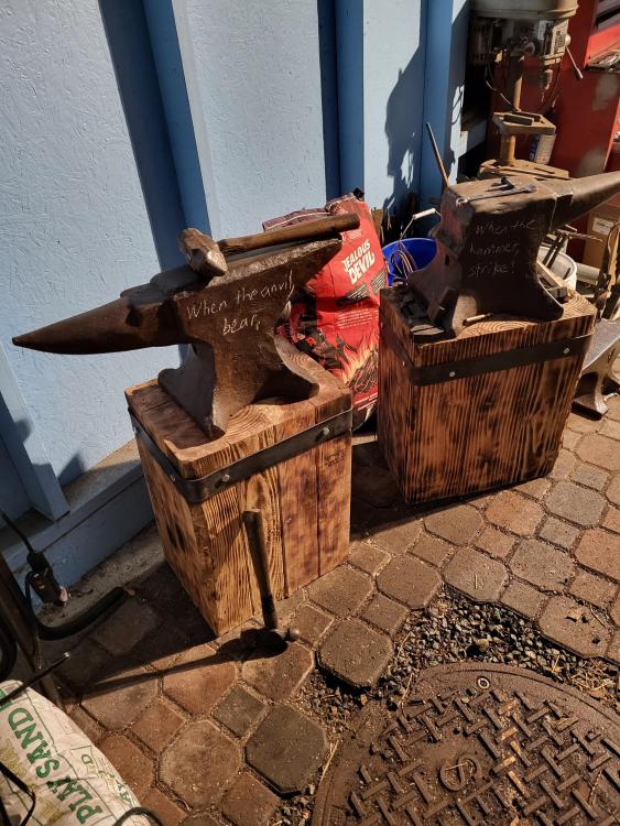

Paradigm11 Posted July 26 Share Posted July 26 I recently inherited a huge, fresh cut pine stump that I'd love to use as an anvil stand because the height is perfect, but I know soft wood is... Well... Soft. Anything I can do to make it take a beating? Quote Link to comment Share on other sites More sharing options...
Frosty Posted July 26 Share Posted July 26 It should work fine without special treatment, you're beating on the anvil, not the block stand. My old stand is a white spruce block and was considerably softer than pine. One last tip, Please do NOT use bolded letters to write the subject of your post. Sure it's attention getting but in an irritating way. Frosty The Lucky. Quote Link to comment Share on other sites More sharing options...
BillyBones Posted July 26 Share Posted July 26 Soft and hard woods is kind of a misnomer. For example balsa wood which is quite soft and light is a hard wood. The hardest hard wood is harder than any soft but there are many soft woods that are harder than hard woods. Soft or hard is the way the resin veins are in the wood not the density of the wood. I use pine 4x4's for my anvil stand. Pine is actually a pretty tough wood or else we would not use it in so much construction. You could make a couple steel hoops to go around the log but i think like Frosty said it will work just fine as is. A plus to the hoops is that you can incorporate some tool and hammer holding hoops, hooks, etc. into them. Quote Link to comment Share on other sites More sharing options...
George N. M. Posted July 26 Share Posted July 26 I've been using the same piece of pine log as an anvil stnd for about 35 years and it is still doing fine. Around here there isn't much hardwood. So, an anvil stand has to be constructed out of steel or dimension lumber (pine) or a pine stump or log. Putting steel bands around the stump or log is not a bad idea although I have done that to mine. "By hammer and hand all arts do stand." Quote Link to comment Share on other sites More sharing options...

Frosty Posted July 28 Share Posted July 28 Ahh, the distractor is gone we can get back to Paradigm 11's original question by. Your pine block will be more than stout enough for your anvil stand. No mere mortal is strong enough to damage it swinging a hammer at the anvil. You are good to go. I don't recall if you've shown us a picture of your anvil. Please? Frosty The Lucky. Quote Link to comment Share on other sites More sharing options...

The Jeff Posted July 29 Share Posted July 29 22 hours ago, Frosty said: Your pine block will be more than stout enough for your anvil stand. I agree with frosty. You will be hitting hot metal on the anvil, not beating the stump. Quote Link to comment Share on other sites More sharing options...
528E12 Posted July 29 Share Posted July 29 both will burn. If you don`t like it , make firewood and start over. imo if the shop floor is dry, it won`t make too much difference. Rot has been one reason my previous wood stands were replaced. Personally I like heavy stands ( not if you need to move the anvil a lot) Oak would be my choice, but i use steel nowadays. Quote Link to comment Share on other sites More sharing options...
Paradigm11 Posted July 29 Author Share Posted July 29 On 7/26/2024 at 3:38 PM, Frosty said: It should work fine without special treatment, you're beating on the anvil, not the block stand. My old stand is a white spruce block and was considerably softer than pine. One last tip, Please do NOT use bolded letters to write the subject of your post. Sure it's attention getting but in an irritating way. Frosty The Lucky. I apologize, I was on my phone when I posted it and did not intend to do so! As for the anvil and stump, here is the most recent pic I have of both: The anvil itself is probably in the 60-75lb range. I got this one for free and eventually will be getting a less well loved one once I finish my little forge area (which is this crowded little place). Some of you may remember my post from last year of me building a little forge area. Still working on it, but it survived the winter with flying colors. Frosty was very helpful in that thread as well Quote Link to comment Share on other sites More sharing options...
