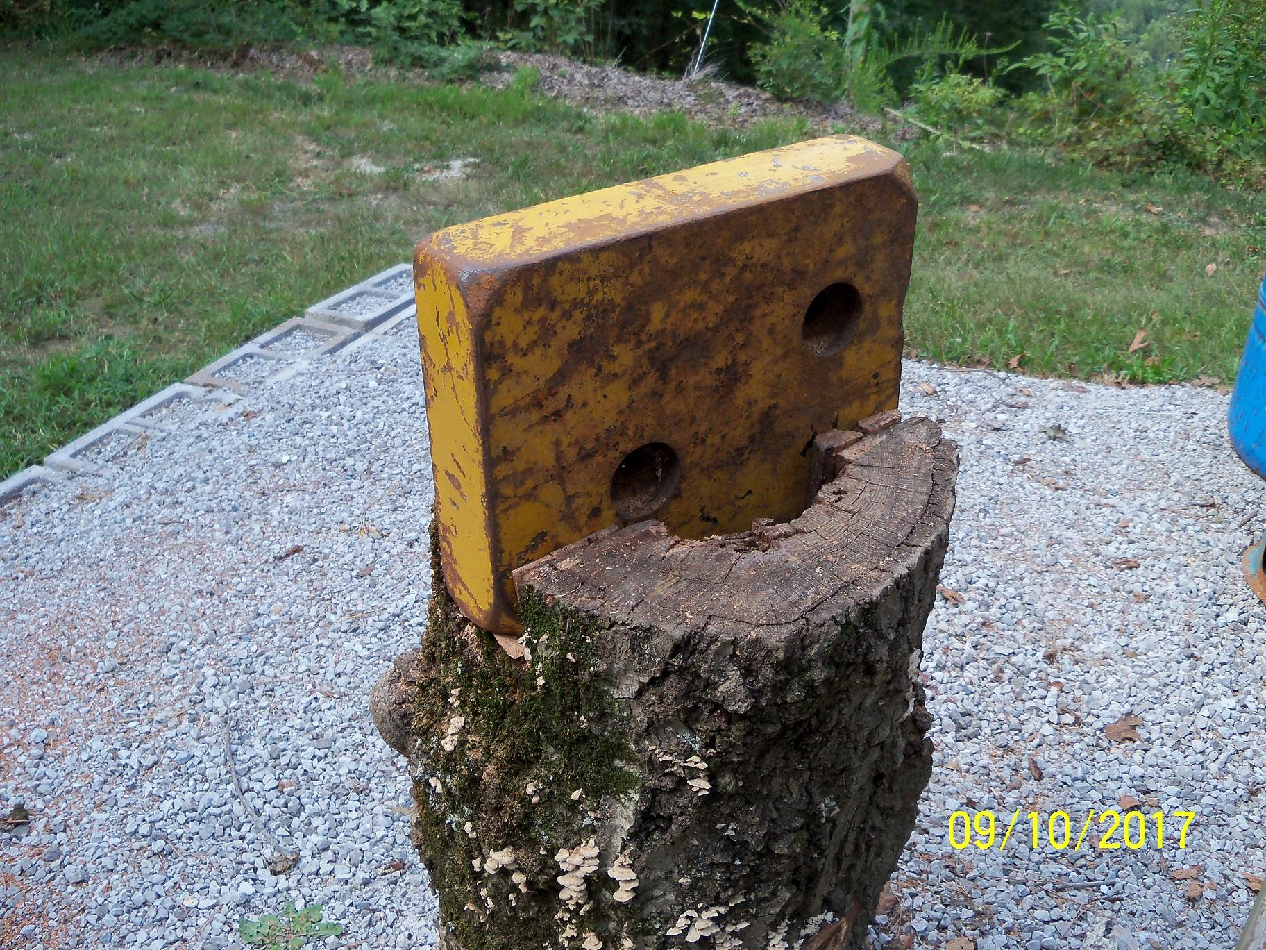

Counter weights from tractor's, bulldozer's and other heavy equipment make excellent anvils. I picked up this one at our BOA meeting for a very good price and it weighs 110 pounds.
You can even make tools to use, this one is a small bick made from sucker rod.

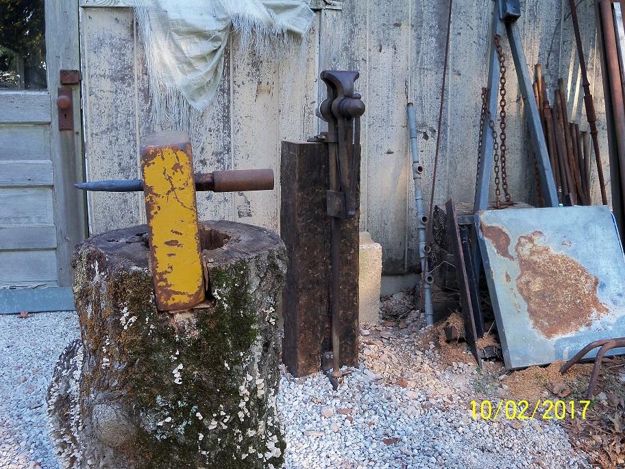

Easiest thing to find and get to use as an improvised anvil in my opinion is the biggest sledgehammer head you can find. You don't even have to remove the handle if it has one. If not in fleamarket or yard sale season, look into second hand stores for inexpensive ones. You could get one with or without a handle. Then when you mount it on end and start forging you can take your time and look for a good deal on something bigger, better.
The sledge hammer head is a pretty good idea. John Switzer (Black Bear Forge) just put out a video on that not too long ago. It apparently makes a pretty good stump anvil. I would imagine it would help with learning hammer control as well. The scrap yard near my house wouldn't let me look through their stuff but I found a loophole. Try taking a load to sell to them and while they are unloading root around. The workers don't seem to mind and they will usually sell you whatever you want. You can also ask them if they have anything in particular and they will usually tell you and sell it to you if they do. The upshot is, they dig it out and load it for you.

You are only moving metal the size of the hammer face so a sledgehammer is generally larger than that. In practice it works. With a look through the improvised anvil thread one can learn a lot.

The axle idea works well if you don't mind the small face. I don't disagree with the counterweight idea, with one caveat. Some of them are made of cast iron, which is a terrible thing to discover after lugging one home. You can find out which ones those are very easily though, they make more of a dull thunk than a ring when you hit one with a hammer.
We made a base/stand for a 12 lbs sledge hammer head, using high density MDF(?). We screw the base to whatever we are using for a base stand. The first time we used it, we used 12"x12" blocks, about 24" high. We did a Demonstration for CanIRON on-line in 2021, 'How to start into Blacksmithing, with nothing'. We used a Wood fired Forge, hair-dryer for a blower (with a reostat on very low). Sledge Hammer Head Anvil, Claw Hammer and Vice-Grips for tongs. It works actually very well, K.I.S.S. When you have nothing, you use what you can find, for cheap. There are no Blacksmith Police, so they aren't coming to take me away, Ho, Ho, Ha ha............wear life is beautifull............

A sledge hammer head makes an excellent anvil, even today top of the craft Japanese bladesmiths use block anvils a few inches square, sometimes spiked into a block of wood, sometimes mortised at a height to work kneeling or sitting. I kind of take exception to the label "stump anvil" with rolled :rolleyes: eyes. does mounting my anvils in a round out of a tree trunk somehow make them not anvils?, I'd like to see a more effective anvil than my 125lb Soderfors or 206lb Trenton before I made the steel stands. The steel stands are easier to move, work close to and more stable than their old wood stands. About the only real performance advancement is they're MUCH quieter and no, the anvils are sitting on clean angle iron.
