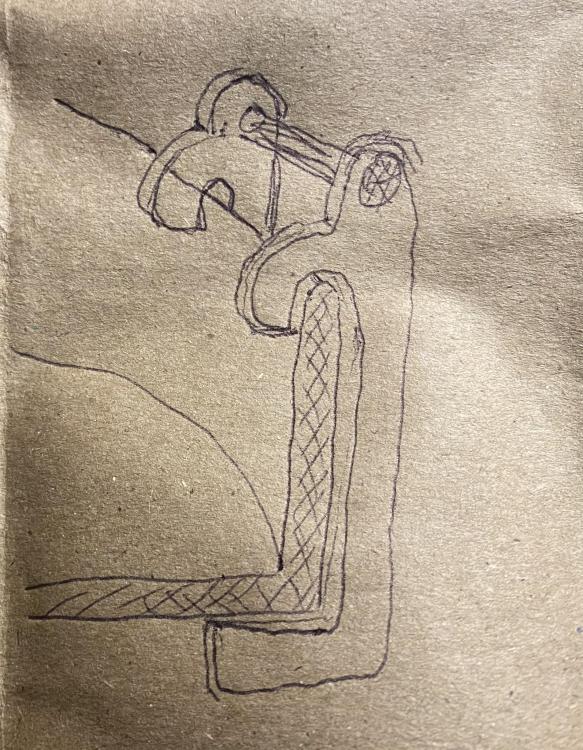

handle for giant iron skillet
Looking for a suggestion on putting a handle on a very large cast iron skillet that was cast by a family friend at the foundry here in town about 15-20 years ago.
It's around 33" across, and about 3.5" deep with a single small pour spout.
However, there are no lugs, handles, holes, or any way whatsoever of mounting a handle/bail/grips. As well the edge is of varying thickness from a strong 5/16" in some places to as thin as 3/16 in others.
It's going to be used on an outdoor stove in the pavilion or over a fire ring due to its size so any way of handling would be fine.
I'm a bit concerned about opposing handles potentially breaking the rim when it's picked up and even moreso if I hung it from a bail like a kettle, so I was considering just making a frame for it to sit in without bolting/ riveting it in so it could be handled without stressing the cast iron. The cast iron is of unknown alloy btw, it is probably ductile as that's what they were casting at that time but it's possible that it's basic grey iron, so I'm going to assume it's grey.
Any advise or experience on the matter would be greatly appreciated
Thanks~

Rather than making something to attach to the pan, why not make a separate cradle/ handle kind of thing? Top of my head, I see flat bar in a cross shape, joined with a riveted offset, wrapped up the  sides of the pan, with a handle or handles , maybe wood. Or a double flatbar hashtag shape, offset and riveted as above. Or a cradle of some kind, with a bail type handle. Just spitballing here.

Stash: that's more or less what I had in mind. A cross of bars or perhaps a ring as a cradle with the handles or what have you attached to it instead of the pan
You could make a pair of handles like this, that would hook over the rim but support the weight from the bottom:
A handle or bail to connect two handles would enable you to hang it from a crane.
Otherwise, I think your best bet is to make a three-legged stand to hold it over a the fire.

JHCC: I dig that idea, makes me think that maybe the trick would be to just build a spider type stand and handles that just grip when needed and come off otherwise, kind of like lid lifters for dutch ovens or those removable handles for grill skillets

I think I'd just roll a ring to fit around it just below the rim from say 5/16" x 1 1/2 or maybe 3/8" x 1" Roll the ring to fit the side a little more than the stock's width below the rim. Then stretch one side only on the anvil horn till it slips on and matches the pan's side. Does that make sense? It's the easiest way I know of to make a truncated cone like the side of a frying pan.
Then of course attaching lifting lugs, handles, etc. are as easy as welding a bead or drilling and bolting them on. I like the idea of using thicker stock so I could bolt different things to it with runner bolts for different occasions.
