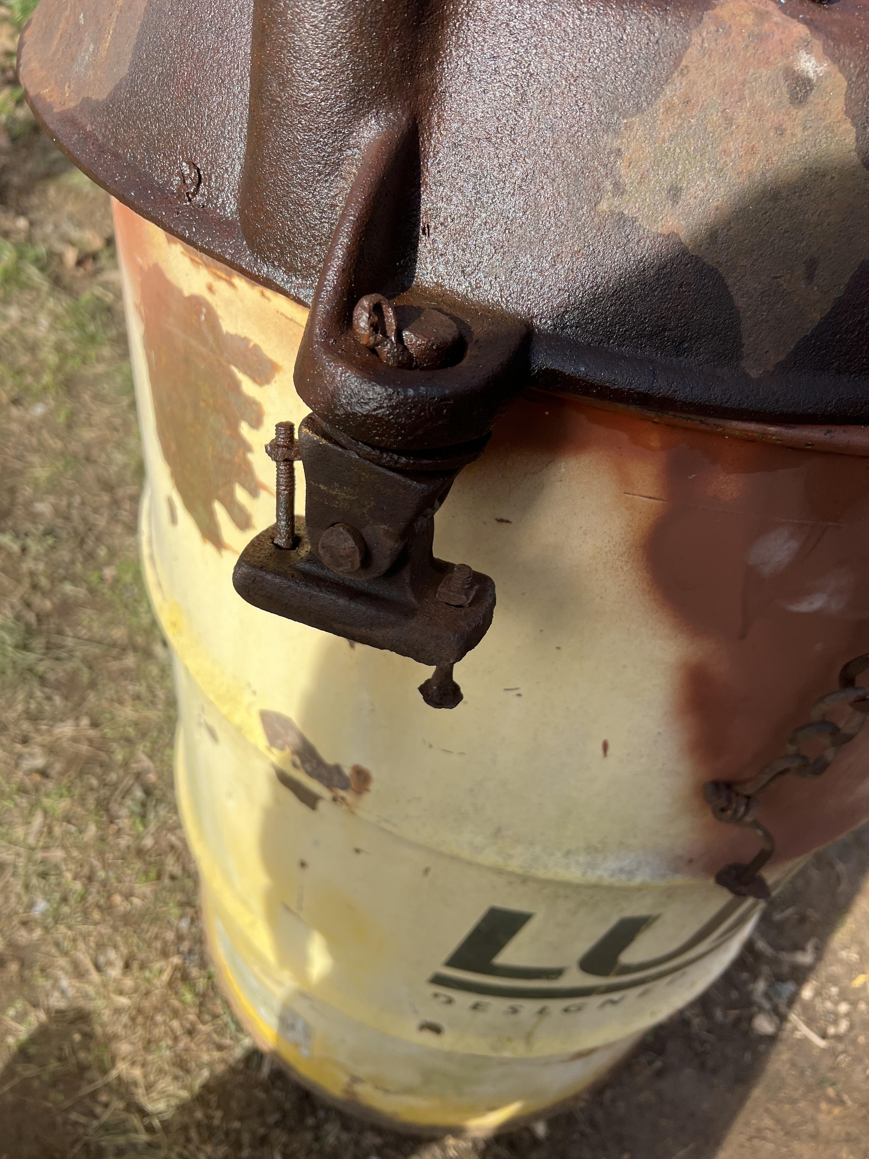

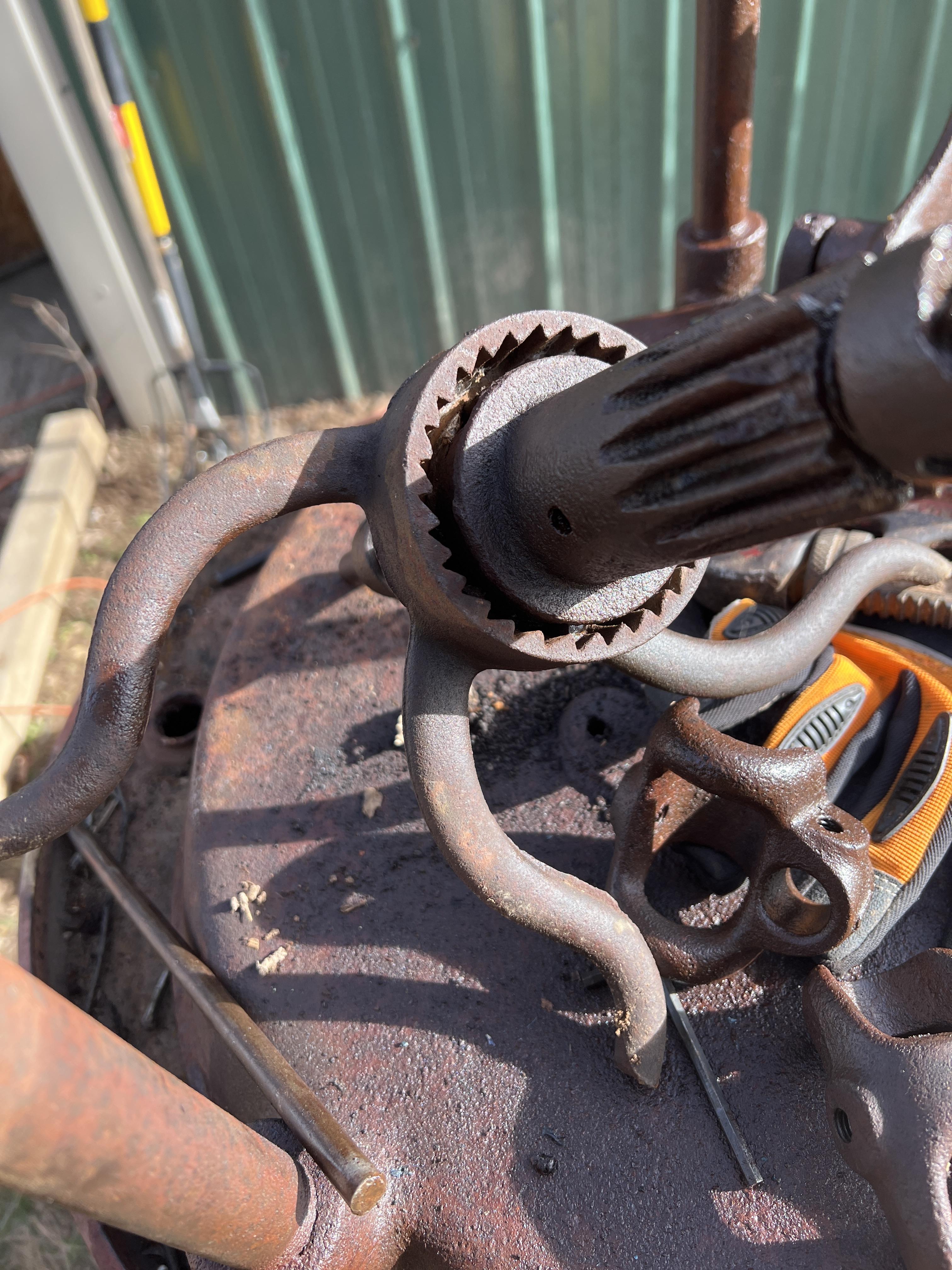

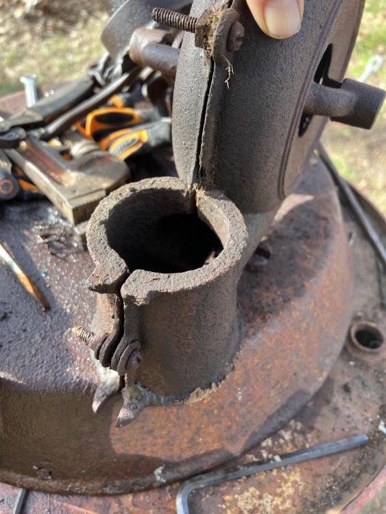

Okay bought this forge from Twisted (awesomes guy). He didn't think the original blower could be rebuilt, I think because the flywheel pulley was broken.  I found that whole assembly for the flywheel and clutch online for sale for about 86.00 shipped. So do I restore the forge or not.  image.thumb.jpg.2538879fd2935b4b9c38bf03283c308c.jpgimage.thumb.jpg.deddfe42eceeaabf15e919cfaa4615b1.jpgimage.thumb.jpg.712eb03398956920e51318ea66600000.jpgimage.thumb.jpg.056c94cfe46003f6f352c8f721f1bbb0.jpg
If that's your thing, why not?
I wouldn’t bother with all that,
that blower assembly has more wrong with it then just the flywheel, and even in tip top shape those lever blowers aren’t all that great,
that forge body on the other hand is in excellent shape!!! and you already have a working Buffalo blower ready to use now!!!
I would just make an adapter plate to match the existing holes and then attach a tuyere to the plate and your off to the races
I’ve seen other folks here on IFI do really cool retrofits using a good rivet forge body
you might run down to the scrap yard in stilwell tomorrow and find a plate with pipe already welded to it ready to bolt up for $.20 a pound!
sometimes I luck out and find the perfect part for a project down there just laying in the dirt!
Don’t forget to clay it before firing or that excellent forge body can possibly crack on you
I pretty much agree with TW.  I think that, generally, the cranked blowers work better than the lever type.  So I would not go to much effort to try to restore the clutch, etc. and would just hook up an ash trap and plumbing to use the crank blower with the existing body.  That will get you forging fastest.  Ususally, that is the point to where we want to get.  We restore old machines and equipment to get forging and because it often works better than the modern versions, e.g. a Champion or Beffalo blower vs. those sad little short handled blowers they use on the I Forge Iron TV show, because most of us cannot afford the barnd new, bright, and shiny new stuff, and because the old stuff is esthetically cool and we get satisfaction from using tools that were working before our grandparents were born.  But getting to the point of getting metal hot and hitting it with a hammer is the primary motivation.
I have a theory about the lever type forges:  When rotary blowers were introduced in about the 1890s almost all smiths were used to pumping a bellows lever with their left hands.  Turning a crank was new and didn't feel "right."  So, the lever type forges allowed a smith to still use the up and down motion he was used to.  I have always used a hand crank forge and now, when I use my propane forge it feels a little weird not to be moving my left hand in a circle while the metal is heating.
Sound advice,  I was curious on the forge after I bought it, so i looked it up, and stumbled on the broken pieces on line, so it got me to wondering.  I am going to get this thing going with the hand crank, but will save the parts, maybe down the road sometime i can always go back and restore for the novelty.  For now i am going to just get it up and running, dont worry i have not forgotten about the clay.

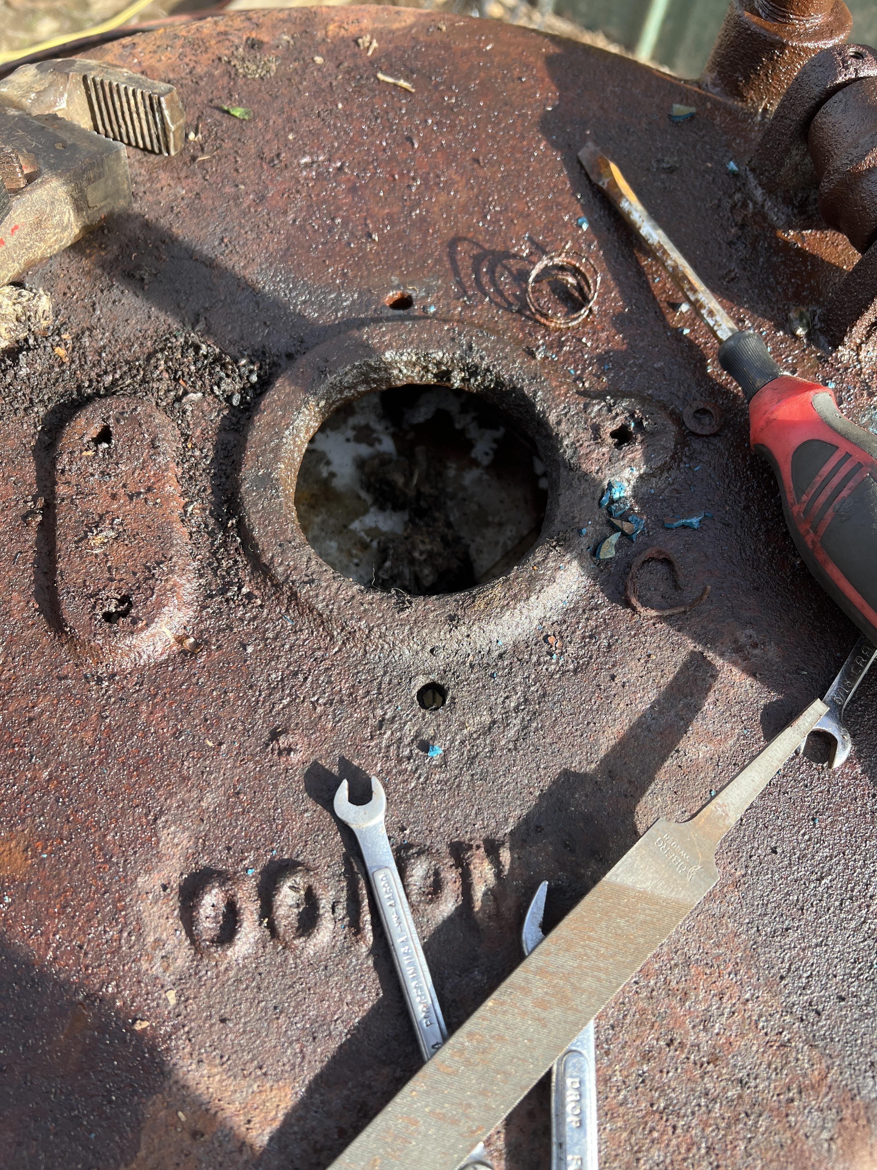

Well I am getting along on setting this forge to go!  Not laughing at my welds, I found out I am not as good a welder as I once was since I have not welded anything in about 20 years.  Those nasty looking welds did pass the beat the heck out of them with a heavy hammer test and they held... but this will bolt up under the forge, and instead of trying to find a 6 inch drain grate I just cut and drilled holes through to the ash dump.  Now I just need to weld on a hinge plate for the ash dump.. bolt on this lower assembly, clay in the forge body, and I am good to go!  I hope....
If you end up using coal then Your gonna need bigger holes in the tuyere grate, you won’t get enough air flow through that to effectively forge,
that said it should work decent for Charcoal if your goin that route,
Thank you Twisted!  i was wondering if i was going to need more or not,  so tomorrow i will grind out more slits to increase the air flow.  I have my clay mixed up as well and sealed in a bucket.  so once i have it installed, and the linseed oil drys, I am going to clay in the forge as well, i might send you a pic once i have worked on increasing the air flow.  i do want to use Coal.  That day at your forge, i have to admit, i love the smell of coal.  I still need to find a vise, hate to say it but that is on top of my next to buy list. I have even looked into what it would take to make a homemade version of a post vise, but will have to work on my welding skills some more before i tackle that.
