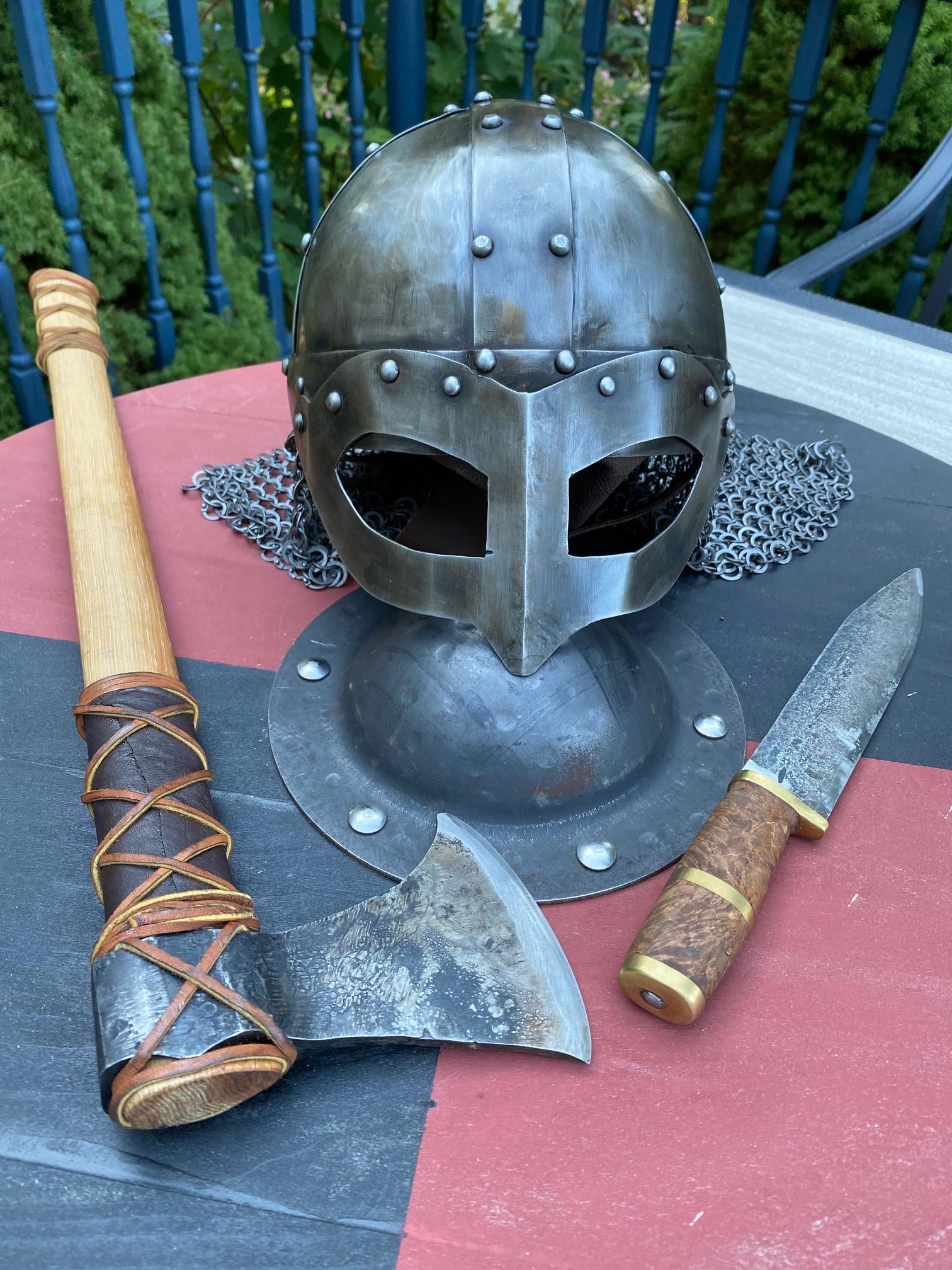

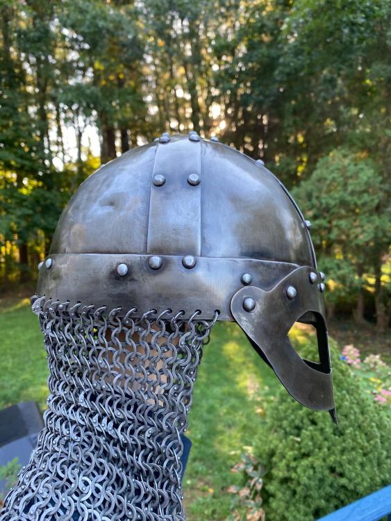

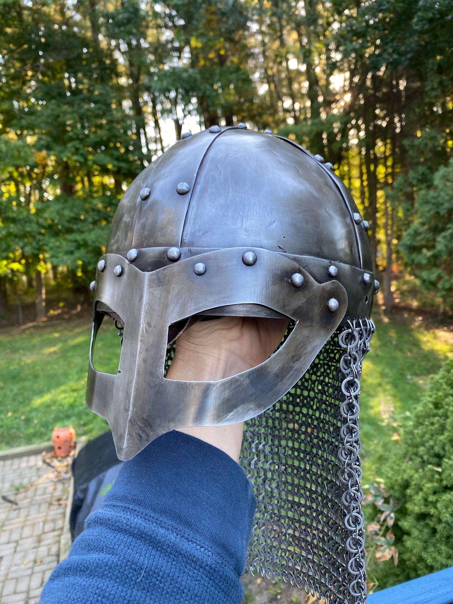

Cavpilot2k Posted October 29, 2022 Share Posted October 29, 2022 Made this to complete my Norse Karl Viking kit. I want to make some additions to the aventail to help it lay better on the shoulders, but I was under a time crunch to finish a workable version. 16 ga. mild. Also the battle axe is my own build - mild steel body with spring steel bit. The seax too - brut-de-forge blade with maple burl handle, brass spacers. Quote Link to comment Share on other sites More sharing options...
anvil Posted October 29, 2022 Share Posted October 29, 2022 Very nice! Especially for your first. Quote Link to comment Share on other sites More sharing options...
Cavpilot2k Posted October 29, 2022 Author Share Posted October 29, 2022 Also, instead of a polished finish, I wanted an antiqued finish. Accomplished by using SuperBlue and immediately scrubbing it off with an abrasive pad soaked in acetone. My idea was not some pristine piece that has never seen use, but the helm of a seasoned warrior. I can't stand new armor that looks like it's never been used in earnest. Quote Link to comment Share on other sites More sharing options...
