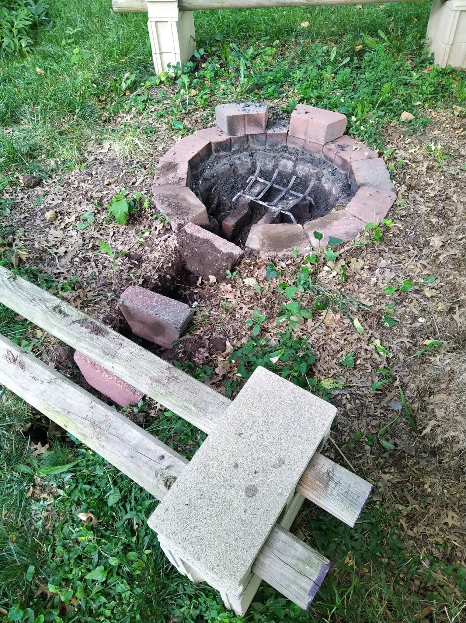

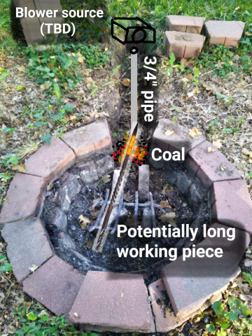

I'm interested in the JABOD forge to use with coal/coke. I already have a 3-ft wide in-ground brick-lined round firepit that I made about 10 years ago. I've recently dug a trench leading to the pit in anticipation of making it dual-purpose and setting up a section of it for forging. The trench was intended to hold the air intake pipe but maybe it's better to use the trench as the forge? (picture attached, pavers on top of trench just for safety until it's covered.)
Everything I've read in the JABOD thread showed the "pot" as ending level with the top of the box, and then the coal pile mounded about an inch or two above the top level. With the depth of my firepit, the coal pile would be below ground unless I raise that portion up with bricks or something. Will it work below ground level or do I need the air above ground combined with the intake air to make it work?

The issue about the depth of a solid fuel forge has to do with the relationship of the workpiece to the fire.  If you are just sticking the end of the work piece into the fire you can do that at an angle.  Think of the fire in the bottom of a bowl and the work piece is slanting down from the rim of the bowl.  However, if you want to heat the middle of a piece a deep "bowl" becomes a problem  because you have to lay the piece across the top of the bowl, rim to tim, and the fire is too far below to heat the work.  That is why many coal forges are either pretty shallow, so the fire extends vertically above the level of the rim or have cut outs in the rim so that a long piece of work can be set down into the fire.

Welcome aboard, glad to have you. Rather than trying to modify the pit into a problematical ground forge you've just about finished a truly ancient proven ground forge digging the trench for the air supply.
If you cut a narrow trench at 90* to the large one angled downwards and drop your air pipe into it protruding SLIGHTLY into and an inch or so above the bottom you'll have the ground version of the JABOD. Not an ideal version but good enough to start forging with. Cook lunch or pyrolize charcoal in the fire pit. That thing will burn 10x as much fuel as you really need while baking you like a potato.

Before I start digging more, I want to make sure I understand you correctly.  I thought what I had was already pretty much the ground version of the JABOD. I'm including two pictures. One the way it is now, with labels indicating where stuff would be. The other with how I understand your suggestion to be.  Is your suggestion for the additional trench just so I don't have to use any part of the existing firepit? I wasn't intending to use the center of the firepit for the forge - maybe that wasn't clear at the beginning. I was going to use a section on the side.
