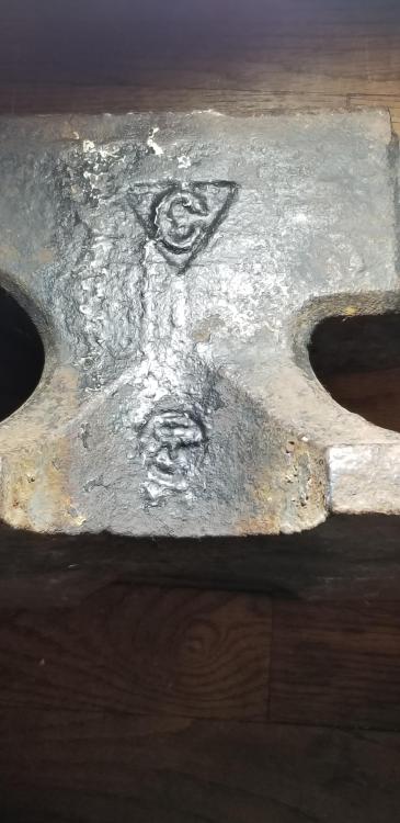

Did I do good?
I came across this anvil and picked it up for 50$. I am just getting into knife making and a little uneducated on anvils. I appreciate any feedback that's how we learn ask those that know.
It's looking decent, have you done a ring and rebound test to determine the quality?

From what I can tell from the photos that looks like a good usable anvil.  How much does it weigh?  To tell how good it is you need to do a bounce test.  Drop a ball bearing of about 1/2" to 1" diameter from 10" above the anvil and see how high it bounces using a ruler.  Anything around 80-90% is very good, 60-70% is OK and 50% or less is pretty poor.  I wouldn't buy anything that had a rebund of less than about 60%.
Also, do NOT do any grinding or polishing on the face of the anvil.  Use will polish it up.  Anvils have a plate of tool steel on the face and sometimes it is pretty thin.  Anything that removes any portion of the face is a BAD thing.
Could you take and post a better photo of the logo on the side and any other marking aon the anvil, please?

It’s a Columbian they are cast steel, very good anvils,
You did pretty good for $50! I’d say,

Ok ty very much and I wasn't going to do anything to it until I talked to someone who knows. I will find out how heavy it is when I get home. Still trying to find a ball bearing to test it.
Weighs 56.2 pounds still trying to find a ½ to 1 inch bearing so I can test it.
It's hard to beat $.89 per pound U.S. for an anvil as good as the Columbian. I'll bet it passes the test. If you can't find a ball bearing, a light weight hammer will tell you about the ring sound. If it rings, I wouldn't worry about rebound at all. Just lightly tap the face all over with the hammer and listen to the sound. It should be bright and clear all over the top. If it goes thud it may have gone through a fire and lost it's temper. Even though it will still be usable for light work.

I took a 16oz smooth faced finishing hammer and just let it fall to the top of anvil. The hammer has a bounce and it does let out a nice ring. I went all around the work area and it's all the same except for 1 spot. It dull behind the peg holes and barely any bounce. Also I am looking for a gas forge if anyone has 1 they are trying to get rid of. I am going nuts waiting. I want to get some glowing steel on it and pound some life back into her. Again I thank you all for the help and knowledge. I cant wait to post pictures of my projects you all made possible.  Still so much to learn I know but at least I can learn from behind the hammer.
