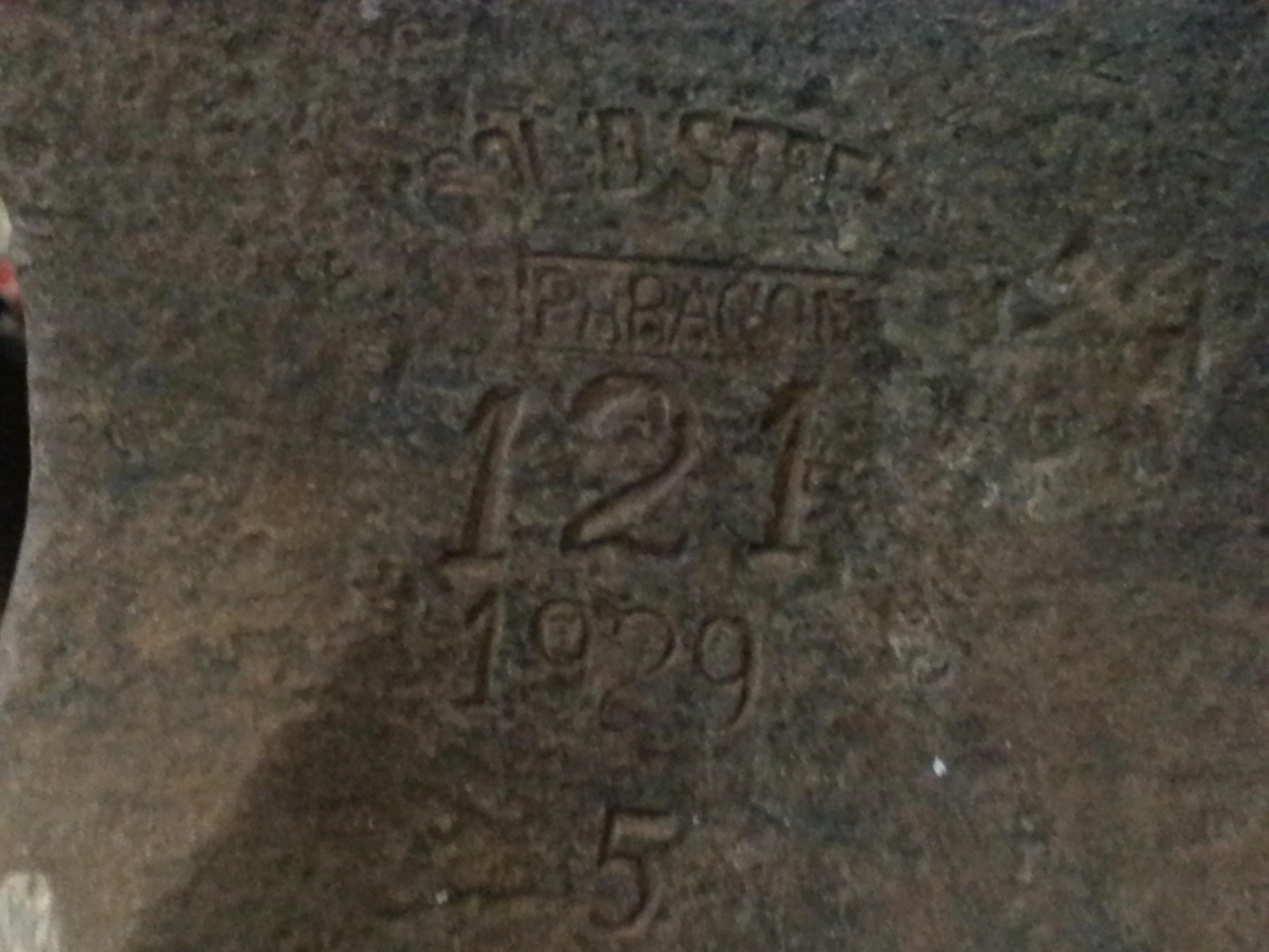

The spirit of Blacksmithing lives on in the heart of the heart of the U.S., in Donley County, in the Texas Panhandle. A 1925ish 125# Soderfors Sorceress, to whom the People have been coming for decades, and still do, last I checked.  You have given a wonderful presentation, in my assessment...
I hope you run into Dan Hurd, he has claims on the Fraser...
Hey Mr. FlatLiner..
Robert Taylor
Do you have a pic or link to the 125lb. Sorceress, Robert? Mine was cast in 1926, 125lb. Soderfors, Sorceress #5. I'd like a pic of another as a shop pinup.
Jerry, found six pics 1929, 121#, Sorceress proud on one side, Paragon stamped on the other...20140421_130829.thumb.jpg.df37db00af7b4a0481eef62ff4525240.jpg
I can PM to you the six full res (<2Mb) images if you would like...
Robert
Would you like risque pics of my 1906 157# Soderfors?

They don't need to be full res but yes, I'd like to see them. RISQUE:) anvil pics!? OH YEAH, Please PM them Robert!
