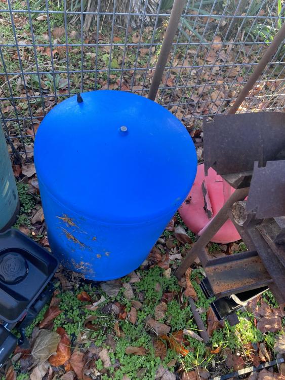

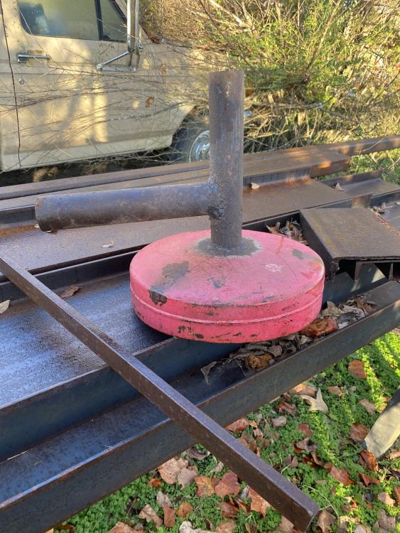

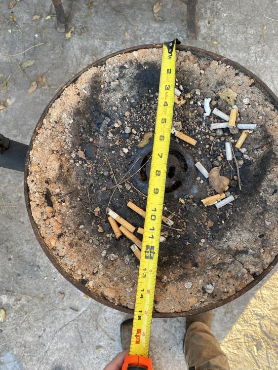

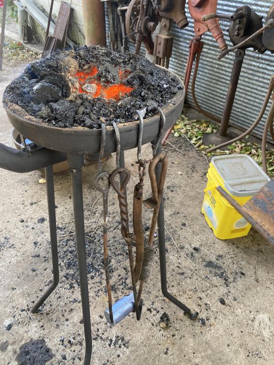

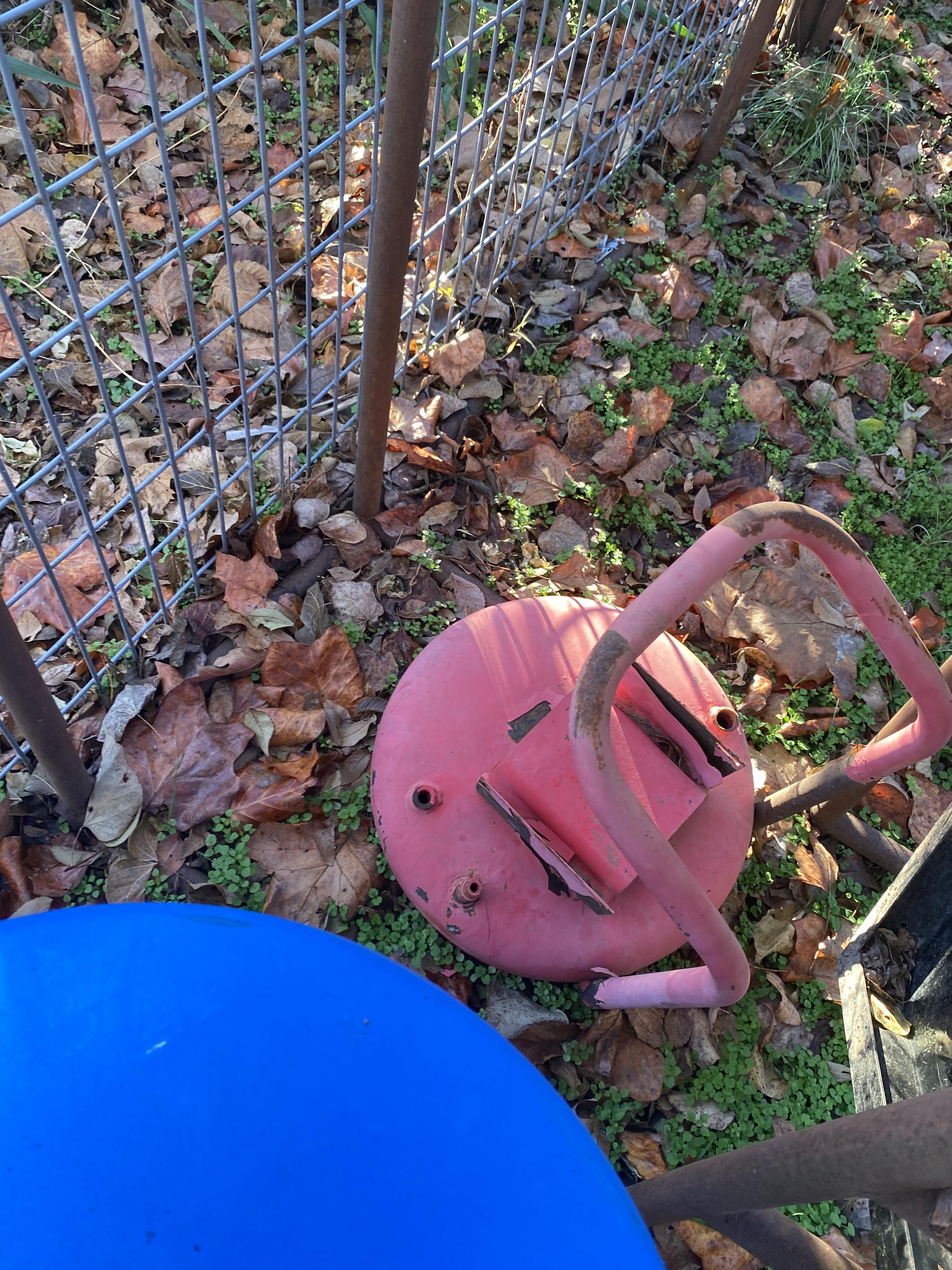

I’m not sure if your planning on using solid fuel but An option you may think about since your limited on space and funds is to build a portable forge that breaks down so it fits in your car
ive built several pancake forges and the materials can be found free to little cost, they’re durable, light weight and can be built with a little cheapo welder and an angle grinder,
I built one just this last summer that weighs less than a feed sack and the legs screw off an on, everyone on here chipped in with ideas every step of the way an it turned out awesome, 8765F874-9653-4882-BB6B-A038877029C7.thumb.jpeg.9842215b1ac8b9ca2b5247069b10ac4a.jpegC5C7E011-B5D7-4311-B516-1F7F87485A2A.thumb.jpeg.ddce98131744bfa175af53f7f68f287d.jpeg044B9F08-2E6B-4CA8-A370-8492AA604D5F.thumb.jpeg.97de6f09ef3be5a52fffd799659a273f.jpeg
Here some tanks I salvaged that I’m gonna use to build more, and here’s one I started on awhile back that needs finished, E028D8A7-0917-4279-96B9-9AA713B680AA.thumb.jpeg.4461363aaeb21de9e7984210783e216a.jpeg9376BF4B-CE61-44D7-8604-5467428AA185.thumb.jpeg.d19f283cc0df3ba27d0435419da9f4ef.jpegB0E12D6B-7C5E-47C4-9B3D-4E0F77B0089D.thumb.jpeg.23ca6b527b7e3e89b53cd4fd9d0915f8.jpeg8EF66CCC-F293-412D-948B-4E492E1C2A44.thumb.jpeg.36a32c2cba7b575d450dfe836861a221.jpeg
Anyways just a thought, if you decide to go with solid fuel you could make a little forge that could easily break down an fit in your trunk and leave you with plenty of room for all your other portable smithy tools,
that way you could already get to forging while your hunting for a bargain on a trailer
