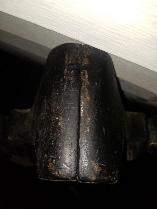

Just got this beauty from a guy on craigslist. he had it sitting in the garage for years and never even touched it. I opened it and it seems to move smoothly. Got it $235, not bad since another guy I talked to had several and wanted $1500 for a 200lb vise. This one is probably about 50lbs. But glad I was able to snatch it up when I saw it.
I found a Northwest Blacksmith Association group in Longview, WA. About a 45 min drive for me. They are having a intro class for making throwing daggers this Saturday. $125 for the class. I emailed them asking if I could get into the class but have not heard anything back yet. Here is hoping I can get in to get some real time in a forge and some experience.
Nice looking vise, and one of the often overlooked key tools for setting up a good blacksmith shop.  Prices vary a lot with location.  In my area that would be on the higher side for a vise with 4' wide jaws, but just about right for one with either 5 or 6" wide jaws (that is width of jaw, not jaw opening size).  Screw threads and jaws look to be in excellent condition and all the parts are there, so you are ahead on that account.
