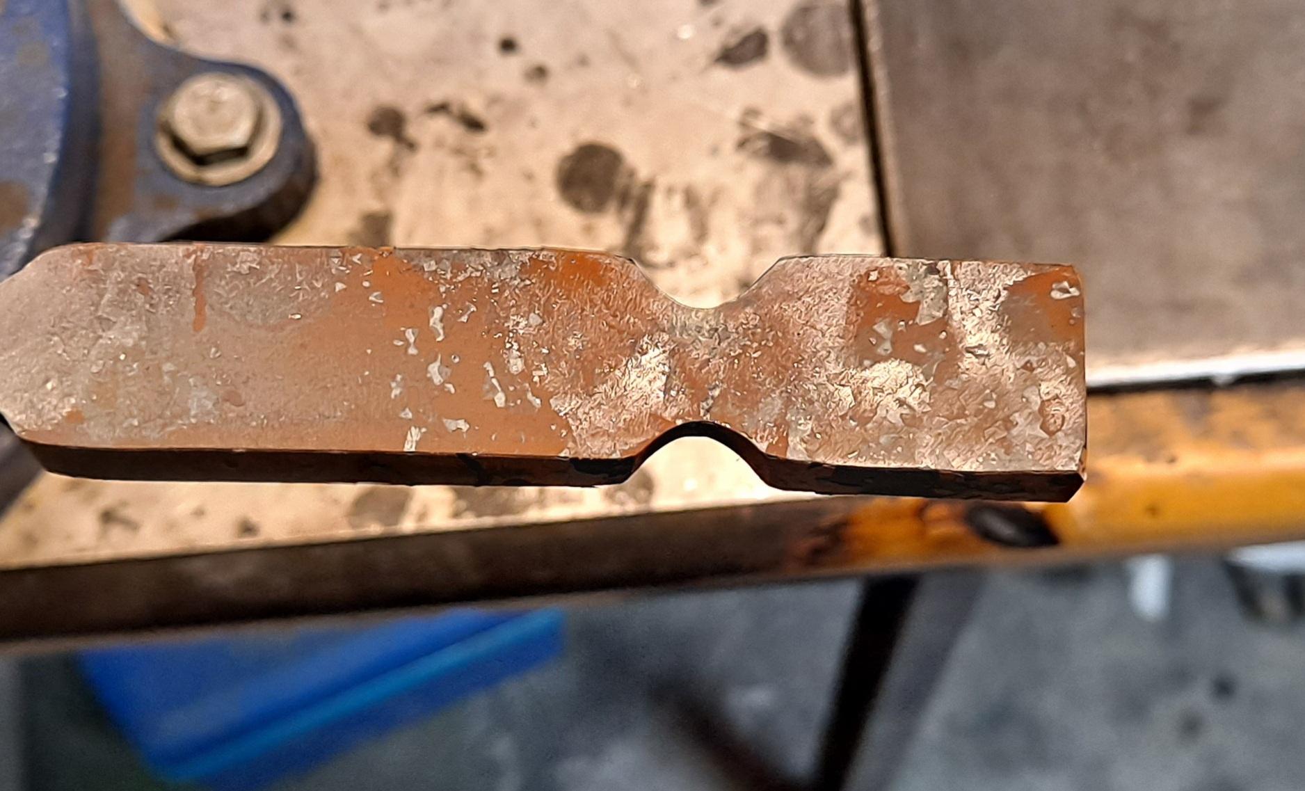

Ted Ewert Posted June 26, 2021 Share Posted June 26, 2021 I'm curious what the burnt orange deposit is that I get on my steel in addition to scale. I did a search here, so if this topic has been beaten to death in the past I apologize. Quote Link to comment Share on other sites More sharing options...

JHCC Posted June 26, 2021 Share Posted June 26, 2021 More precisely, iron oxide in the form of Fe₂O₃ (rather than the Fe₃O₄ that makes up forge scale), also known as hematite. Rust as such is a combination of hydrous iron oxide (Fe₂O₃·nH₂O) and iron oxide-hydroxide (FeO(OH), Fe(OH)₃). Quote Link to comment Share on other sites More sharing options...
Ted Ewert Posted June 27, 2021 Author Share Posted June 27, 2021 Here's a pic. This is on the outside of the scale. Quote Link to comment Share on other sites More sharing options...

Irondragon Forge ClayWorks Posted June 27, 2021 Share Posted June 27, 2021 I think it has something to do with humidity. Look up flash rusting. I see it when working on muzzleloaders. Pretty good info here. https://www.canada.ca/en/conservation-institute/services/training-learning/in-person-workshops/understanding-flash-rusting.html Quote Link to comment Share on other sites More sharing options...
ThomasPowers Posted June 28, 2021 Share Posted June 28, 2021 Note when asking such questions is is nice to tell HOW you are getting that. Using an induction forge in an inert atmosphere is different from using a coal forge which is different from using a charcoal forge which is different from using a propane or natural gas forge. YOU know the details we don't! Lower temps scale less rapidly than higher temps; DEPENDING on the oxidizing/reducing atmosphere of the forge. Hematite is the red rust and Magnetite is the scale/black rust (Magnetite can rust to hematite in a moist oxygenated environment.) Do you use water on a coal fire or quench in water? Quote Link to comment Share on other sites More sharing options...
JHCC Posted June 28, 2021 Share Posted June 28, 2021 Also, if you're using a gas forge with a neutral flame, the byproducts of burning propane are carbon dioxide and water vapor. Quote Link to comment Share on other sites More sharing options...
Frosty Posted June 28, 2021 Share Posted June 28, 2021 And nitrous oxide to a lesser degree if the flame is hot enough. Nitric acid leaves brown-orange stains. Frosty The Lucky. Quote Link to comment Share on other sites More sharing options...
Ted Ewert Posted July 3, 2021 Author Share Posted July 3, 2021 Sorry I didn't get back to you guys sooner. I'm using a propane forge and I try and keep the flame neutral, but things change as it gets hotter. I think Frosty's idea is probably close if not right. I have never seen scale rust. I've collected magnetite (fe3O4) on the beach. After a storm all the white sand washes away and the beach is nothing but black sand. If salt water won't rust it... This stuff appears more as a deposit than a reaction. Now that I think of it, it accumulates mostly on the parts of the steel which are exposed to the flame. It's also most prevalent when the forge is heating up. I'll keep an eye on it to more accurately note the conditions. Quote Link to comment Share on other sites More sharing options...

JHCC Posted July 4, 2021 Share Posted July 4, 2021 Looking at your photo, I’m guessing that you’re getting flash rusting in the places that don’t have scale adhering to them. Quote Link to comment Share on other sites More sharing options...
Ted Ewert Posted July 4, 2021 Author Share Posted July 4, 2021 I've watched this stuff accumulate on the scale while a piece is reheating. I tried to scrape some off to see if it was magnetic. Unfortunately the layer is quite thin and all I got were bits of scale. I wiped some off with a towel and it was unaffected by a strong magnet. The sample was so small that it wasn't conclusive, but I couldn't get any movement at all, even on small threads that were covered in it. I dunno. It's probably just some deposit from the propane. Quote Link to comment Share on other sites More sharing options...
Frosty Posted July 4, 2021 Share Posted July 4, 2021 It forms while the piece is heating in the forge? That sounds like you have lime/calcium in the water and a residue is oxidizing in the fire. Frosty The Lucky. Quote Link to comment Share on other sites More sharing options...
anvil Posted July 7, 2021 Share Posted July 7, 2021 JHCC hits it on the head. It happens in a forge too. Quote Link to comment Share on other sites More sharing options...
