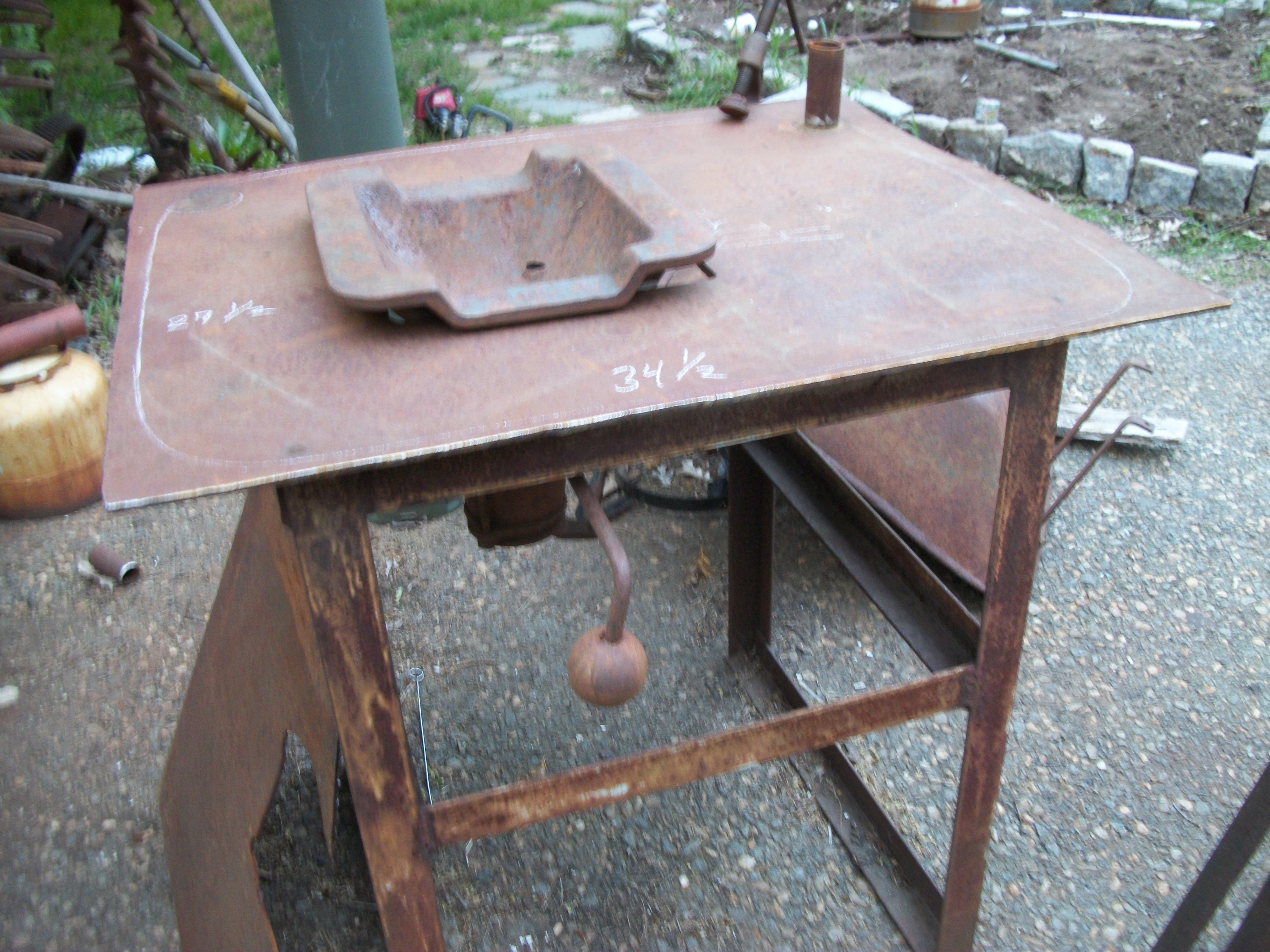

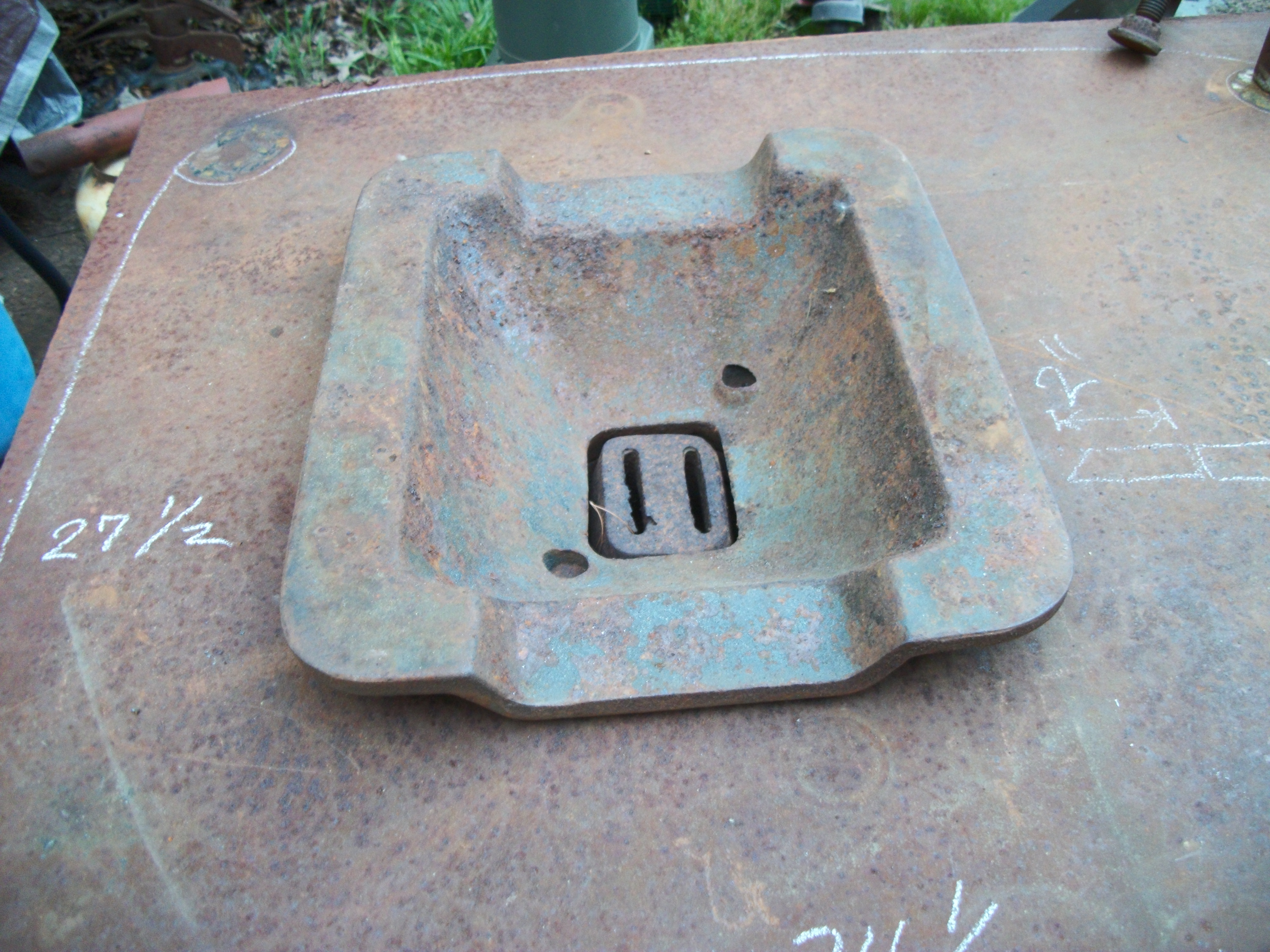

Gazz Posted May 12, 2021 Share Posted May 12, 2021 I have a large fire pot and an angle iron frame with steel plate top. I cut a hole in the plate to set the fire pot into and will be using a steel wheel barrow tub for the hood. My question is, should I line the fire pot with refractory cement? Years ago in a shop I worked in, the firepot there was lined with refractory but that forge burned 10 hours a day heating stock up to 3" in diameter. I'm not going to work it that hard. What do you folks think? Link to comment Share on other sites More sharing options...

Frosty Posted May 13, 2021 Share Posted May 13, 2021 Not refractory cement, mortar, etc. If it's hard and cemented in place thermal cycling WILL break it up. Masonry has a different coefficient of expansion than steel; steel expands and contracts more and faster than masonry. If they're glued together the steel will win because it WILL flex and masonry is as flexible as . . . Hmmm? 2-3 parts sand or crushed ceramics grog to 1 part clay makes a fine solid fuel liner. Just enough moisture it can be compacted hard and ram it in. If you make it like mud or pottery clay and it WILL shrink check as it dries. It'll end up just like a dry mud puddle, all the cracks are "shrink checks." Frosty The Lucky. Link to comment Share on other sites More sharing options...
anvil Posted May 14, 2021 Share Posted May 14, 2021 Use castable refractory or "fire clay". Google it for location. There are many companies who make it. You buy it by temp needs. It can be found at pottery supplies as well as hardware stores and fireplace supplies. The hardware stores and fireplace supplies usually don't have the needed temps Do not line your firepot. Clinker can stick to it and your fire tools will trash it with normal use. Link to comment Share on other sites More sharing options...
Frosty Posted May 14, 2021 Share Posted May 14, 2021 Almost every sand and gravel supply that's more than just a pit, concrete batch plants and masonry places carry fire clay. It's used in all sorts of fire structures from fire places to outdoor fire pits. Just do a web search for "Fire Clay." I don't know of different grades of fire clay, fire brick yes, there are several common available temp ratings. The local concrete batch plant makes fire bricks in different shapes. They'll even use one of their many paver molds if you want to pay the price. Call around, it's everywhere. Frosty The Lucky. Link to comment Share on other sites More sharing options...
Gazz Posted May 15, 2021 Author Share Posted May 15, 2021 Sorry I haven't been able to get pictures posted - I've been busy with truck repair and getting my small vegetable garden ready so the forge work got set aside. I do have a bag of castable refractory that I used when I made the floor for my gas forge. I also have a friend who owns a pottery studio so stuff like fire clay and grog are easy to get from her. I do intend to put 1.25" thick fire brick around the fire pot mostly to bring the level up close to the edge of the fire pot. Pictures will explain it all and I'll take some tomorrow. Link to comment Share on other sites More sharing options...
Gazz Posted May 17, 2021 Author Share Posted May 17, 2021 Here is my project. The flat area will be covered with 1.25" thick fire brick. The hood will be removable and have hinged sides to help create better draft through the chimney. Link to comment Share on other sites More sharing options...
ThomasPowers Posted May 17, 2021 Share Posted May 17, 2021 How are you keeping coal from falling off the forge table? Link to comment Share on other sites More sharing options...
pnut Posted May 17, 2021 Share Posted May 17, 2021 Might want to put some angle iron around the perimeter of the table to keep the coal from falling off. Looks like it will be a fine forge when you're finished. Pnut Link to comment Share on other sites More sharing options...
Gazz Posted May 17, 2021 Author Share Posted May 17, 2021 I had planned for that and did get some flat stock to make a fence around the perimeter but haven't got to that yet. Link to comment Share on other sites More sharing options...
Gazz Posted May 19, 2021 Author Share Posted May 19, 2021 Still interested to hear thoughts on whether I should line the pot wit refractory. Link to comment Share on other sites More sharing options...
Charles R. Stevens Posted May 19, 2021 Share Posted May 19, 2021 Slag will stick to refractory like glue. Your cast iron pot will do fine as is. Link to comment Share on other sites More sharing options...

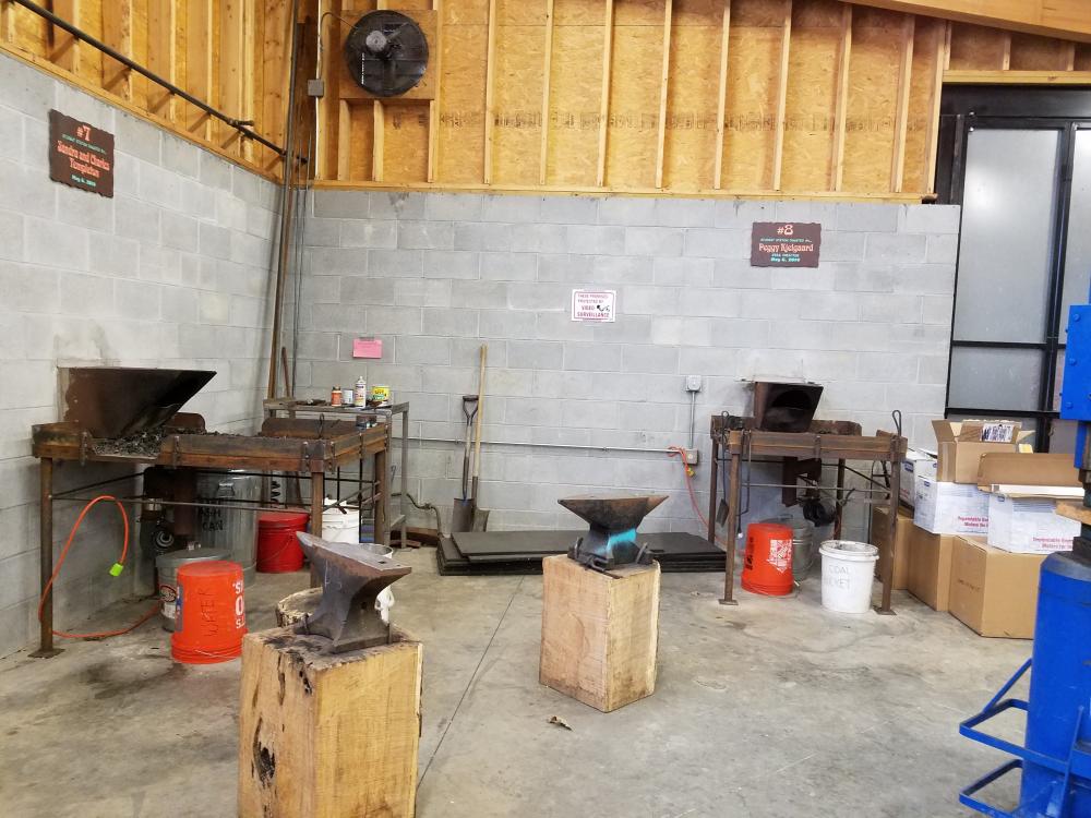

Irondragon Forge ClayWorks Posted May 19, 2021 Share Posted May 19, 2021 On 5/17/2021 at 7:57 AM, Gazz said: flat stock to make a fence around the perimeter When you make that, leave the center of both sides across from the dished out sides of the fire pot open, with a lift out section to pass long stock through. When not needed the lift out is replaced to close up the opening. Link to comment Share on other sites More sharing options...
Irondragon Forge ClayWorks Posted May 20, 2021 Share Posted May 20, 2021 It took me a while to find this picture of the coal forges at ESSA. The "fences" are all removable mounted with rebar welded to the fence, which goes into a piece of tubing welded to the table. You can see the pass through area and the fence portion can be put into position to keep any coal from falling off the table. Link to comment Share on other sites More sharing options...
anvil Posted May 20, 2021 Share Posted May 20, 2021 Like I said above and Charles said, don't put fireclay in your firepot. It's unneeded. That's why it's made out of cast iron. Clinker sticks to the fire clay. And finally normal fire control with your poker will chip it off. Link to comment Share on other sites More sharing options...
DennisCA Posted June 10, 2021 Share Posted June 10, 2021 I remember Joey Van Der Steeg saying to leave a layer of ash in the pot, it acts as an insulator. Link to comment Share on other sites More sharing options...
Irondragon Forge ClayWorks Posted June 11, 2021 Share Posted June 11, 2021 That's what I do makes easy removable of the clinker. Link to comment Share on other sites More sharing options...
