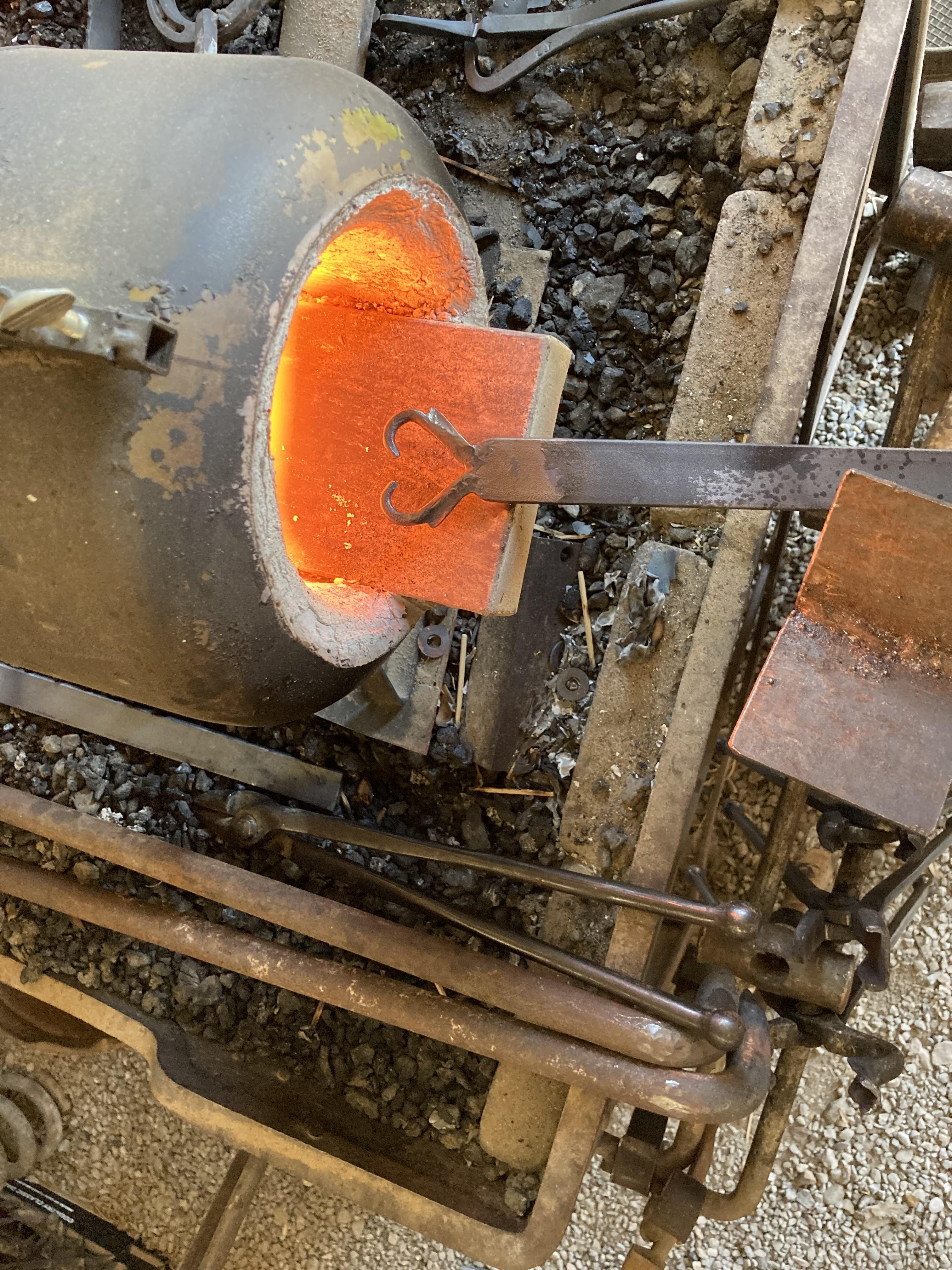

Bantou Posted May 6, 2021 Author Share Posted May 6, 2021 12 minutes ago, Latticino said: That's when you switch to using a drill... You had plenty of width and didn't need to punch. If you do punch there is certainly no need to go above yellow/orange heat for such a thin stock. I don’t have a drill press yet and the last time I tried doing it with a hand drill, the bit walked around on me. The hole wound up being off center of the bar just enough to be noticeable. I marked the hole location with a deep center punch but it still decided to go walkabout on me. The area I was punching never got above that heat. The side that burned was deeper in the fire and got hotter than I anticipated it would before the center of the bar got to a workable heat. Quote Link to comment Share on other sites More sharing options...
Frosty Posted May 6, 2021 Share Posted May 6, 2021 Don't run your drill so fast and it'll be easier to control. Use a wider center punch even if you have to grind your own. You do pick up: center punches, chisels at yard/garage/etc. sales don't you? I always pick them up for impact tool stock. Keep your eye open for a little disk grinder if you don't have one already. Why did you stand it on edge in the fire? It wouldn't fit laying down? Do we have to explain how ESY it is to reconfigure a JABOD . . . AGAIN? You can remove the fire back bricks, use a broom stick size dowel standing vertically against the tuyere pipe to make your "fire pot" and a handful of "corn kernel" size charcoal to build the fire. This will give you a blow torch to heat the center of your strap. Removing the fire back will let you lay it down any direction you wish. Frosty The Lucky. Quote Link to comment Share on other sites More sharing options...
Bantou Posted May 6, 2021 Author Share Posted May 6, 2021 I’ll give the slower speed a try on the drill. I was taught fast and light for drilling metal so that’s what I did. Yes I stood it up on edge because I couldn’t get the center part hot without risking one of my finials otherwise. I know how easy it is to reconfigure the JABOD. I’ve done it a dozen times trying to get it to work right. Part of it was not wanting to fiddle with the JABOD and have to spend the next week trying to get it to act right in a new configuration. Part of it was that it was late, I had the fire going good, and I just wanted to get it done. The rest was being in a rush trying to make and engrave three crosses that I’ve never done before by Sunday. I should have stopped when I realized what I was doing wasn’t working right. I didn’t and payed the price for it. I am going to cut the bricks of the fire back down flush with the hearth. It was fine for smaller projects but it’s causing me a lot of frustration with this one. Quote Link to comment Share on other sites More sharing options...
Frosty Posted May 7, 2021 Share Posted May 7, 2021 1 hour ago, Bantou said: I was taught fast and light for drilling metal Pass anything you learned from this person by us before trying it. That is as opposite of how you drill most metals, ESPECIALLY steel as you can get without trying. What you see on forged in fire is typically at least one step pully too high an RPM and you see so many broken scales because the guy is feeding the bit too hard. There are times when fast and light is the right thing to do with metal but it's a specific circumstance I won't go into here, it'll just confuse you. Low RPM moderate pressure, listen for the drill motor to work but not bog down. Another reason for a bit to wander is dull or it's unevenly sharpened. This is all pretty normal for the learning curve. If you have problems run them past us, we'll help you out. If I don't know or what I think I know is wrong or there's a better way someone will jump in and we ALL win. The more you learn about working metal the more you learn you don't know. Frosty The Lucky. Quote Link to comment Share on other sites More sharing options...

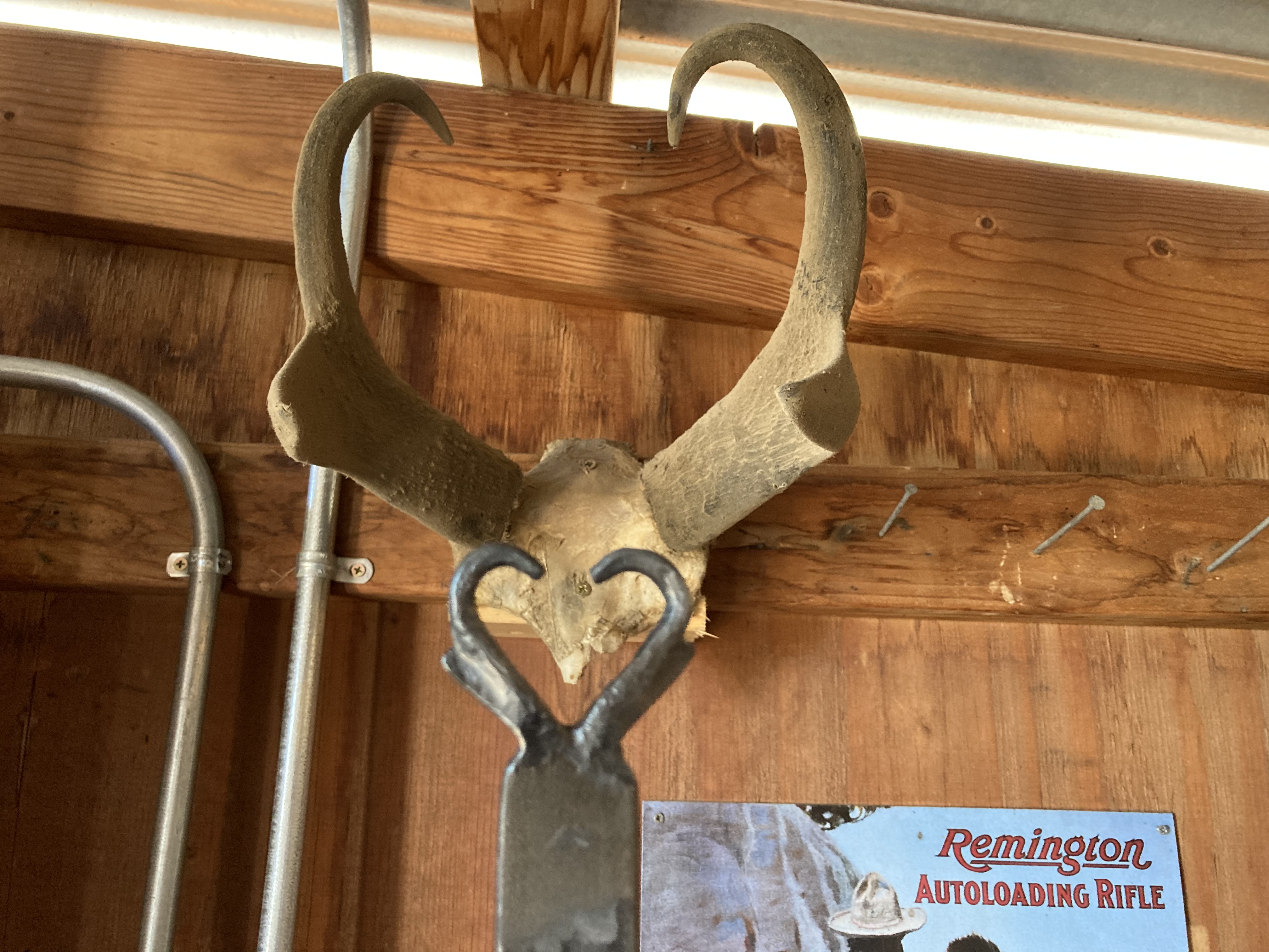

gmbobnick Posted May 7, 2021 Share Posted May 7, 2021 Took at stab at adapting this idea to a "pronghorn" finial, more or less following the suggestions made in this post. Some room for improvement, but it'll work! Quote Link to comment Share on other sites More sharing options...
George N. M. Posted May 7, 2021 Share Posted May 7, 2021 GMB, I like it. A good representation but if I may make a suggestion: A little sharper tips and then wire brush or file the tips to give a hint of the "ivory" on the horns of a big pronghorn buck. The next 1, 2, or 20 will go better and look more finished. GNM "By hammer and hand all arts do stand." Quote Link to comment Share on other sites More sharing options...
