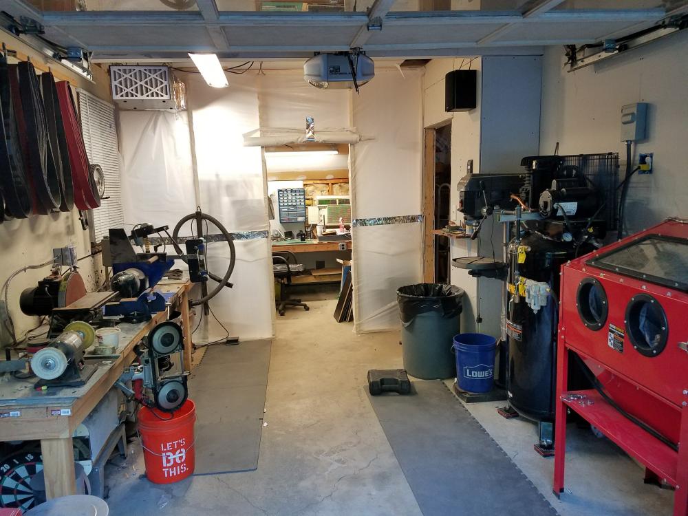

Frazer- Thank you! It is nice to see another maker from NY. I have been bouncing back and forth on idea of charcoal. My ultimate concern is I would like to forge in my workshop. My workshop is One side of a two car garage. I built a wall separating the two halves. But I worry it would be more dangerous then a propane forge. The other concern I have is getting the coal. I do have a tractor supply close to me but it tends to be a bit inconsistent.
This picture old. But you can get the idea of the space I have. Actually I have less space now due to my surface grinder and welding table 12407DFC-4AD1-4D07-A23E-84F741A80E58.thumb.jpeg.27f39b56edf3b733e0e046f184d1af41.jpeg

Whether you use gas or coal, and I know I'm stating the obvious, but if you're indoors you'll want to have proper ventilation and make sure whatever heat source you put in there is up to code. First for safety's sake and second for insurance purposes.  I'll be moving my shop indoors (also a garage) in a little under two weeks so the second point is fresh on the mind, so to speak.

Whatever fuel you burn will produce CO Carbon Monoxide and consume oxygen. If it's an attached garage the CO will probably infiltrate the house too. You can prevent this by keeping the garage pressure lower than the house with exhaust fans. It's not a guarantee to be sure but it helps. The only safe assumption is CO is getting everywhere, detectors in your living spaces. A detached garage is better by a long way.

Frosty- JHP does amazing work. I am going to walk before I run for sure. My work shop (Garage) is attached to my house so I will have to be extra careful. I work in the HVAC  Industry for 20 years and after your response It got me thinking. I began taking measurements on calculating Make up air and exhaust air. So far I need 400 CFM for the exhaust. I am going to need 800 cfm for makeup air. I will also set up a few RIB relays to power up a bigger fan.  When the CO raises to a unsafe amount the second fan will turn on.

One of the plusses of bituminous coal is that you can look at the smoke and *KNOW* you shouldn't be breathing that stuff!  A gas forge puts out the toxic invisible, odorless CO and so we get problems, especially when it gets cold out and folks tend to button up their shop.  Also they may not realize that when they start re-running exhaust gasses into their burner; CO production SPIKES! With a background in HVAC I won't worry about you!
What I do worry about your shop: are you keeping the "clean shop" separated from the "dirty shop"?  Machine tools do not like dust produced by other processes!

Thomas- I do keep a pretty clean shop however when doing handles I even with my dust collector G10 dust still manages to coat everything.
