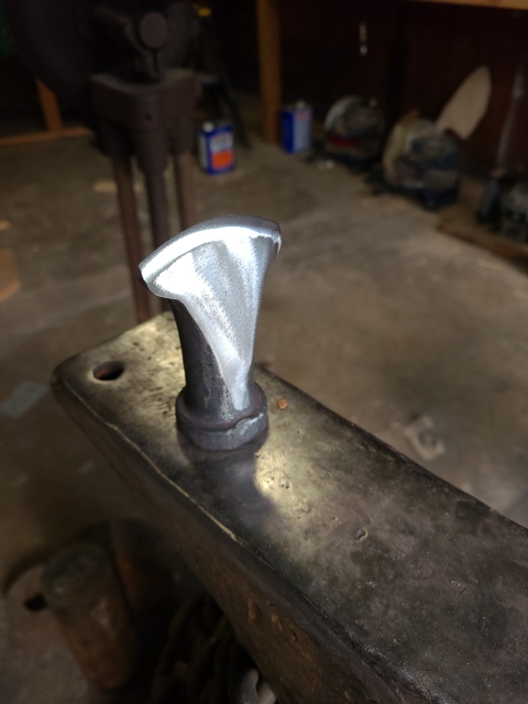

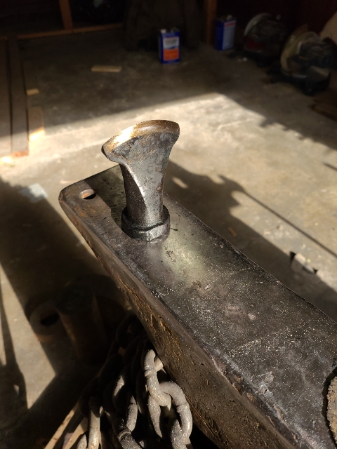

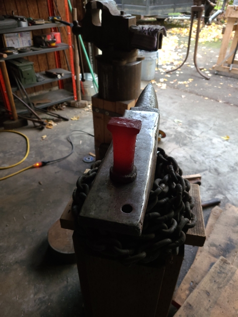

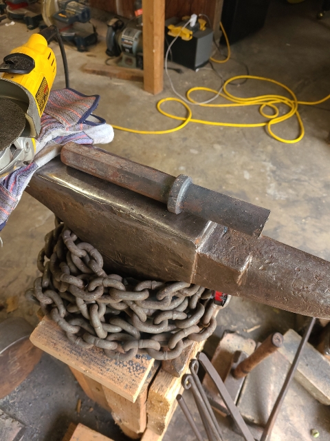

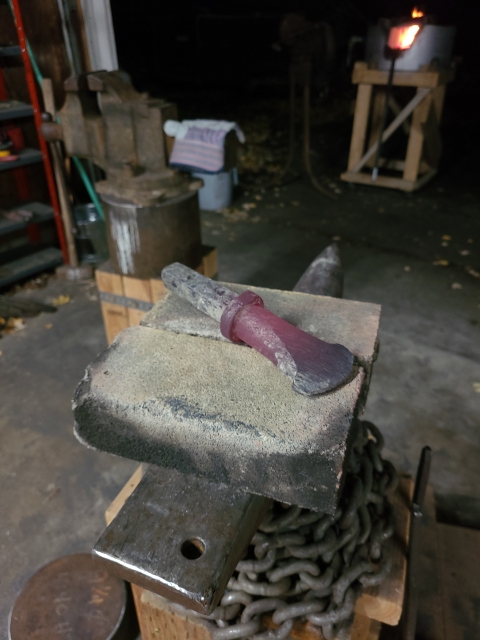

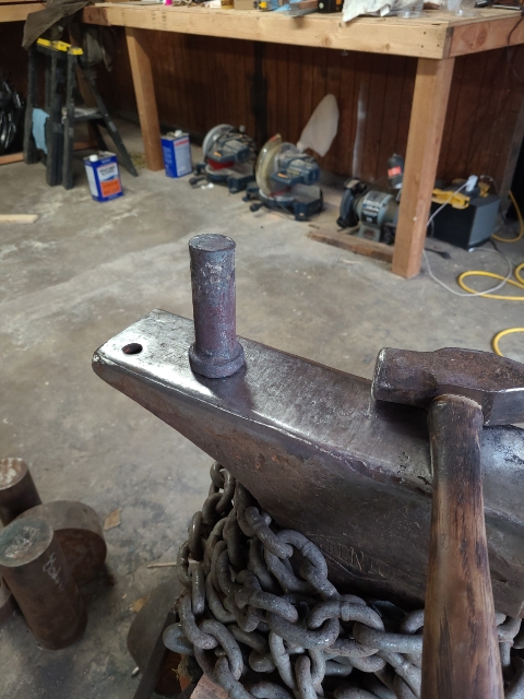

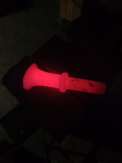

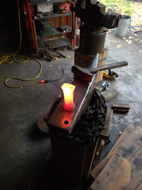

Made my first hot cut tooling for the 1" hardie hole on the Trenton today. Well... I got through the normalizing cycles. Ill get it ground and heat treated tomorrow afternoon. Started with the shank end of a jackhammer bit of which I made a hammer eye drift from last week. 20201109_123444.jpg.859af4d6a4abe7ed033bf68baf46ba8b.jpg20201109_125757.jpg.7e23db5cf72e2bdcdc293e8260416b69.jpg20201109_144219.jpg.ff948a2a894639040b10491ca92c8ecc.jpg20201109_150604.jpg.782bd2348996d1498e8bfa226244ba22.jpg20201109_160129.jpg.82520f2c37b39c55bbf8421fde641887.jpg20201109_160426.jpg.9a3f0ebebaa1825b0e7e44a3837f5d09.jpg20201109_172201.jpg.0325ce3ea2cf542a39fa2b6afb14d8ff.jpg20201109_172433.jpg.4251dfa1ba197d11c35fc1912fddb0f2.jpg20201109_172547.jpg.c995b12fe81a8b91d0ccdb9d2eb8ea79.jpg
As always, feed back and thoughts to chew on are always welcome and appreciated.

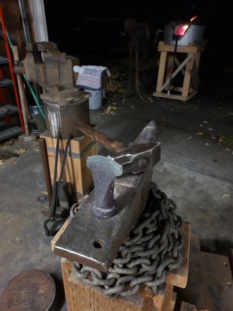

Looks good. My only suggestion is either (A) temper it on the soft side or (B) do your cutting with a soft hammer. Both of these are just fine for keeping the edge of the hot cut undamaged.
Excelent, great advice. I was thinking a softer edge would be ideal, I left excess height taking this into account, so as I dress it over time I can later upset and reforge the cutting end of the tool.
Mine is made from a jackhammer bit too.  It was the broken off tip that I forged down what was left of the shaft to fit the hardy hole; been using it around 20 years and it's shrunk at least 1/4" so far from sharpening.  I would like to point out that resharpening the hardy is a trivial task compared to redressing a hammer face.  I actually hand students a harder hammer when they go to cut if their hammer control was so sloppy I had given them a softer hammer to use forging.  (I have one dead soft hammer that I "suggest" to folks who hammer like lightning---never hitting the same place twice!)
I definitely feel thats the way to go. I would much rather damage a hardie tool than my hammer face.
Quick tip: when you're cutting a piece to length on the hardy, cut almost all the way through with the hammer coming down directly over the edge. When you're almost all of the way through, shear off the last little bit with the hammer off-center, so that it goes off to the side.
Thanks! I'll keep it in mind.

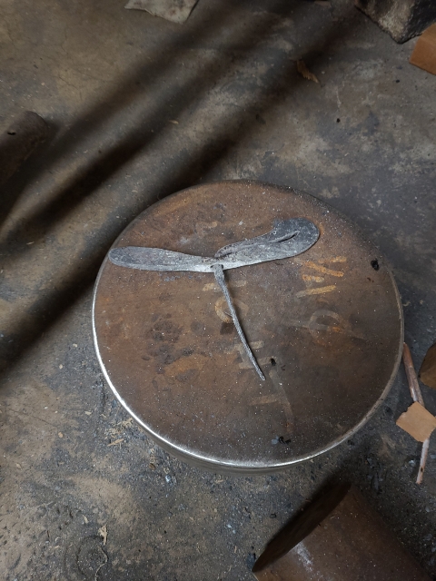

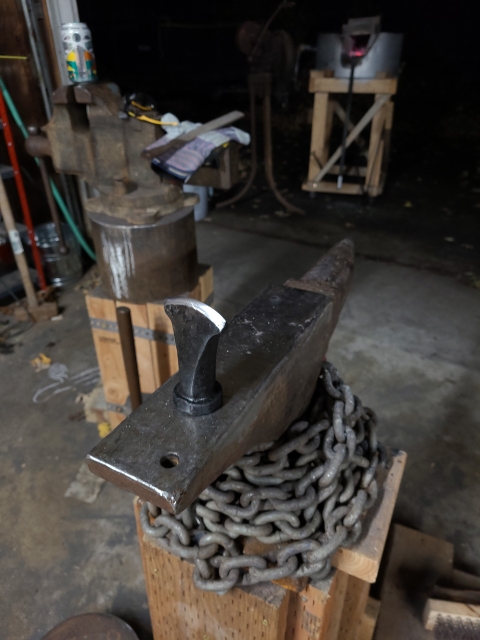

Ok, got back into the shop today. Groun, heat treat, and put an edge on the hot cut this morning. Then spent all day attempting to make a corkscrew from some coil spring. I failed,  the tenon to become the screw of the corkscrew kept cracking on me, I may have burned it at some point in forging, or I worked it too cold. It heats up and cools off pretty quickly that small of a taper. But the good news is I got plenty of practice using my new hot cut hardie tool, removing the wasted cracked and burnt portion of said project.  Here are the final pics of the hot cut.20201110_122206.jpg.36a8e56ddb425e64c3a3a766cba06b42.jpg20201111_110539.jpg.fe0064e8d432eff8dc2143c15f23fe3c.jpg20201111_173331.jpg.e709354251b0445721a34a384306c727.jpg
Mark Aspery has a great video on how to make a corkscrew. Granted his isn't using a tenon, but the approach will probably be similar.

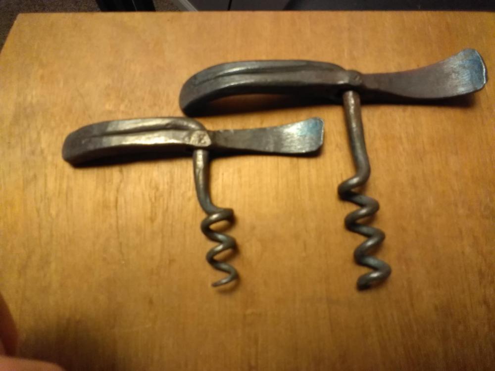

This is my rendition of what he made.
I used spring steel and a mandrel to wrap (not what he shows), then a chisel to open up the coil. The spring I was using would harden if I closed the vice on the tip above critical temp, then it would snap off, so I know your frustration. Corkscrews can be very fiddly.. I had to make 50 of them for a winery and it took much longer than I expected.. Good luck, you'll get them nailed down.
Btw I like that hot cut, very nice indeed, Way better than the one I made.
Yeah thats the one I was trying to make, sorry I misspoke not a tenon, the step-down and drawn out portion that becomes the screw, thats where the cracks were showing up during the draw out. Yours look quite effective. I think ill need to work on my pre form a little bit too. But maybe after a couple more ill have it figured out.

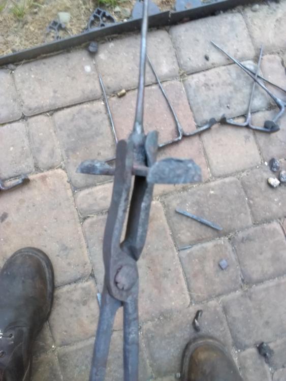

20201111_173823.jpg.202b92ee25c54d4b2b53fa5d0a2b0992.jpghere is my first attempt,I quit after I noticed a crack forming about mid way down the screw bit. And that was after cutting off about an inch and a half incrementally from the tip, due to cracking.
For that isolation I use a rounding hammer and the horn, my best suggestion is to leave everything a little longer and a little thicker than he says. I didn't really follow his measurements exactly. I forged a long square (IIRC he used 3/8? I would have to check my book for all the measurements he used and what I ended up going with) isolated the amount of material I would need for the corkscrew (plus an inch or so), thought about how long I wanted the handle to be, multiplied that by 2 and added a bit to compensate for the bend, forged that round, made the hole, (remember that hole is supposed to be bigger than the diameter you isolated for the screw, but a little smaller than the length you'll fold over into half of the handle handle, so when you feed it through it stops where you want it to) then you can cut off the other end to the desired length.

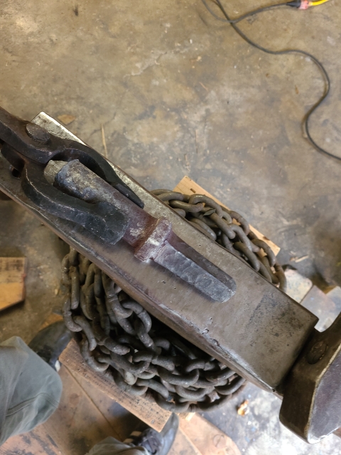

I will say having a pair of box jaw tongs that can hold both the handle side(s) and the center is super helpful for that whole fiddly process once it's cut from the main piece. (picture is from the split RR spike corkscrews I made a bunch of, but I use those tongs for both).

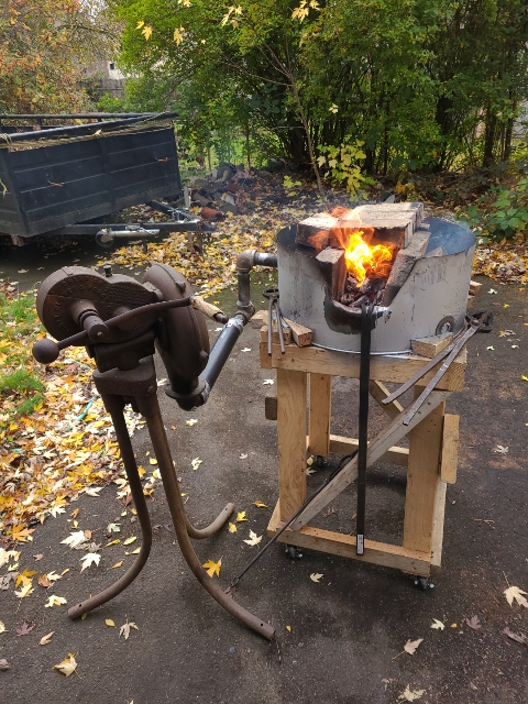

Nice looking hardy, MG. So how do you like your charcoal forge these days? I liked seeing how your forge design changed as you got more information. I'm really interested in knowing how the cutouts for a lower hearth seem to be working out for you. My similar forge has the tuyere lower from the hearth than yours seems to. Was wondering if you fight the charcoal to keep it in your firepot.
Would you mind telling me the full firepot dimensions including the level of tuyere? You seem to have more room in there for those monster jackhammer bits you have been forging into tools!
I get pretty hot temps in mine without having to top with firebricks. Can easily spark carbon steel if I'm not careful. Have not yet tried to forge weld anything at this time.

Making a smooth rounded transition helps prevent cracking.  I use a swing arm fuller with rounded edges to establish the transition and then hammer the one side down smaller, just like I do for tangs on knives. (Though a corkscrew will use a smaller fuller than the knife tang generally will!)
Thomas, the cracks were developing mid way down the isolation for the screw, and at the tip when I would try to give it a fine taper point. I think I may have had pre existing cracks in the material. Or. I burnt it at one point then later likely hammered at too low of heat.
