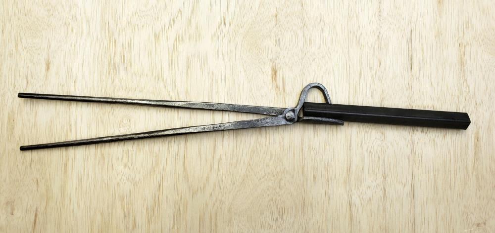

Chris C Posted August 6, 2020 Share Posted August 6, 2020 Well, they were complicated for me. They aren't pretty, but they danged sure work. Started with 3/4" sq bar, 8" long for each half. That's a piece of 3/4" bar in the jaws. They securely hold from 5/8" square to 1 1/4" square............and the same with round. Top jaw is split like a snake's tongue. I'm happy with them and they'll fill a gap I have in tong sizes. Reins are 16". These sure do make a guy yearn for a power hammer! Quote Link to comment Share on other sites More sharing options...

Chris C Posted August 7, 2020 Author Share Posted August 7, 2020 Thanks, guys. I think they'll work a treat for me. It's funny..............thought these were my own design, but took them to a friends shop for suggestions during the making and he had a pair hanging on his rack. Does anyone know what these are called? (friend didn't know) I've had a couple of people ask, but I have no idea. Quote Link to comment Share on other sites More sharing options...

Chris C Posted August 7, 2020 Author Share Posted August 7, 2020 Thanks Chellie. If my memory were better I'd know the name. The video I stumbled onto that gave me the general idea labeled them with some country's name.................like Egyptian Tongs. (but that wasn't it.) I've tried every search word I can think of to find that video again to no avail. Quote Link to comment Share on other sites More sharing options...

Chris C Posted August 7, 2020 Author Share Posted August 7, 2020 Well, while I "thought" they were my design, I actually saw a pair at a friend's forge.................so someone made them long before I. I was just prompted by the ones I saw in the video. But like you say, they will be versatile, I think. Quote Link to comment Share on other sites More sharing options...

wicon Posted August 7, 2020 Share Posted August 7, 2020 Looks like a Pelgrom tong Quote Link to comment Share on other sites More sharing options...
Chris C Posted August 7, 2020 Author Share Posted August 7, 2020 Just looked that term up and by golly, you are right. Quote Link to comment Share on other sites More sharing options...
anvil Posted August 13, 2020 Share Posted August 13, 2020 Probably even today people name them after the job they do I use that style to work hinges. The barrel goes inboard and the tongs clamp the hinge body. So I call them hinge barrel tongs. Lol, I use them for other things as well, but made them for forging hinges. Quote Link to comment Share on other sites More sharing options...
