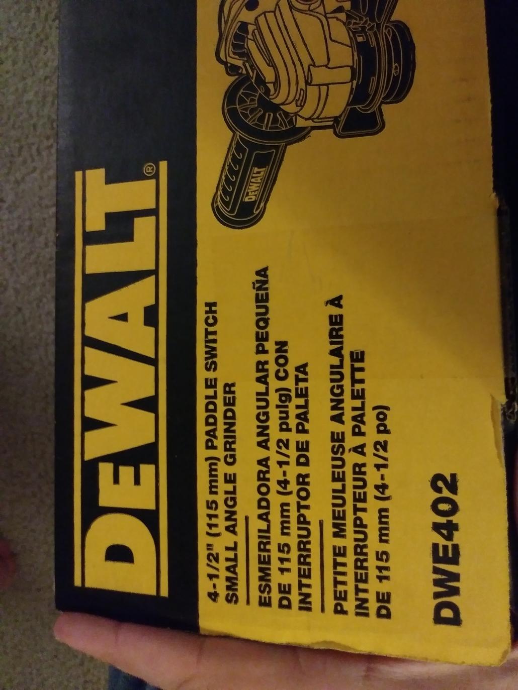

I was given an angle grinder for my birthday. I was vague with my birthday list, never having used an angle grinder before. I have not had time to research them, nor to test this one out.
My father-in-law is a very handy person and did the research on this one, so I'm guessing it will do what I need it to. There is a limited window on returns, so I was hoping you might be able to lend me the benefit of your experience and confirm: will this do the job as a general-purpose angle grinder in a hobby shop? The details of the grinder are in the pictures below. Little Bean for scale (apologies for the blur).
It' a 4 1/2" Dewalt angle grinder and is a good tool for it's size. Without knowing what you intend to do in your shop how do you expect anyone to say yes or no? It's not a junk brand.

Dewalt is a good brand, 4.5" is a decent size and that model has two safety features, non locking paddle switch or dead man switch ,and a brake (according to their website).

Frosty, I was able to give a couple of criteria that he used in his shopping:
- Cut through pieces of metal at least 1" thick (not quickly)
- Shape/grind steel
