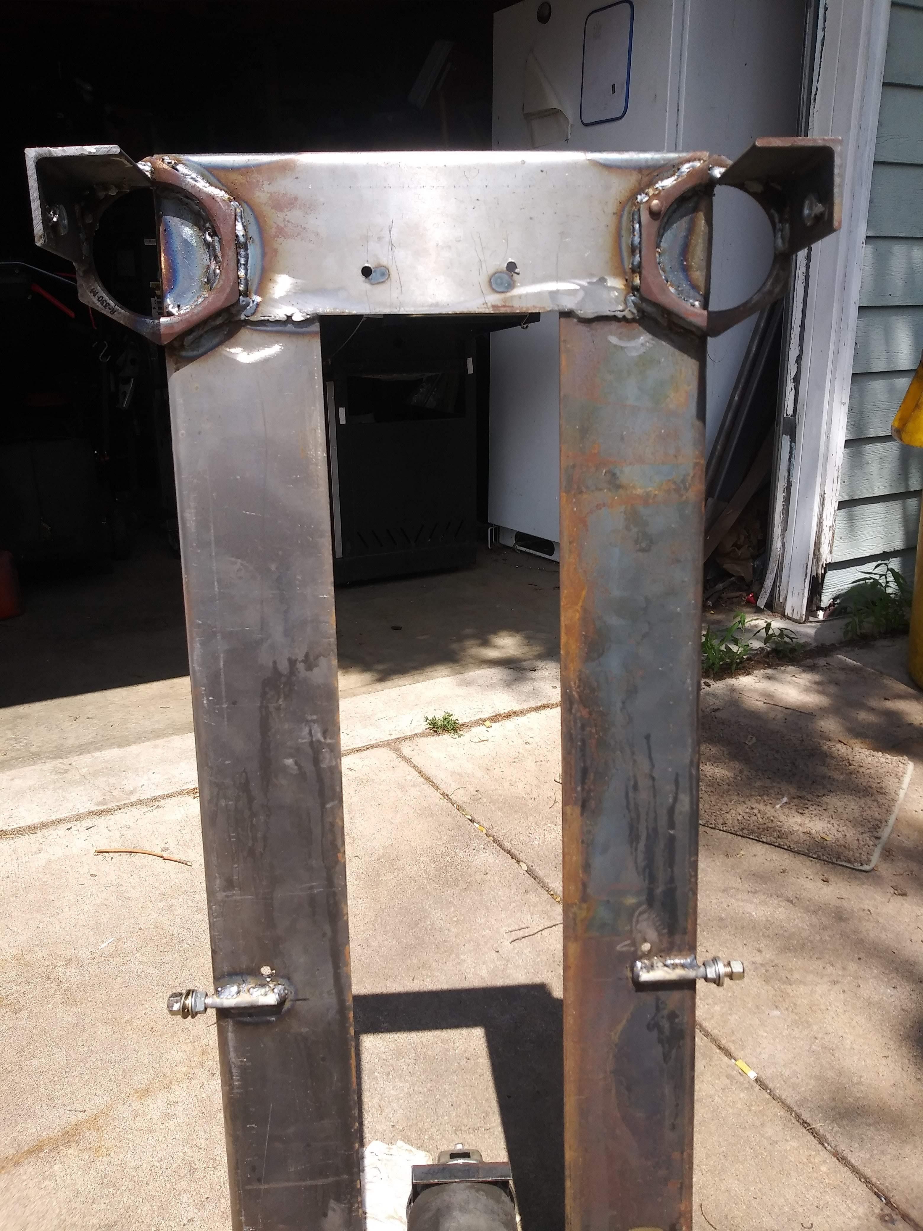

Archie Otteson Posted February 17 Share Posted February 17 I used undiluted copper sulfate on this steel frame. It reacted almost immediately. Be aware it should probably be diluted with water. if you don't neutralize that stuff it will eventually turn to brown rust. Not really a good rust preventor like bluing or rust brown (aqua fortis). Quote Link to comment Share on other sites More sharing options...
Frosty Posted February 18 Share Posted February 18 What do you finish plated steel with to prevent oxidizing? Hot brushing with copper or brass brush, copper sulfate solution or electroplating, will all degrade over time unless it gets a protective coating. Or you hide a zinc on it somewhere, even then . . . Frosty The Lucky. Quote Link to comment Share on other sites More sharing options...
