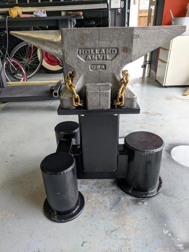

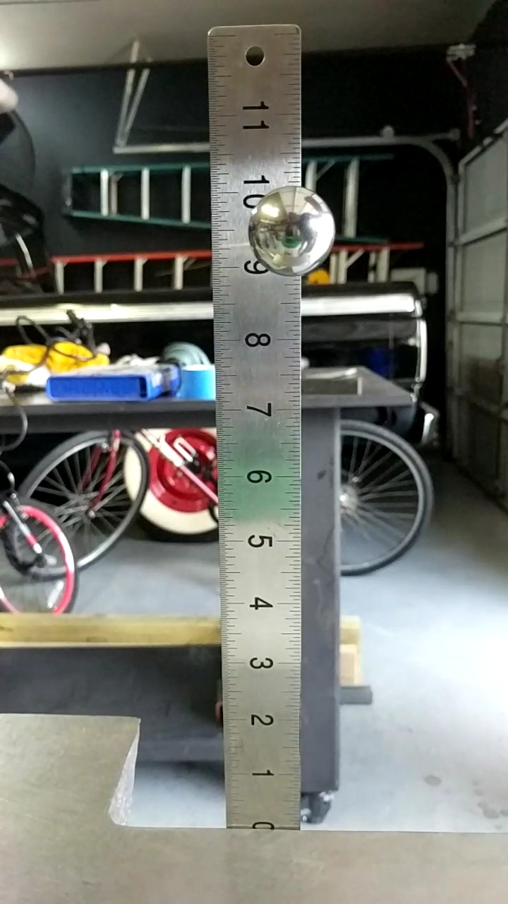

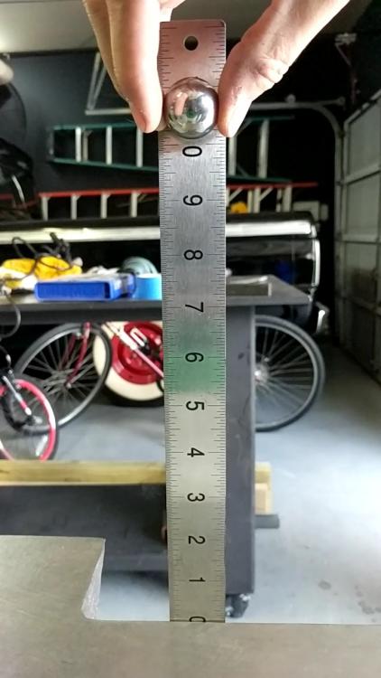

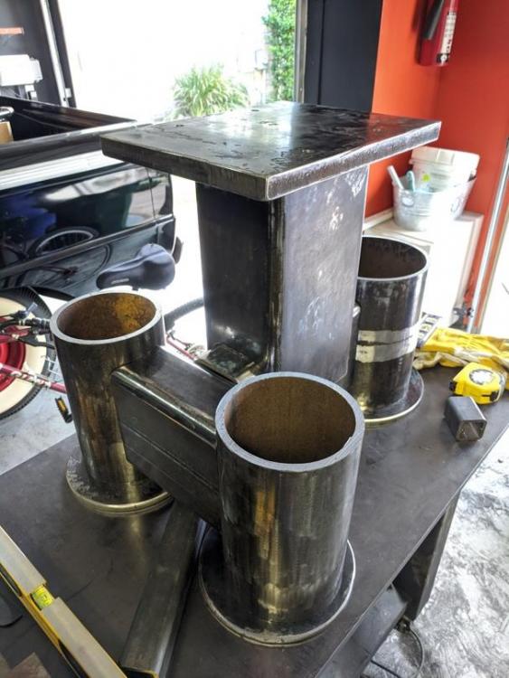

Arkie, no issue with access. I can get my hips all the way to the face and get as near as I like without bending over. I've worked on similar stands without it bothering my back, even on lower face heights. That's the reason for the large single leg placed at the heel, it allows getting very close. TP, the average of four 1" hardened ball bearing tests was 86%. When the anvil was directly on the ground (concrete) I was getting 90%. So at least for that test I agree I have lost 4%. Something I will just have to accept. -

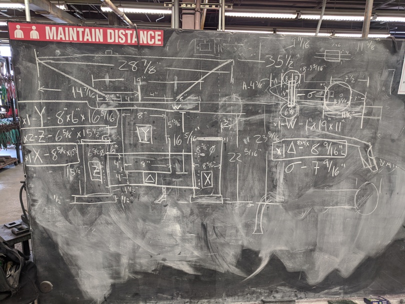

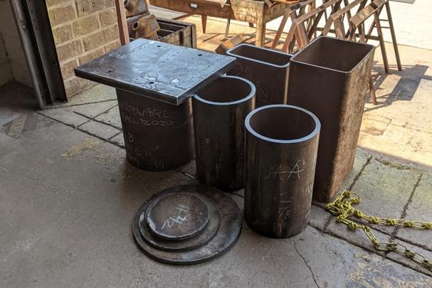

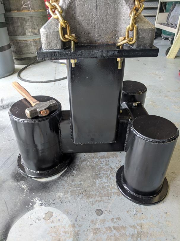

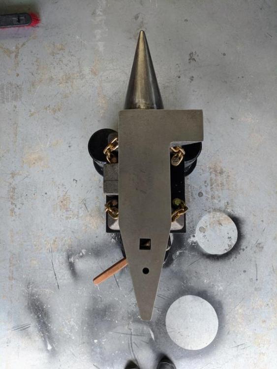

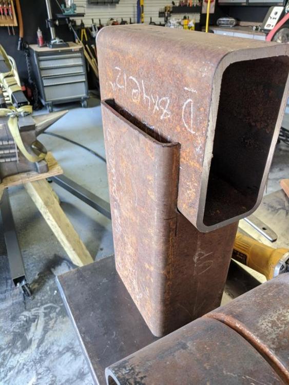

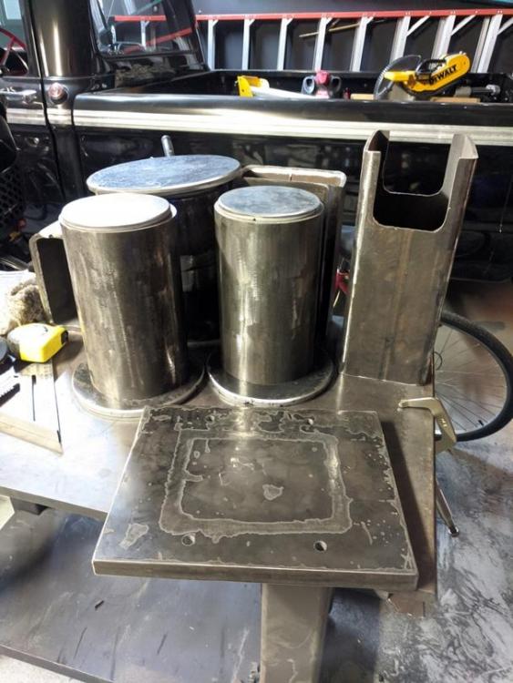

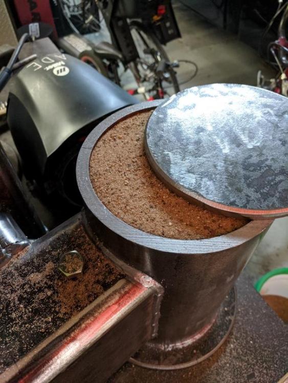

I wanted to share a grateful update on what I finally ended up fabricating and how it went. The final design took on somewhat of a hybrid of the 3-footed tripod and the T-stand, but I can't take credit for this design, it was a shameless rip-off from examples at the school. Previously this design was not possible as I only had access to 4" tube, so I owe an immense thank you to Haley at the ACC shop for allowing me access to some hefty scrap material. Ended up with 1" base plate, 6"/8" round tubes for legs, 8"x6"/8"x4" square tube for supports, and 1/2" plate for the feet. After having so much larger stock available the design could change. It all started comically as this chalk board insanity (feel free to laugh, it's absurd): After getting the material home it was a lot of cutting and grinding to get the pieces to fit. Finally they were ready for dry-fitting and all cavities were filled with sand to add an extra 150# in weight. Designing and cutting took a few weeks, welding less than a day... Caulk laid down on base and 3/8" chain with 1/2" hex bolts used to pinch down: With a coat of black engine enamel I had laying around the stand is finally finished and a happy anvil is ready to roar to life in it's new home: The design maintains the benefit of a triangulated 3-feet footprint which keeps it ultra stable and the extra width of the feet really add an extra dimension of stability. Maybe my next stand will be a tri-pod to compare. Designed the face height to be 34". Had a huge goof up in fabrication and ended up at 34-1/32"...oops. Anvil weight is 267#. Stand ~300#. I didn't put much thought into the finished look (as in I got lazy and just wanted to get it operational), I just used the black paint I had on hand. I wasn't sure how I felt about the zinc plated "gold" chain, but I ended up liking how the gold and silver of the anvil play together, kinda pops and makes me imagine dwarves mining and forging precious metals deep below some mountain somewhere. It makes me laugh because it also reminds me of Mr. T, so maybe I just found it's new name. It sure doesn't have that rustic antique historic look, but I think it will get the job done. Thanks for the earlier input, the best take aways: go big and don't worry so much about the angles. -

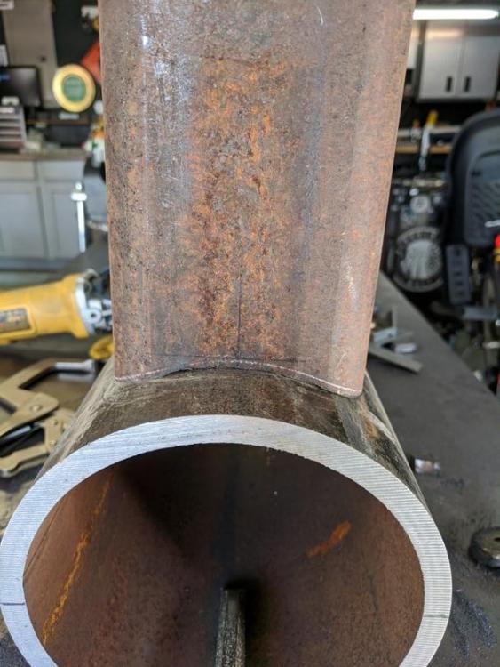

TP: the anvil is 267#. Face height is 35-1/2". I agree with all comments on why the T-stand needs to disappear. Frosty: thank you for the wise hardy hole suggestion. Back to my original post, what angle is appropriate for the tripod legs? My thought that led me to 11/15 degrees was simply to put the feet at a position outside the main body of the anvil. Is common sense the only math necessary here? Has anyone used an angle on a tripod that didn't work? -

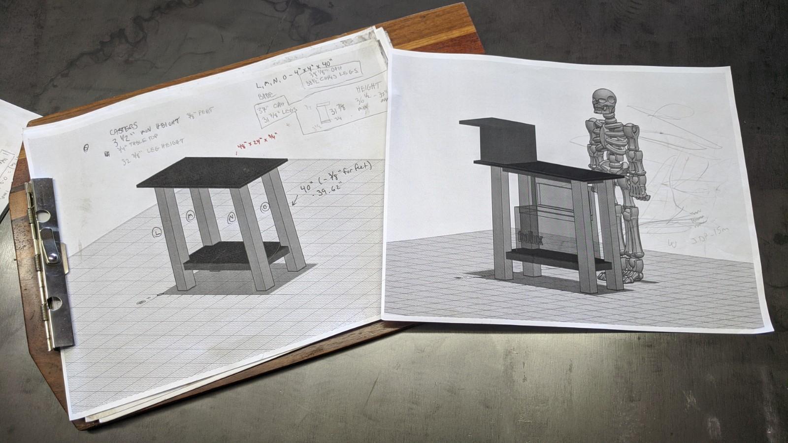

I could use some thoughts/advice/experience surrounding the suggested angle on legs placed on a 3-legged metal anvil stand. I like to get my thoughts and measurements down in a simple CAD drawing before fab so attached are a number of photos to get my point across. I am questioning the benefit of a 3-legged metal stand vs. a simple T-shaped stand (see photo). In my mind the simple T-stand is easier in the design, cutting and fabrication and offers less obstruction. Regardless of the type, the question of leg placement becomes important. I included top-down photos of each proposed stand to get an idea of where the legs rest in relation to the anvil. On a tri-pod, what is an acceptable angle for the legs to ensure stability? Here I have mocked up 3 examples showing different angles (from vertical) on the legs, using 11 degrees, 15 degrees, or a combination of 11/15. The single top-down photo of the tri-pod is of the 11/15 combo. Discovering this "best" angle led me to wondering why not go with a simple T-stand? Though again, the placement of the feet becomes a concern so as to prevent tipping and the T-stand raises concerns about stress fractures given a single 4" tube as the connection point (here I am assuming A36 4"x3/8" round tube and 4"x3/8" sq. tube). I would enjoy hearing what others have to say on the matter of leg placement, degrees from vertical, clearance issues, structural integrity, and the like. Cheers!

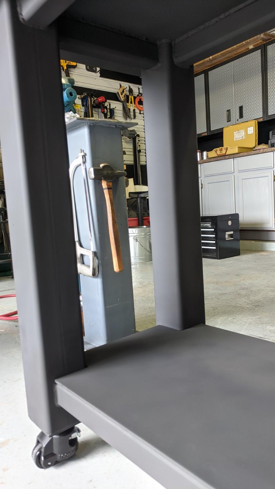

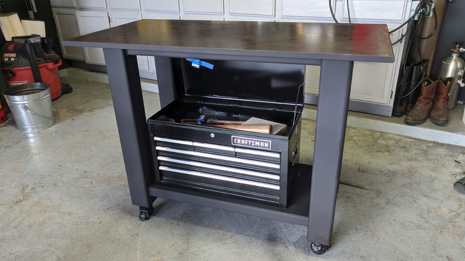

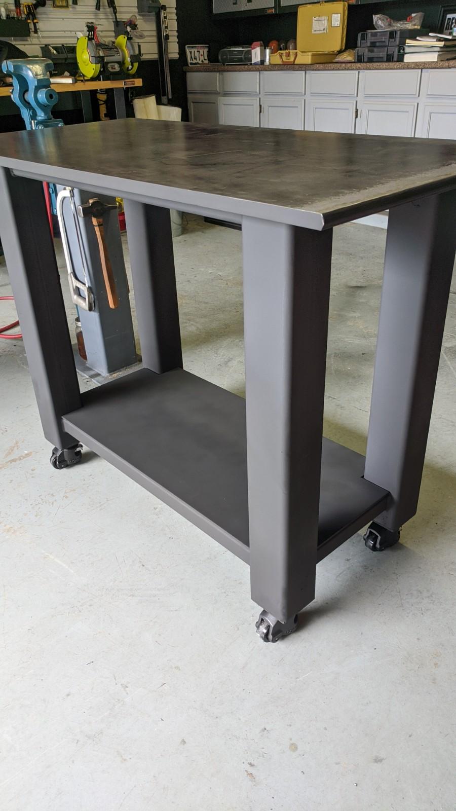

Thanks again for pointing me to paint and reminding me of KISS. I went with flat black enamel for the underbelly but left the top alone aside from cleaning the mill scale. For fun, here are photos of the finished table. Weighing in at 650#, 37" OAH, 24"x48"x3/4" top, 1/4" plate shelf, 4" sq.tube for legs (sand filled) and 2" sq.tube for support. If anyone is interested in WIP photos or the CAD plans for the table I would be happy to share. The tools that built it now have a new home. Cheers!
Thank you for your time Jonny and Thomas. 5 minutes after I posted I thought "maybe I should just paint the bottom...". The table will remain indoors and roll on casters around the shop. The top I will occasionally tack jigs and such, and it will see hot steel off the anvil and grinding sparks. Black engine enamel paint seems like my likely route for the underside. Any advice on how to best remove the application of BLO/Turp currently protecting it? Thank you sirs.
Hi fellas, I'm looking for some advice on how to protect & finish the weldment areas on a 48"x24"x3/4" mild steel plate table. (see photos) There was quite an impressive layer of mill scale on the 3/4" plate to grind off. After MIG welding 2x2 and 4x4 square tube to the plate I now am concerned with protecting these areas from rust. I do not want the raw steel susceptible to rust while I figure out a solution so for now I have coated with a blend of 50/50 BLO/Turp. I am not a fan of the unfinished raw look, aesthetically I would prefer to darken the grind areas, so the one time in my life someone bends down and looks under the hood they won't laugh. This being my first fabrication table build I was hoping for advice on techniques. I have access to an oxy-fuel torch for heat, but my concern with the 3/4" plate is that I will never be able to get it hot enough in a reasonable time/cost. I've read (on this forum) the idea of shoe polish. My questions would be: If I do nothing to these areas what will happen over time? Is the 50/50 BLO/Turp a "good enough" solution over time? Black shoe polish? Is there a better trick here on how to finish this bottom area of the table? It won't be seen directly so my primary concern is rust protection. Thanks and cheers.
