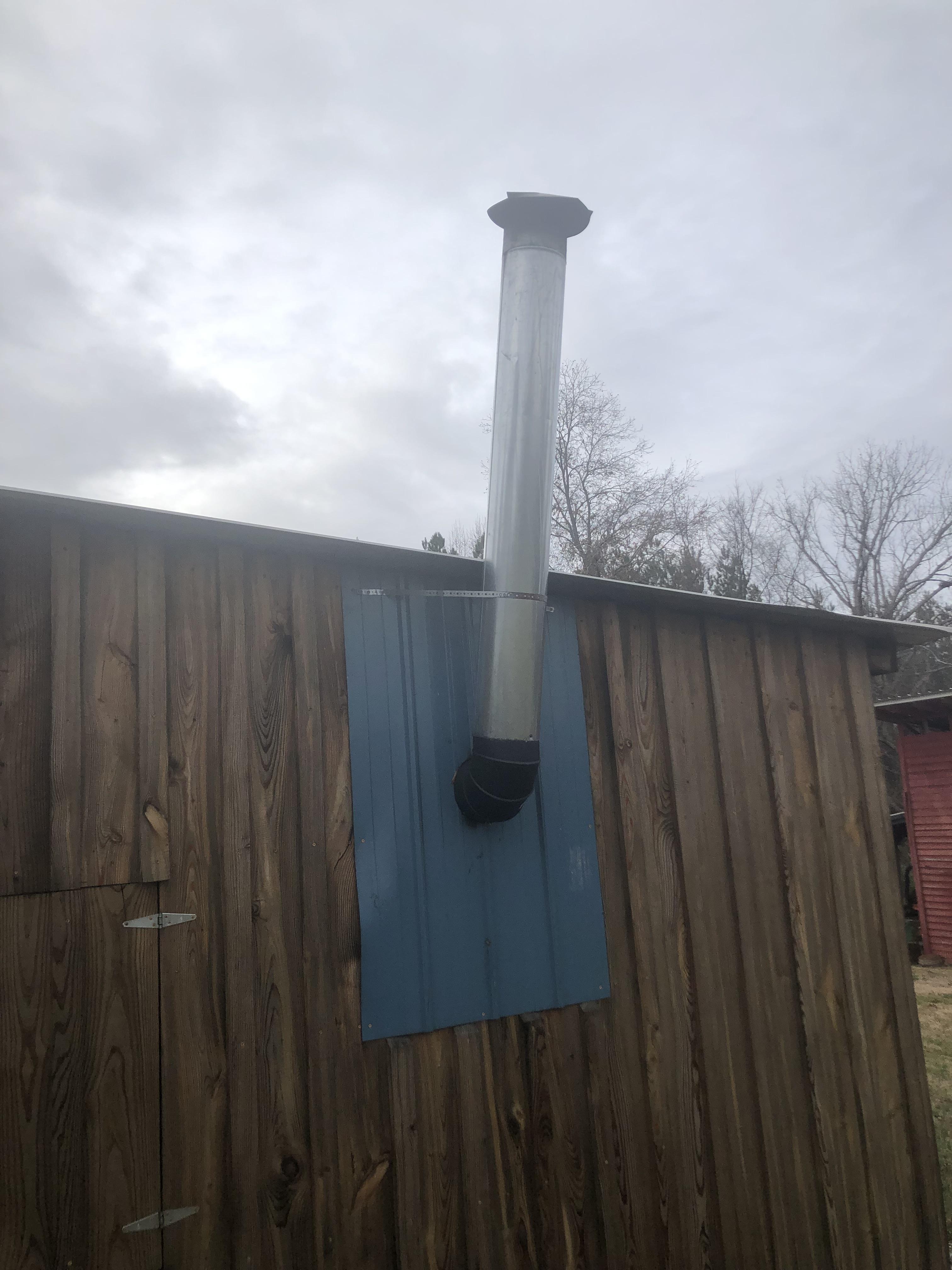

  1. I just got myself a super sucker forge hood and I’m loving it. I couldn’t find a 12” pipe but a friend of mine gave me some 13” that’s working really well. I’m concerned that the pipe might be galvanized. I’m not sure how to tell if it is for sure. If it is in fact galvanized will that be a problem? I know galvanized releases toxic fumes if it gets hot enough but will the chimney reach that high of a temperature? I don’t want to be breathing in toxic fumes. I’d like to know what folks think about this. Thanks in advance

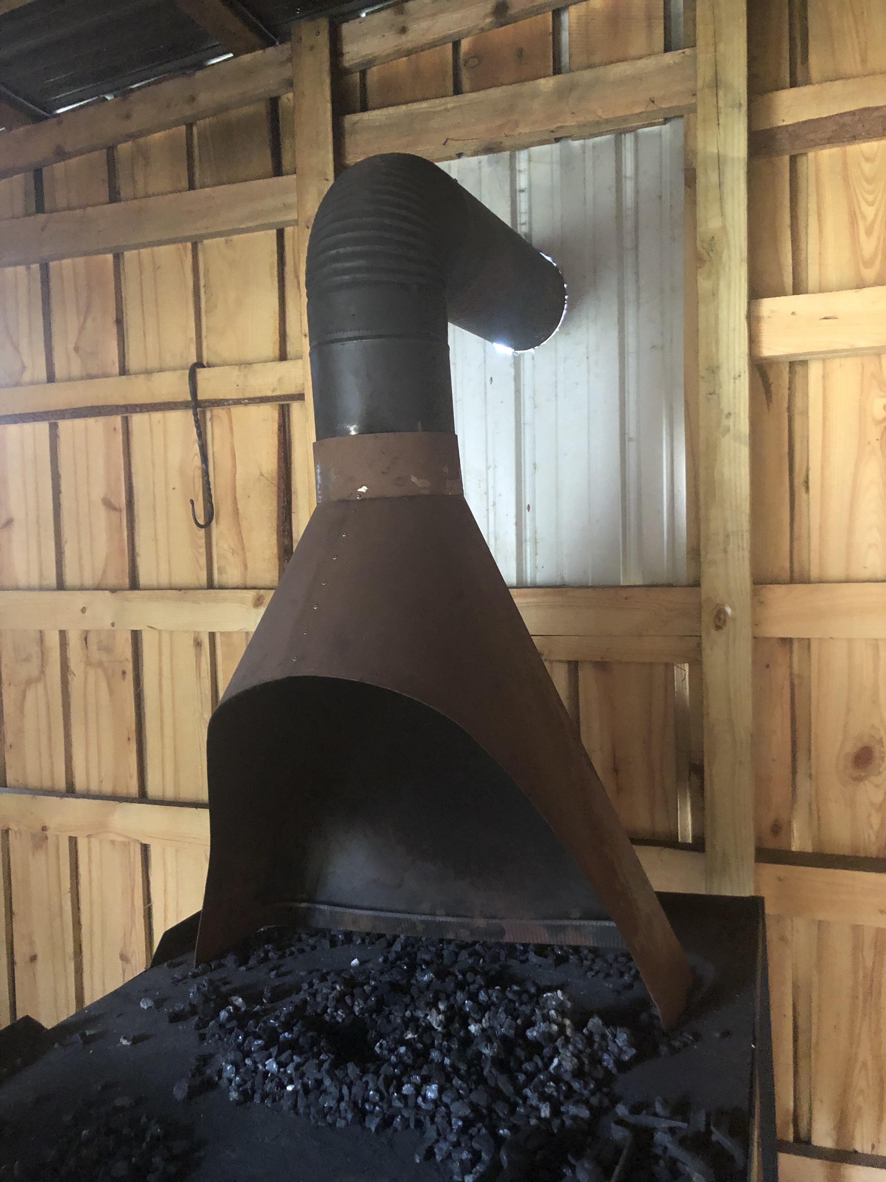

  3. I hadn’t even thought about the cap being part of the problem. It definitely could be part of it. I’m going to look into the super sucker design. I had heard of it before but didn’t really know what it was. I am also definitely going to get a 10” or 12” pipe.
  4. Sorry I forgot to add photos. Here are a few. My shop is very open and has lots of airflow so I don’t think that’s the problem. Thank you everyone for all the input so far!
  5. For a while I’ve had a smoke problem in my shop. My shop is too smokey almost all the time. I have a large Centaur Forge hood and an 8” stove pipe. My chimney doesn’t go straight up through the roof as I’ve seen a lot of blacksmith shops do. It goes through the side of my shop then straight up. I really am not sure what to change to make my chimney draw better. It’s like it just can’t draw all the smoke, only some of it. That makes me wonder if I just need a larger stove pipe but I wanted to ask opinions before I just start trying everything. Hope someone has some suggestions. It is much appreciated! Thank you!! Merry Christmas
