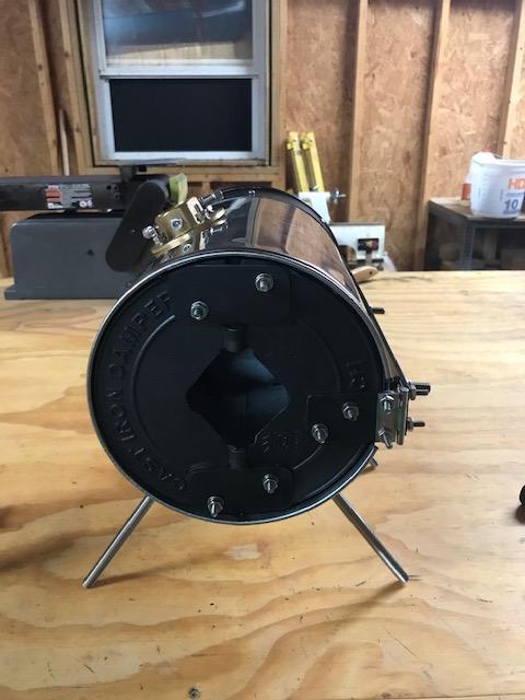

General run down:
- Small Hardware: Everything bolt/screw related is stainless. It is more expensive, but in my case, I figured that overkill might appropriately substitute for experience by ensuring that I didn’t accidently use plated-items in a high heat area and create exposure issues with toxic fumes.
- Forge Body: Selkirk Metalbestos/Metalbest double wall stove pipe. Contrary to what I first posted, I believe the piece I have is advertised as a 6”X12” section, with the first number referring to the diameter of the inner pipe. That number would only be relevant in sourcing a similar sized piece as the inner sleeve gets removed. After removing the inner sleeve I ended up with a pipe that about 9” in diameter and 10.5” long (end cap to front lip). Google and some estimating gives me something in the range of a little over 100” cu for interior volume.
You can purchase double wall stove pipe in larger dimensions and longer lengths. In my area a piece of double wall similar to mine retails around $45.00. I was lucky in the piece that I have has a significant dent on the male connector. As a result, I was able to get it for about the price of similar sized black single wall. (It helps to have a good relationship with your local Ace Hardware)
This double wall stove pipe is constructed from an inner sleeve and an outer shell that are joined using roll crimps. This makes things easy to remove the inner sleeve. That operation consists of making a circumferential cut along the female end of the outer shell, just medial of where the inner sleeve joins the outer body. (In making this cut you will catch and spray rockwool bits everywhere, so care and a respirator are required). After doing this, the inner sleeve and insulation slide out with a bit of assistance. At that point you are left with a shell that has a stainless lip on one side. The lip end seems to be a natural place for the door and exhaust port
- Forge End Cap: Interestingly, you can buy 8” nominal dia. stove end caps. They are in actuality maybe 1/16” or 1/8” smaller in diameter than the forge body. These caps are also held together at their butt end with roll crimps and then two rivets on their columnar aspect. If you carefully grind away the interior aspect of the outermost rivet, you can just get the cap to slide over the outside of the forge body. Unfortunately, roll crimps are not the strongest, so if you aren’t careful you can do what I did and pop the butt plate of the cap off in the process of sliding the cap over the stove pipe.
To help rectify this, after I replaced the butt plate, I spread a very healthy bead of Rutland Hi-Temp Stove and Gasket Cement on the inside of the joint between cap’s butt plate and wall. Once that dried, I also applied a very heavy bead of the gasket cement to inner lip of the cap where I estimated that it would meet with the outside of the forge body. I then slipped the cap over the end of forge body and further secured the joint by running screws from the outside through both the cap wall and the forge body. Whether this holds up remains to be determined. Given I have read about forges that are held together with wire I do think it has a shot.
- Burner Portal: The burner portal is a 1” brass termination flange I found at Home Depot and picked up because I like shiny things and because it looked like it would serve the purpose. Fair warning it was not cheap at around $20.00. I drilled and tapped three set screws to hold the burner’s barrel. Unfortunately, I don’t remember the specifics, as I grabbed whatever was closest at hand…. but then it’s not mission critical information.
I’ll be dead honest, I ported the forge for the burner before I installed the end cap referenced above and eyeballed the burner location. As a result, it is a bit forward of where it should likely be and I am fairly certain I missed the angle for optimum circulation in the forge. The hole in the stainless body was made with a 1” knock out bit.
- Door/Exhaust Portal: The door is a cast-iron nominal 8” damper I picked up at Ace Hardware. I modified it by using an angle grinder to cut away the handle and enlarge the center opening that the handle formerly ran through; creating an exhaust port. The steel plates are present to provide a hinge mounting flange and to cover the channel that remained after removing the damper handle. The diameter of the exhaust port is somewhat arbitrary and based on the preexisting holes in the damper. Whether it is large enough, or too large remains to be seen. If necessary, I figure I can enlarge it or partially plug it, as necessary.
The door is designed so that it both swings open and can also be pulled forward of the forge body using the track mounted to the side of the forge body. With the amount of heat involved and amount of seat-of-the-pants engineering I’ve done thus far I’m not sure if there will be binding issues. As a result, I thought that if the door is able to move on two axis it might be easier to operate.  Fair warning, I have been accused of over engineering things.
- Insulation: At the moment, I am planning to use 2” of rigidized Kaowool, topped by Satanite and coated with Metrikote for the forge body. The door insulation and exhaust port are up in the air at the moment. Forward of the lip on the forge body there are a series of “teeth” that are meant to dog one portion of pipe to another. These teeth cause about a ¾” gap between the door and the inner, raised lip. As a result, I have been considering a number of different solutions for sealing and insulating the door.
It could be as simple as putting stove gasket around the inside lip of the forge and attaching to the door a cored plug of 2” Kaowool cut to fit both the exhaust port and the interior diameter of the forge. I’ve also had thoughts about casting a plug that is attached to the door as well as casting ring along the inner lip of the forge and going from there.
As an aside, I managed to snag a section of kiln shelf off of a friend. I am hopeful to be able to section it at very least to have a strip to lay on the bottom of the forge as a floor. If there is enough room and not too much back pressure I am going to play with using a piece to act as a flame face; protecting the sidewall of the forge.
