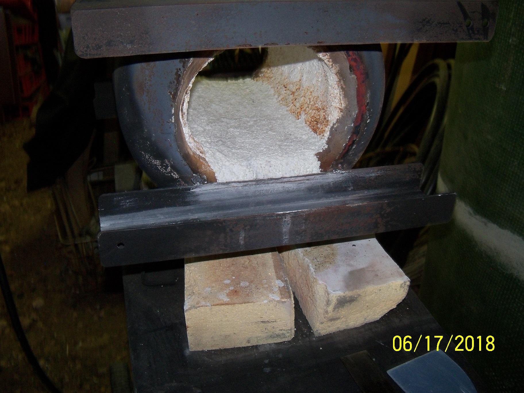

Irondragon Forge ClayWorks Posted May 24, 2020 Share Posted May 24, 2020 The bubble Alumina we used is a castable refractory coating, with Alumina spheres rated at 3000°F. It was applied over a 1/2 in layer of Satanite over 2 in of Kaowool. Link to comment Share on other sites More sharing options...

Irondragon Forge ClayWorks Posted May 30, 2020 Share Posted May 30, 2020 This is what we ordered, took a 5 pound bag to give 3/8 inch all around and a flat floor in the 20 pound propane forge. "Bubble Alumina Refractory Coating: Highly flux resistant! This material works really well for coating an Inswool lined forge for protection against flux when forge welding. This is one of the most flux resistant coatings we have found to date! - 3300 degree temperature rating - 2.5 # bag is enough to do the floor in a 12" vertical forge (3/8" recommended thickness) 84# per cubic foot (1728 cubic inches) 2.5 pound bag - $17.00 5 pound bag - $32.00 20 pound bag - $120.00" Link to comment Share on other sites More sharing options...

Irondragon Forge ClayWorks Posted June 1, 2020 Share Posted June 1, 2020 When we mixed it according to directions, it was the consistency of a castable, not thin like a wash and it hardened like concrete. Don't know if you remember this ( or maybe I never posted it) when I added the balance of the 5 lb sack to make a flat floor. It's about 3/4 inch thick in the center. Link to comment Share on other sites More sharing options...
