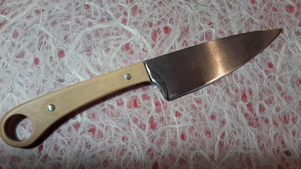

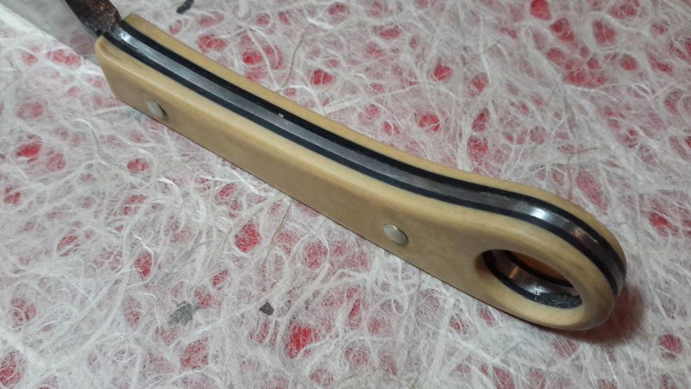

Here is a nice little paring knife that was inspired by an old knife my folks used to have in their kitchen drawer that I admired:

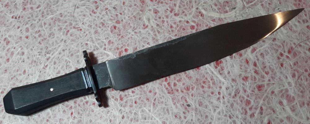

How about a big bowie with hot blued, chased and filed mild steel fittings (~13" blade)

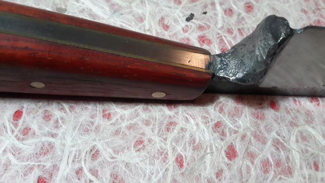

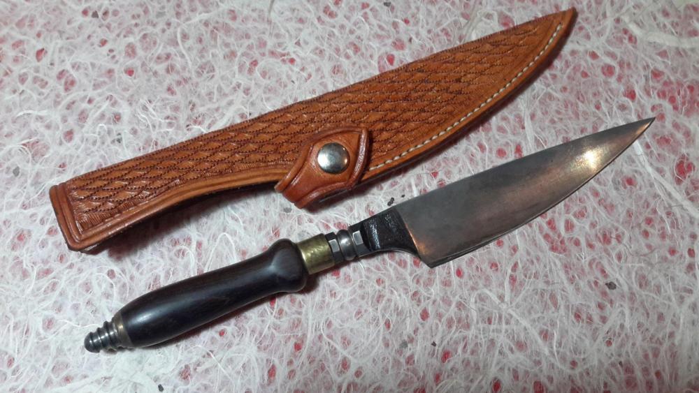

Here is one with an integral bolster and thru tang loosely inspired by period side knives, with hand tooled sheath and forced patina:

All of your knives are outstanding. Love the paring knife, reminds me somewhat of a Karambit (although not curved. I have a Saex that I started with the ring for a pommel, I really need to finish it and my wife has a Karambit she needs to finish also.

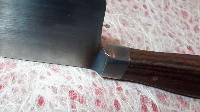

Chef's Knife with integral bolster:

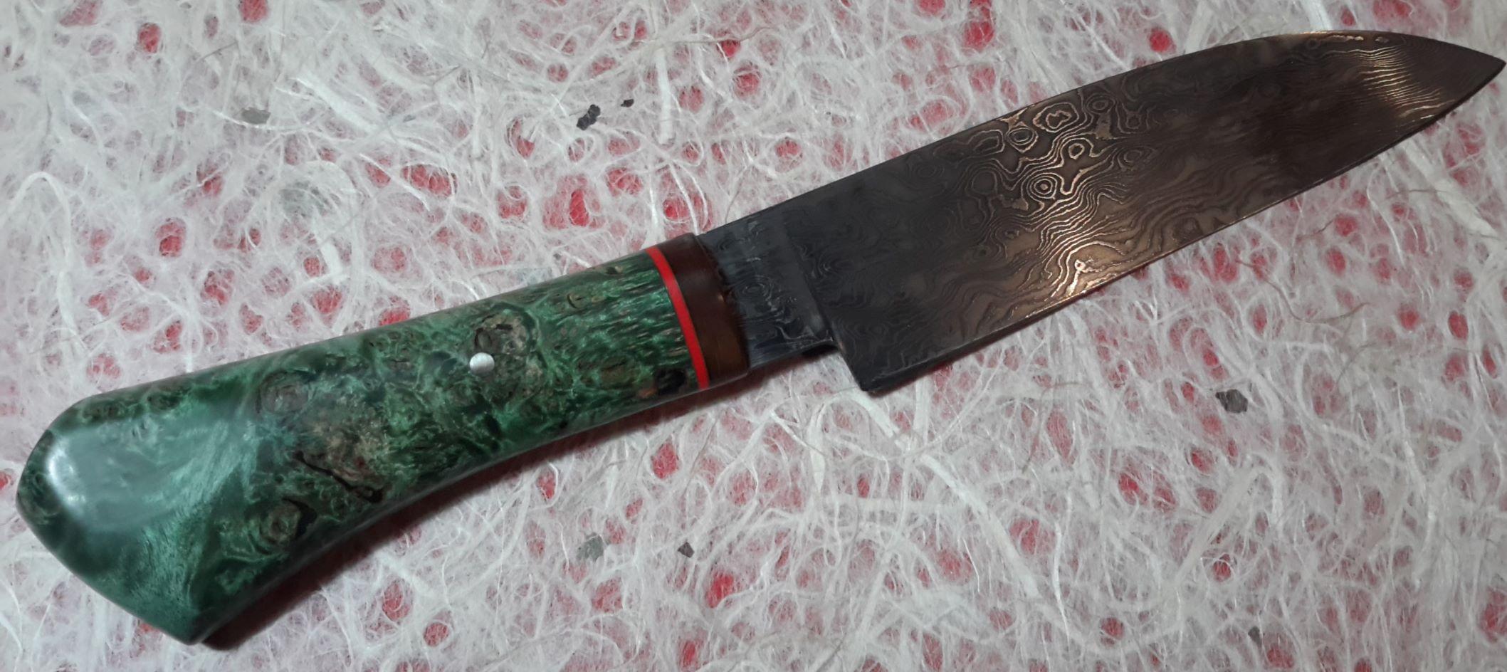

Will end with a Raindrop Damascus EDC with stabilized burl handle.  My first try at pattern welding in my home forge.
Needless to say I'm still struggling with fit and finish.  Having fun on the journey though.

Nice eye candy there Latticino, thanks for the view. I think my favorite is the paring knife, I just like the shape and size best.
Thanks Frosty.  That one is one of my favorites also, so much so that I forged another to see if I could up the finish quality.  The last one I certainly cut corners with a machine finish, this one will hopefully be hand sanded.  I really love the ancient ivory look of the linen micarta.  I'm also going to get rid of the integral guard on this second one.  Thought it was a good idea at first, but after execution, just found it distracting.

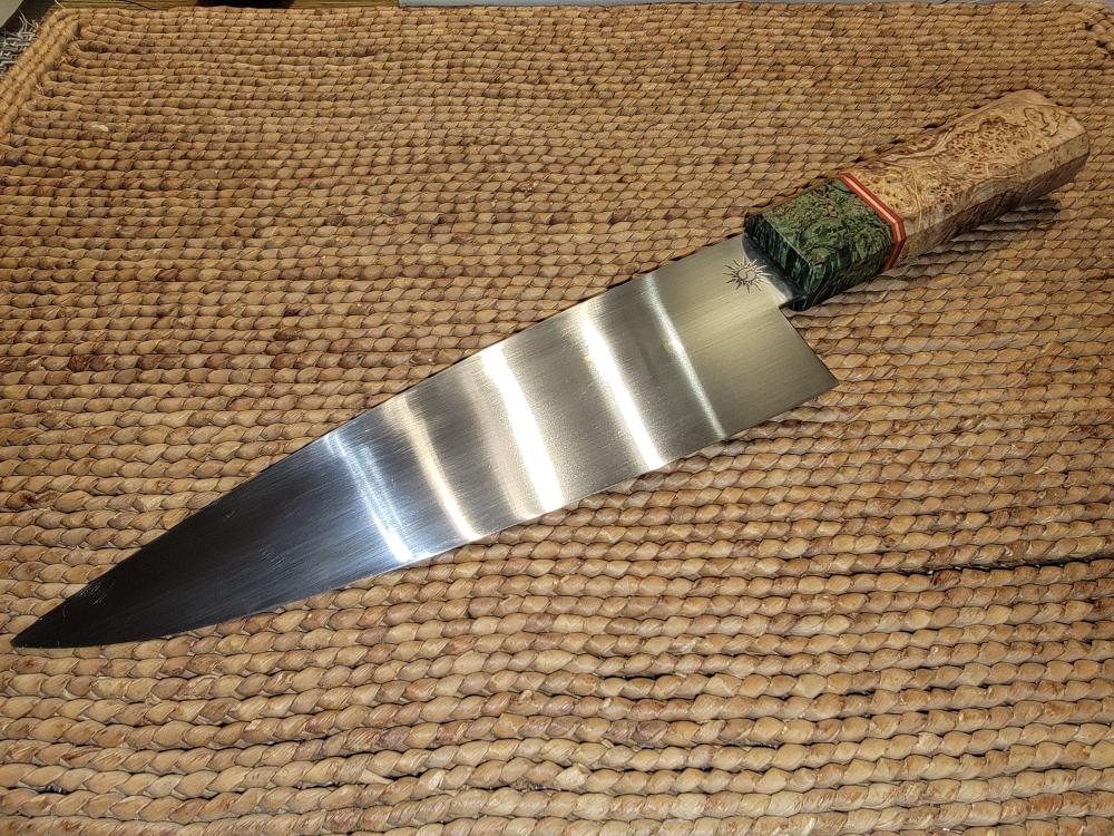

First try at a wa style handle.  I know this is a bit of a mixed bag, with a Japanese style handle on a European chef's knife, but I wanted to try this kind of handle, and didn't have time to forge and finish a new blade before the deadline (wedding gift).  I think it is a bit blocky, though it does fit my large hands quite well.  Next one will have different proportions I think.  Blade was forged from 1 1/2" x 1/4" 1084 and is now under 1/8" thick, 2 1/2" wide and 9" long.  I also tried the "no-plunge" grind blending for the first time as well.  It is a lot harder than it looks.
Wow, that's beautiful. I love the handle.
Thanks for the feedback everyone.  I went with a "complicated" handle with high end materials to try to balance the simplicity of the blade.
Nice knife, beautiful wedding gift, they'll love it.
