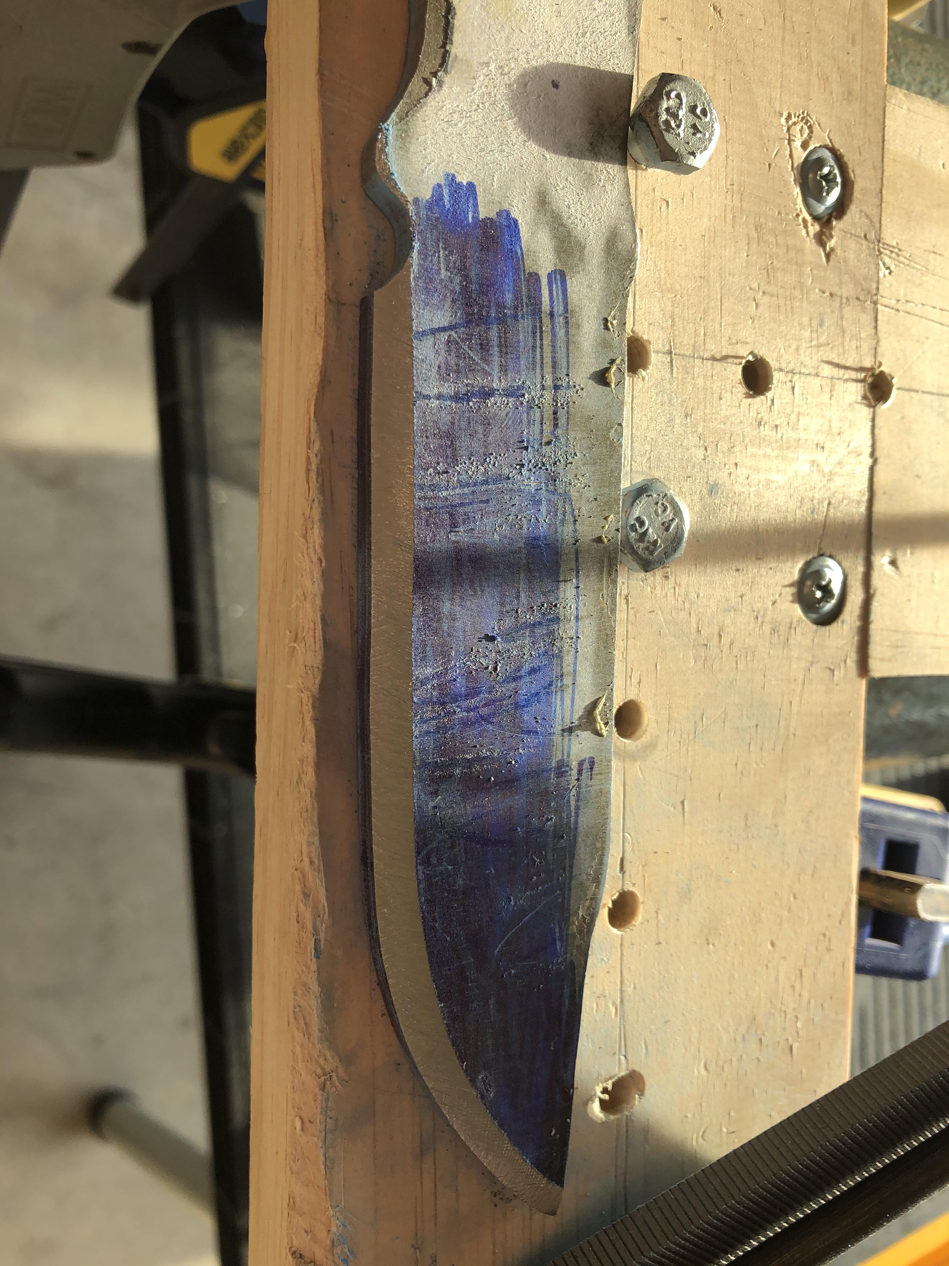

Today I finished my filing jig and started the bevel on one side. I would’ve kept working, but my parents said I had to go eat lol. What do y’all think? Also, I remember that I am supposed to have round, not square, plunge lines. But I’m not sure how to do that? Thank y’all for all the help! Also, I still need to get the blower for my forge, so once I get the gross grinding on my bevels done, I probably can’t do more work besides drilling the pin holes until this weekend. Thanks for any critique or suggestions!
Clarification: I have not finished this side’s bevel, I’m about half as far as I would like to be, and am cutting this down to the width of a dime until the heat treat
For the blades I do; I would like to see a much longer bevel as I make knives for slicing and not for crowbar/axe use.  What is the intended use for this blade?
I would also do most of it drawfiling as it's much easier and faster and only use a filing jig to clean it up right before heat treat.
You have done an amazing clean job of filing and I expect that doing the same job with a longer bevel will be amazing too.
I am going to be using it as a hunting and general camp knife. I still am going to extend the bevel to about 2-2.5x what it is now. It will still be pretty steep angle, as I am working with some pretty beefy stock (1/4 in- I got it for christmas, and my parents weren't quite sure what to buy lol).
