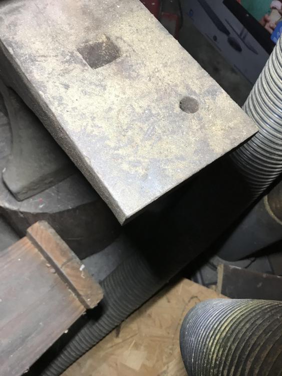

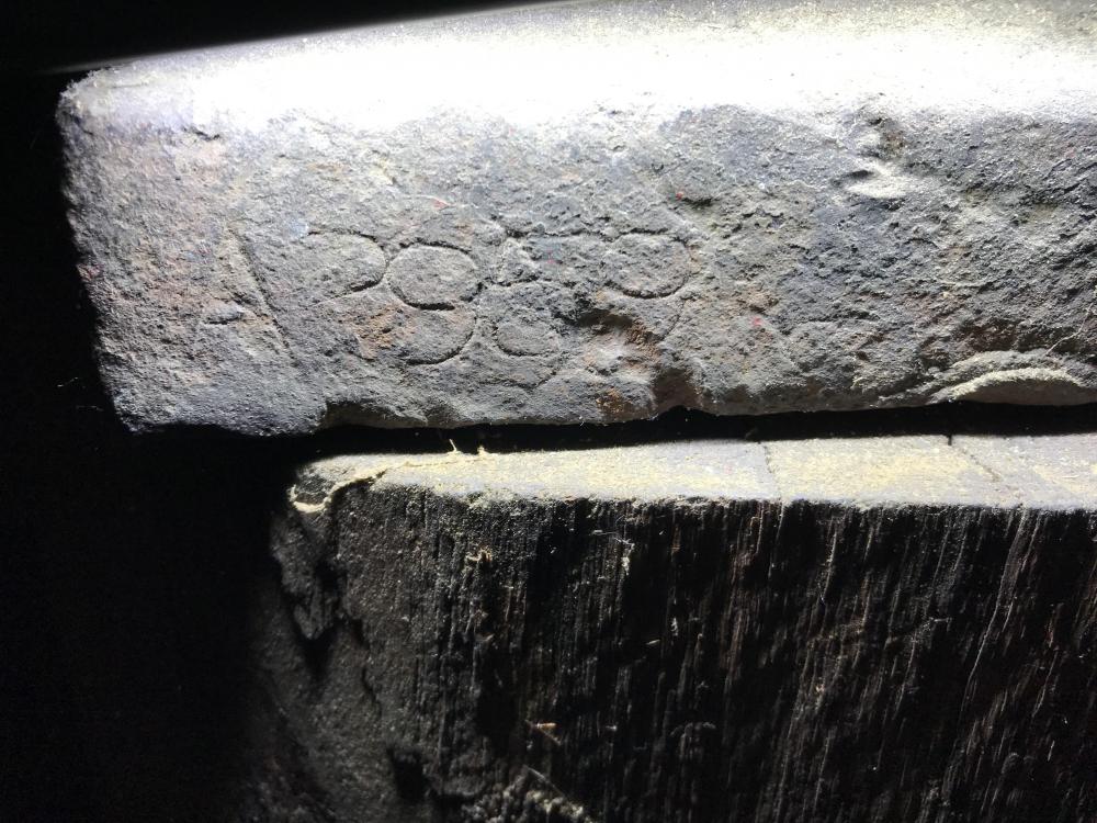

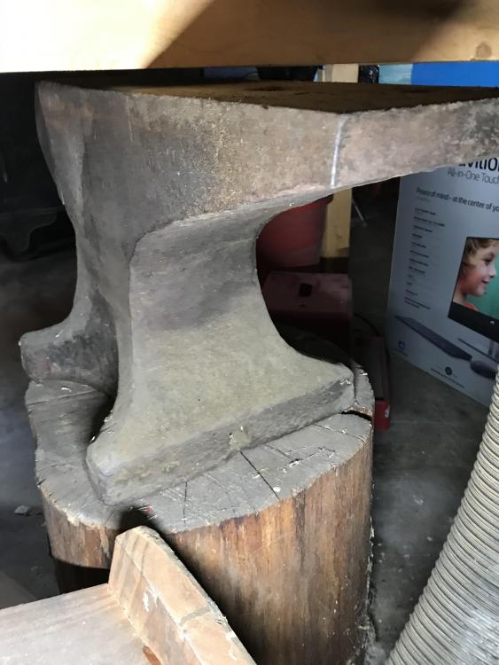

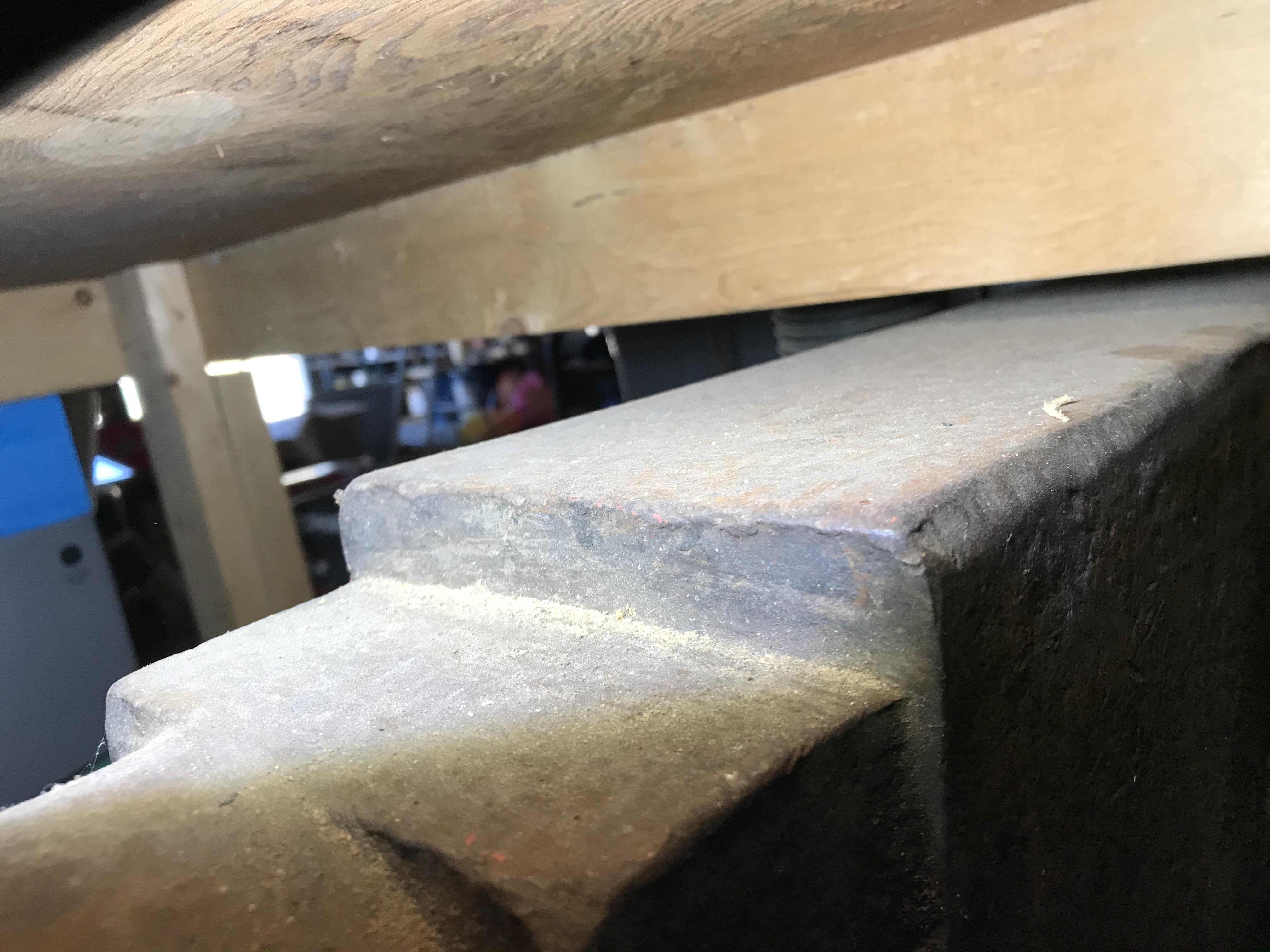

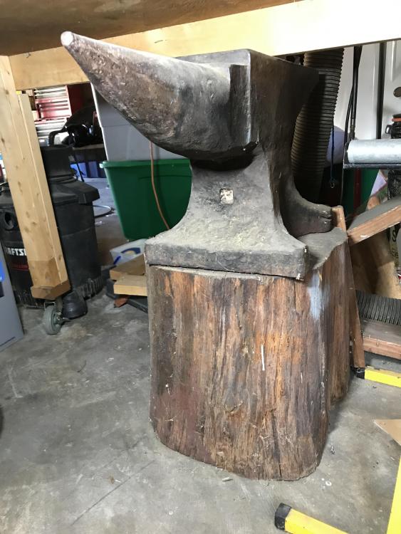

I have known about this anvil for a few years now. My friend retrieved from the repair shop at the Citadel College. My friend, who at the time delivered freight to the college inquired about it. He said it was sitting over along a wall, and not being used. They were going to toss it out, and he inquired about it. They just ended up giving it to him, he and a couple friends loaded it in about 1975.
I believe it is a hay budden, and cannot see that info on the side. I do see some numbers on the front left foot. It weighs in at 400lbs, face is 22 x 5.75, 34.5" overall length, and base to face is 14". It is in really good shape for it's age. My friend is getting on up in the years, and he knows how fond of it I am.  He has never used it in 40+ years.
Any info you folks can shed on this anvil would be great.
I had to crawl around on the floor to get pics of it, as it resides under a table. He said we can get it out for a better look soon.
Yes, that's a Hay Budden, and in remarkable condition. Looks like the solid-steel upper half type as well. I can't read the serial number, but if you can I'm sure someone with a copy of AIA would figure out the year of manufacture. Really incredible anvil.

that is a 3rd generation Hay Budden. Serial Number starting with A were 3rd gen..   HB,. had 4 generation types.   1st gen, tradtional wrougnt iron with face plate,   2nd, was 2 piece anvil  welded at the waist, with Rhino horn with higher top face,  3rd was Rhino horn with lower face height welded at the waist and 4th gen was solid steel (rare).
its funny but without a reference it looks like a 100lbs..   hay Budden anvils are my favorite.
Yes, that seems to be the case..    During the 3rd generation Hay Budden had some labor disputes and some other funkiness within the company and when they came back on the scene the table to face height was different.
I often wonder what happned that Hay Budden changed directions from Gen 1 to Gen2 with the rhino horn and thinner waist..  I know they used continuous forge welding on the 2 piece bases on Gen 2 and 3..  you can see where the rods were placed and cut..  neat really.
